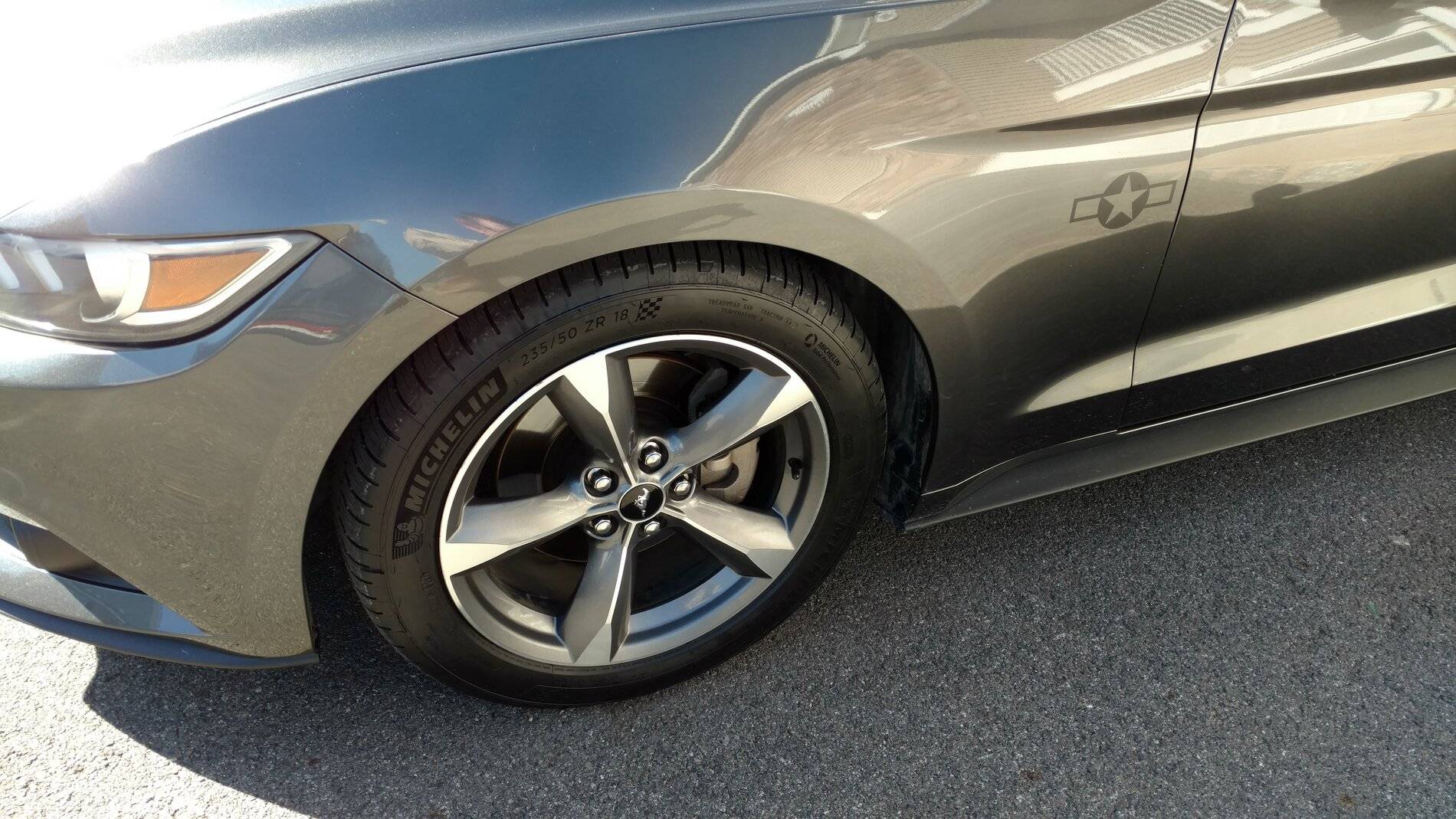

Thank s for everyone’s help here. I use daily this and other information to get tires. So I got New Tires for “Miss Maggie” Did my research, got Michelin Pilot Sport All Seasons for a great price and installed by Bj’s Tire Center. They did a great job as well. The research was correct. Very quiet tires, quieter than my Goodyear Eagle F-1’s AS that came with the car. They lasted six years so I’m not complaining. I took her on twisty roads and the car handles much better now, really corners hard when pressed without any loss of control or adhesion. On the Thruway at high speeds the car was stable and sure footed. All in all, very satisfied with the dry performance. If what my research showed about wet performance is also true, I’ll be extremely satisfied.
