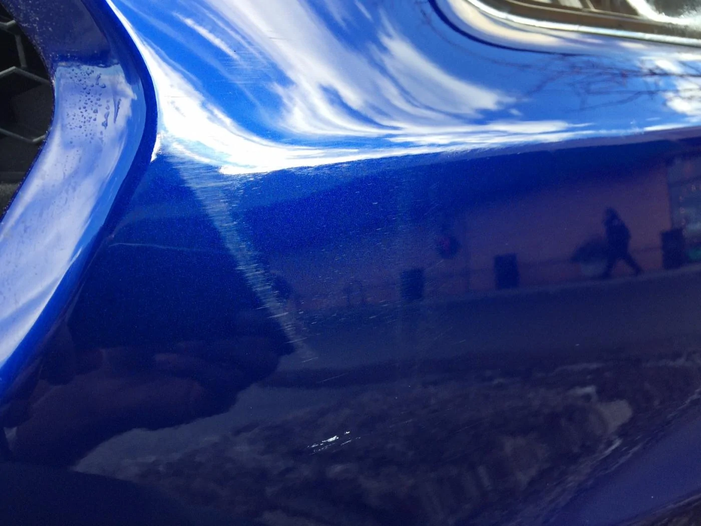

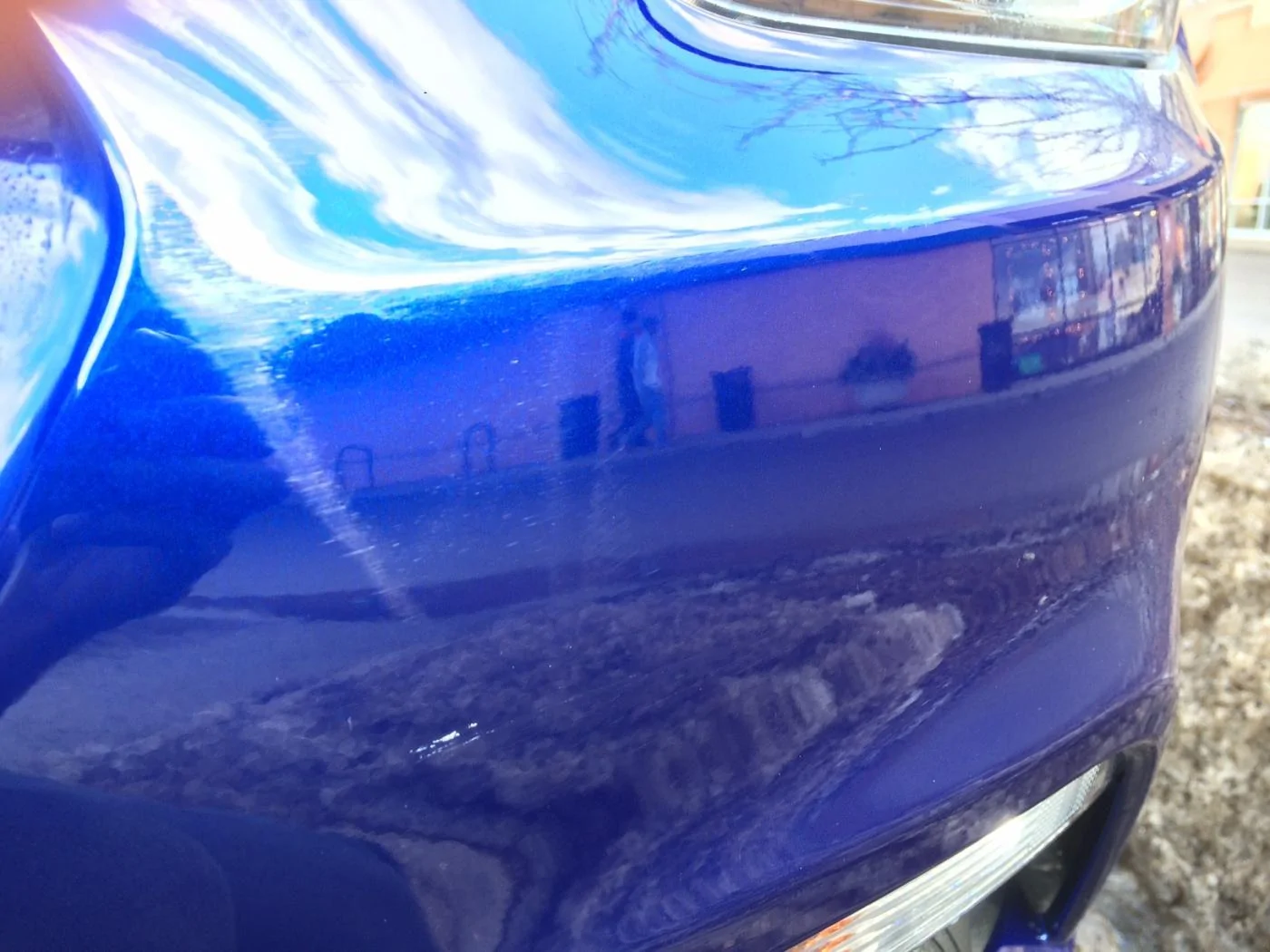

Yes I agree people are careless and have little respect for others or their property. Unfortunately, to me that looks like buffing will only remove part of the scratches. Like others have said find a pro detailer and he can tell how much of it he can get out. Sometimes you can dampen a rag with lacquer thinner and wipe away the some of the paint material that has transferred onto your car. Lacquer thinner is great at removing scuffs or even graffiti sprayed on you car etc. Some will cringe at this advise but it works and a quick wax afterwards restores the protection. The first scratch on a new car sucks big time. Good Luck
