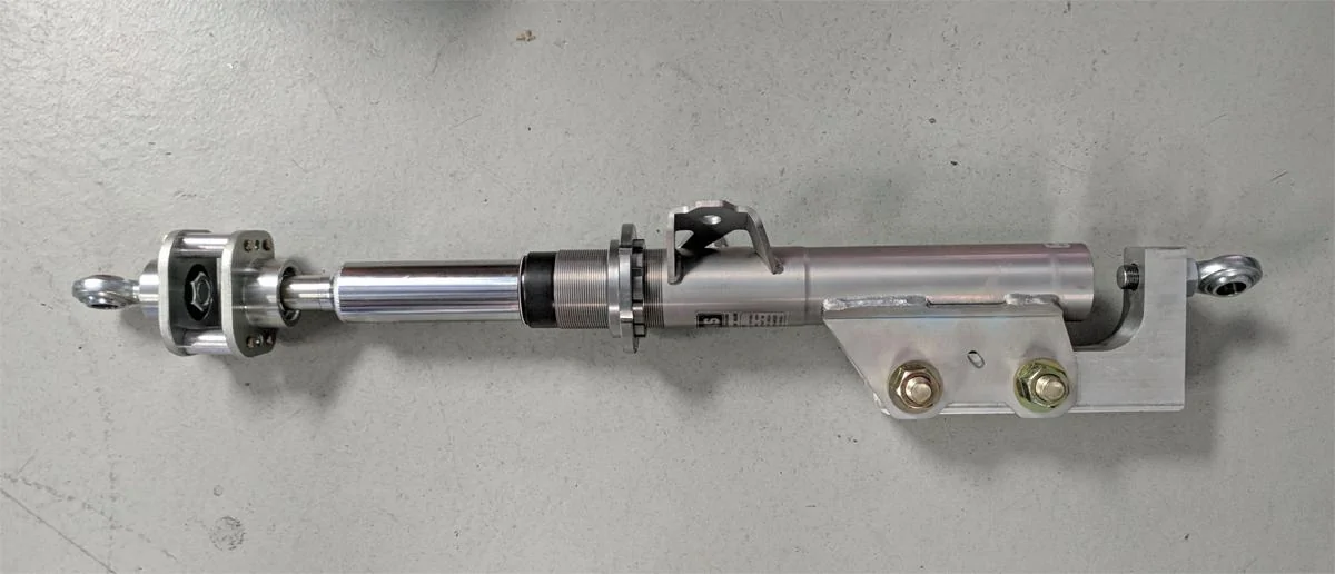

I thought there was still some issue being looked at by ohlins before they were going to release these?
@hotpart... can you please shock dynos of the front and rear so we can see exactly what is going on with these dampers?
Ohlins engineers have cleared the release on these.
We are hoping to get them on the dyno in the next 2-3 weeks. Just need to mill up a fixture for the front.

The published spring rates are still puzzling to me. Typical front spring rates for our cars seem to be between about 190 and 250 lb/in and rear rates seem to be in the 800 to 900 lb/in range. The Ă–hlins front rates are more than double What we usually see, while the rears are at the low end of the usual range. This seems like a recipe for understeer.

Spring rates are like tears in the rain... nearly infinite possibilities. What we need to know is, what range the valving is set up for.

They kinda determine the majority of the front and rear roll stiffness though...so yes I'm certain these would induce understeer. I am sure the dampers are amazing though.

Ohlins can run a higher spring rate compared to other coilover systems specifically because of the DFV system (dual flow valve). At lower speeds, oil will flow through the shaft jet bleed, while higher speeds will allow oil flow through compression ports located in the piston.
According to Christopher Loow at Ohlins: “If you drive one of our kits, you’ll feel that it’s firm and stiff like you want, but without being harsh like some kits which have too much low speed or too much mid speed damping. You can get away with much stiffer springs (on our kit) but if you put an equally stiff spring on another coilover, you’d need so much damping that it would rattle your teeth out versus with our patented DFV, you can have performance and comfort.”

Everything sounds right, 514 lbs front, and 800 lbs rear, out of the box.
Do they have camber/caster adjustment or just fixed? Can we add aftermarket camber/caster plates?
The 25MM drop is only 1" I'm good with that.
Will you guys post the max spring rated you dyno to?
