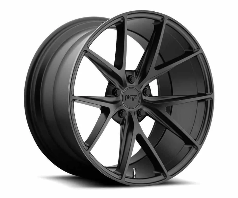

Looking for sizing opinions! I was recommended to run a 20x8.5 +25 with 20x10.5 +45 in the rear for a flush fitment. A +35 on the front would fit also.
What size wheels and tires would you get on the M117's?

It all depends on the look you are going for and your budget.
you can go conservative as 255/35/20 and 275/35/20
or 265/35/20 and 315/35/20
and tons of brands and price ranges.

The Niche Misano M117 comes in the following fitments
20x9 Et 25 or Et 35
20x10 ET 40
20x10.5 ET 30
For the S550 platform I recommend the following
Front: 20x9 ET 25 or 35 depending on how flush you want it to the fender
Rear: 20x10 ET 40
as for tire sizing you can do a few options
255/35/20 & 275/35/20
255/35/20 & 285/35/20
255/35/20 & 295/35/20
265/35/20 & 315/35/20
275/35/20 & 315/35/20
285/35/20 & 305/35/20
