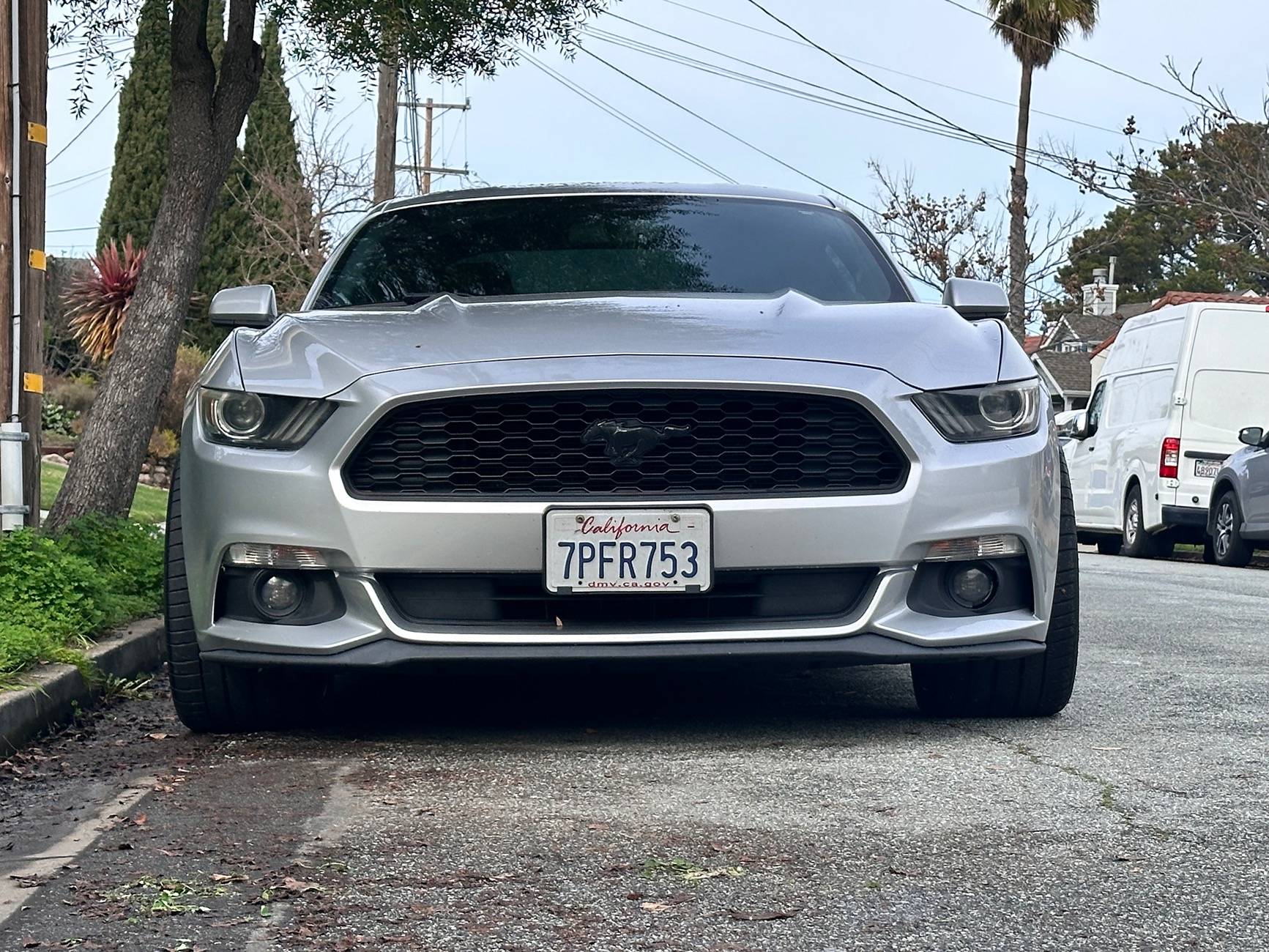

New wheels and tires poke out, ideally wanna keep the setup as they handle insanely better than my previous setup.

305/30/19 front and 315/30/19. they don’t rub and the black is flush. Only thing that bothers me a bit is the front sticks out a tad, looks like a drift setup. It’s not that bad and I can live with it but are there any fender liner lips that are subtle or body mods that don’t look abnormal that I can put on?

To solve, add more camber. I run a 19x11 w/305 square with -3° camber and I'm flush.
Just to be clear, you bought 12" wide for the front? What is your offset?
Also, can you snap a pic from direct front and direct top?

Yeah that's not too bad. Camber will fix that but you may need a camber kit to get that much adjustability.

Yes, the fender lips will help to disguise that poke.
if you do lower the car I would recommend camber plates.
