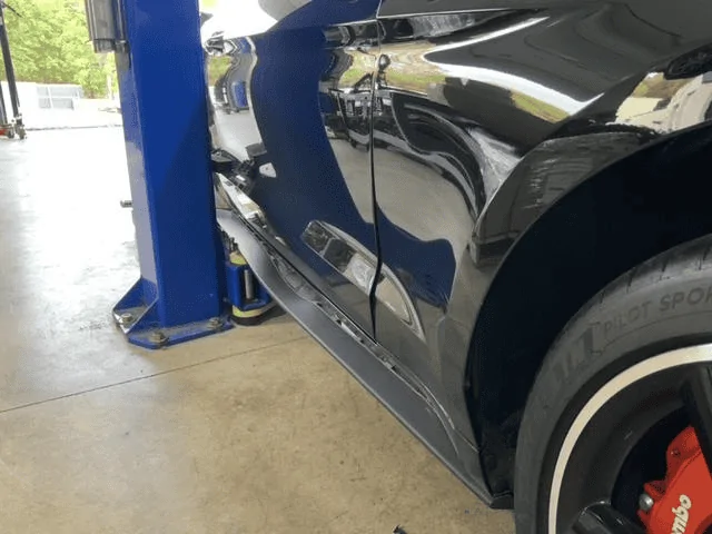

Got an update to share, had the car towed to the shop on a flatbed. Tow Truck driver unloads it without first checking if the car was in gear or emergency brake on, and well she rolled into the shop and slammed into the lift.
The car appears to have only cosmetic damage, but I won't know until further inspection.
ADDING INSULT TO INJURY - 2020 is out for blood I'm telling you! :facepalm:
