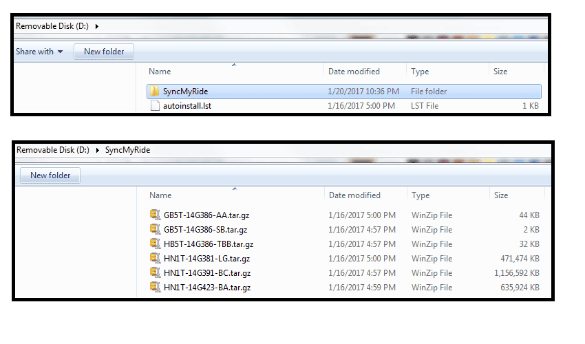

1) Got the HU5Z-19A387-A
2) Installed it
3) Got FAT32 formatted USB 8GB
4) Installed 1st file (autoinstall + syncmyride on USB) from Mirror Link
5) Removed everything from other USB port
6) Started car.
7) After 1 minute plugged in USB.
8) Says "downloading software". Yeay!
9) Then the wait. 10 minutes, 20 minutes, 30 minutes....40 minutes....WTF.....finally, 50 (fifty!) minutes later it is still 'downloading' -- too afraid to pull USB.
10) Gain balls. Turn off car, pull USB go in house
11) Delete USB
12) Format USB with FAT32 again
13) Download file from Ford link (not mirror link this time)
14) Unzip file and place on USB as shown below
15) Installing for 40 minutes. Nothing.
16) Go on PC and type this
Help appreciated. Am I not unzipping these files far enough or could this be my cheap $15 USB thumb drive?
