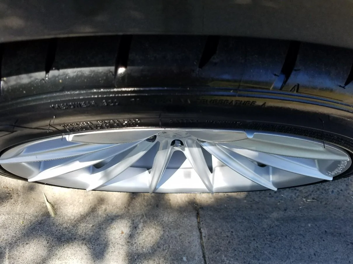

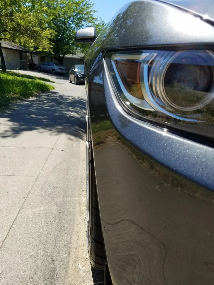

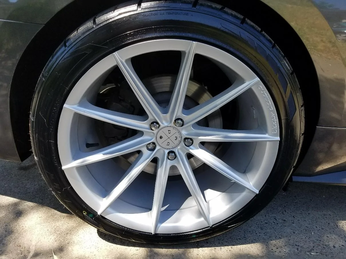

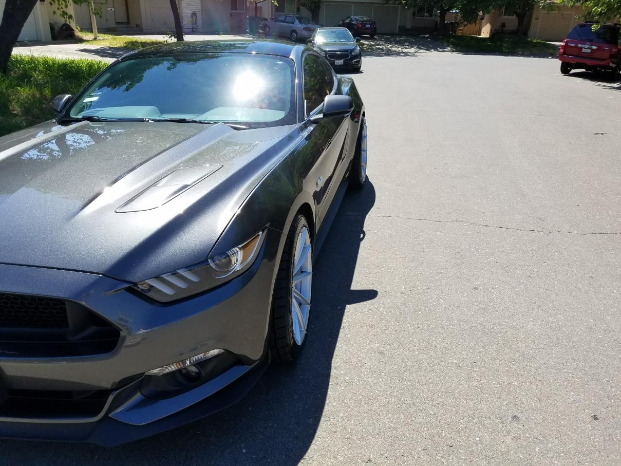

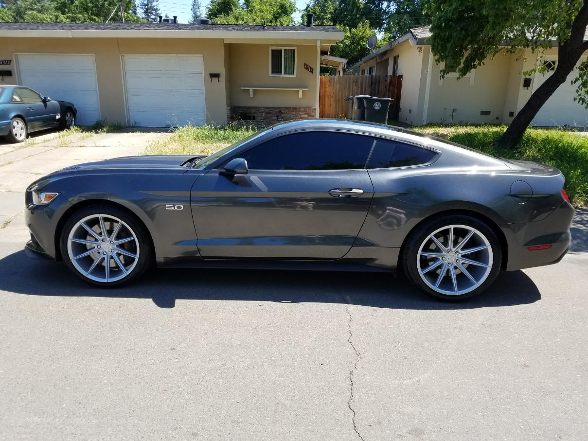

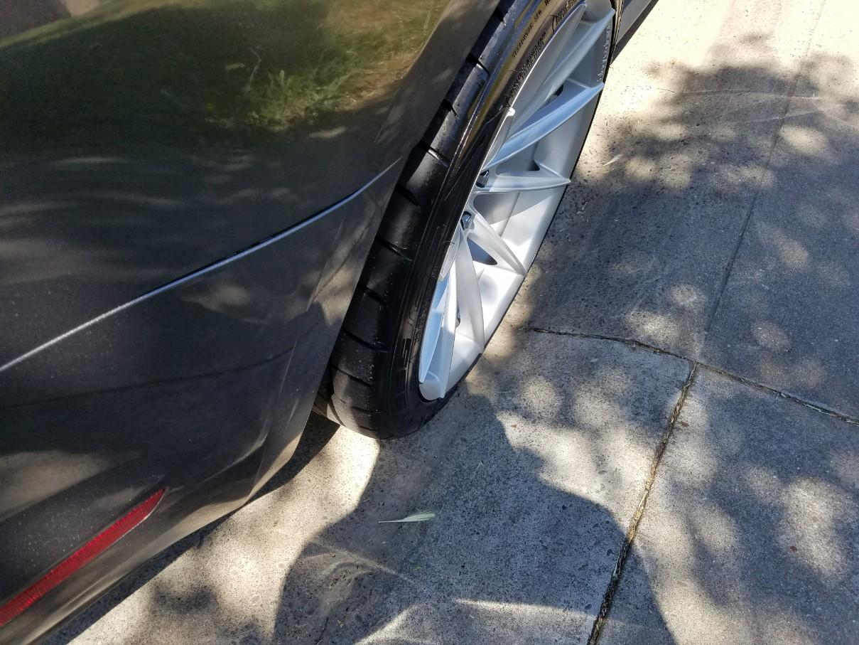

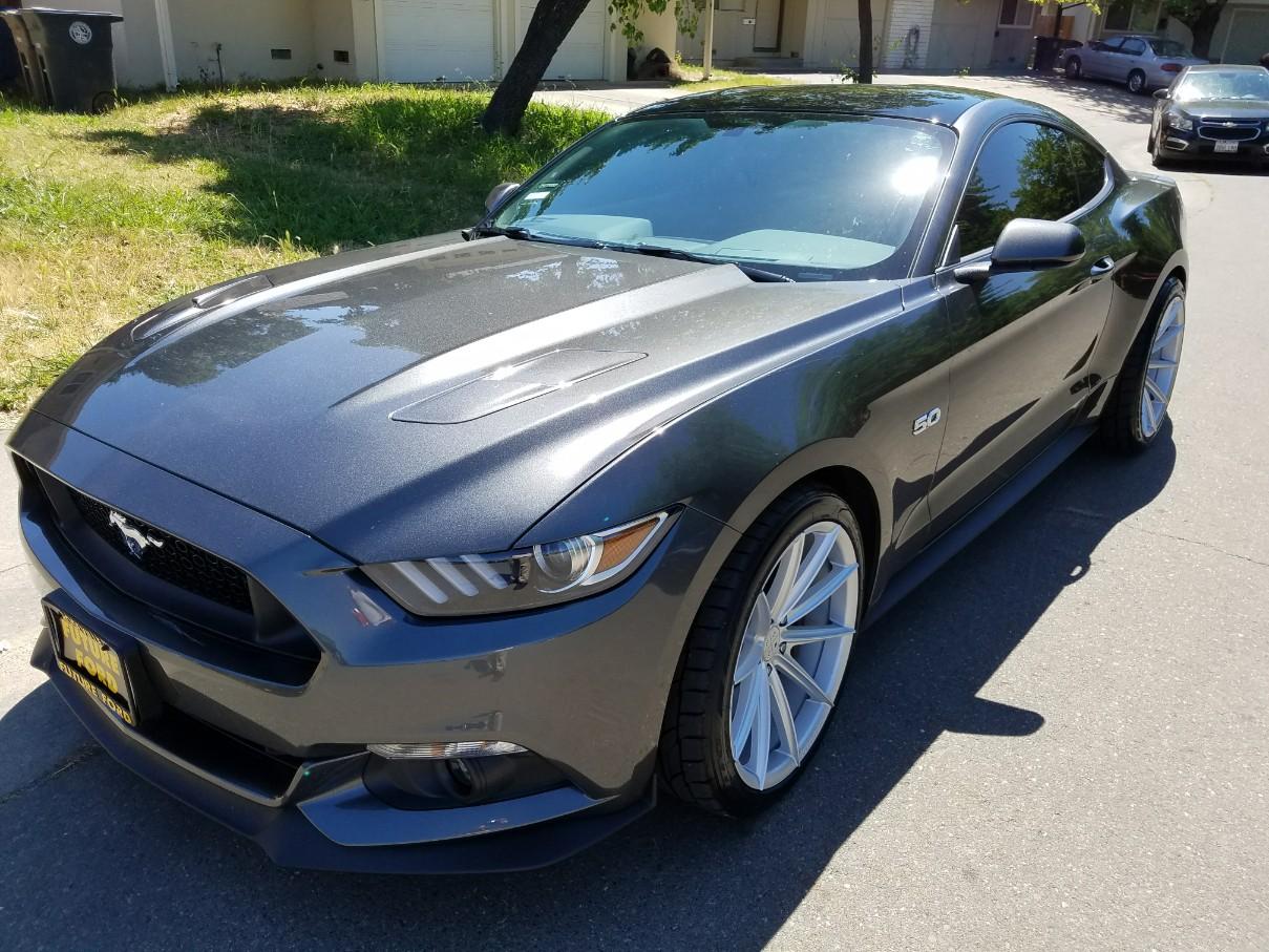

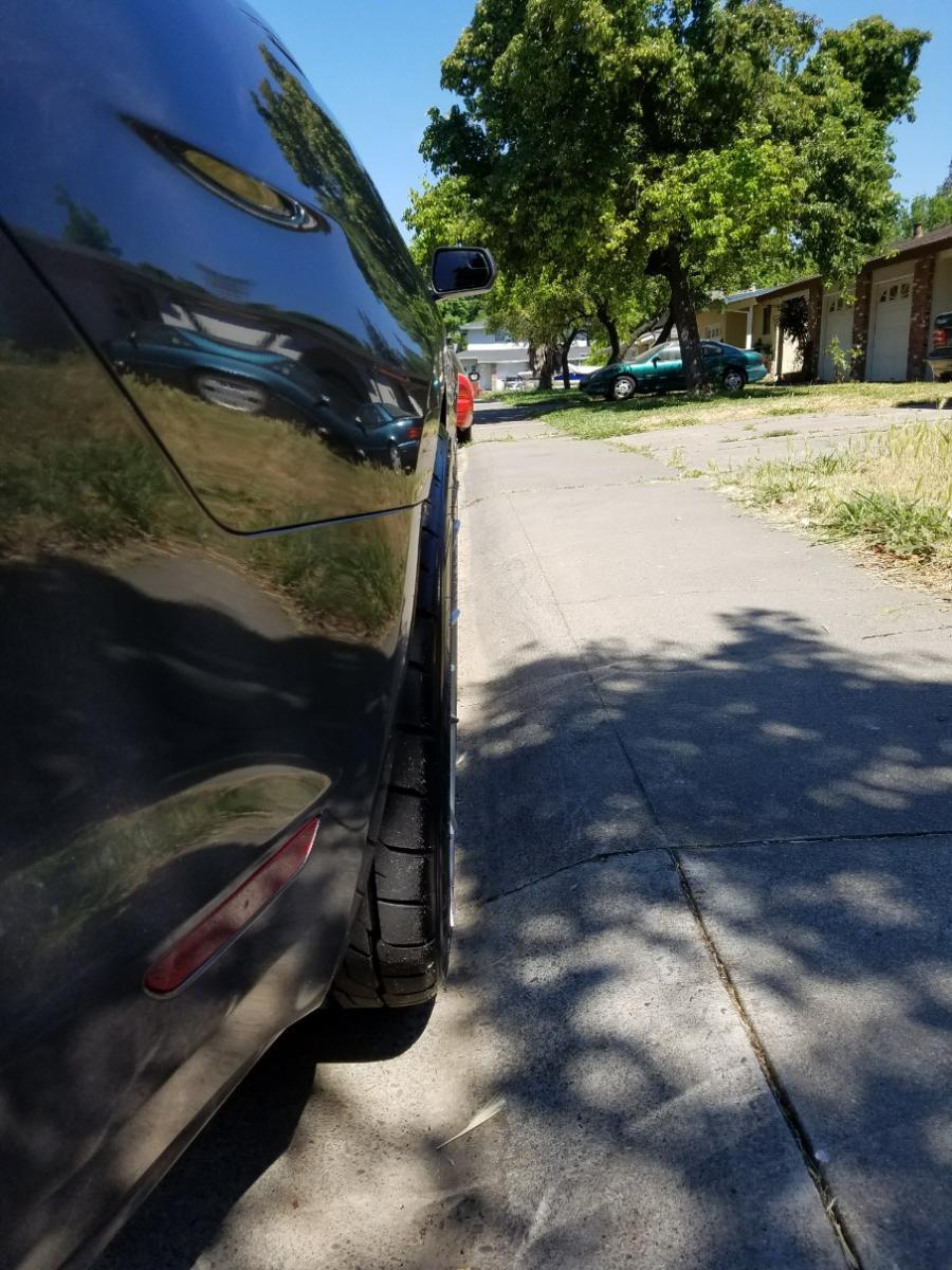

Blaque Diamond BD11 20x10/11 ET35 all around. Nitto NT555G2 275/35 and 295/35. Stock ride height (for now). Feedback welcome. Definitely a little poke in the rear but a drop should fix it.

Looks good. Lowering it a bit should add some negative camber and get rid of that poke in the rear.

Thanks guys. Yep I need to order springs ASAP now. I'm wondering if I can get away with the Sportlines (1.5"F 1.3"R) or if that will cause rubbing.

Really depends on the offsets
IUf you know them that would help
But looking at it and knowing the tire sizes you stated, you should be fine

You'll be fine up front, but the rear might need some camber after you lower it. There's plenty of adjustment from the factory, so no worries there.

MellowYellow: ET35 all four corners.
