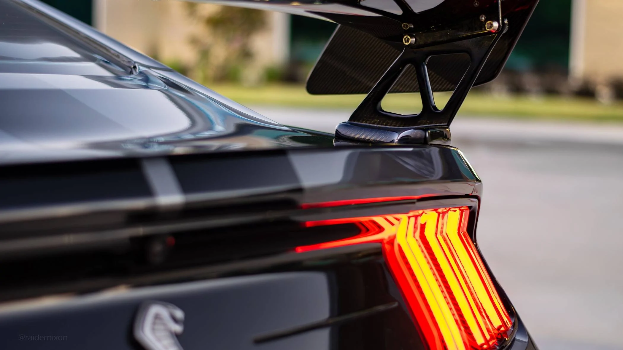

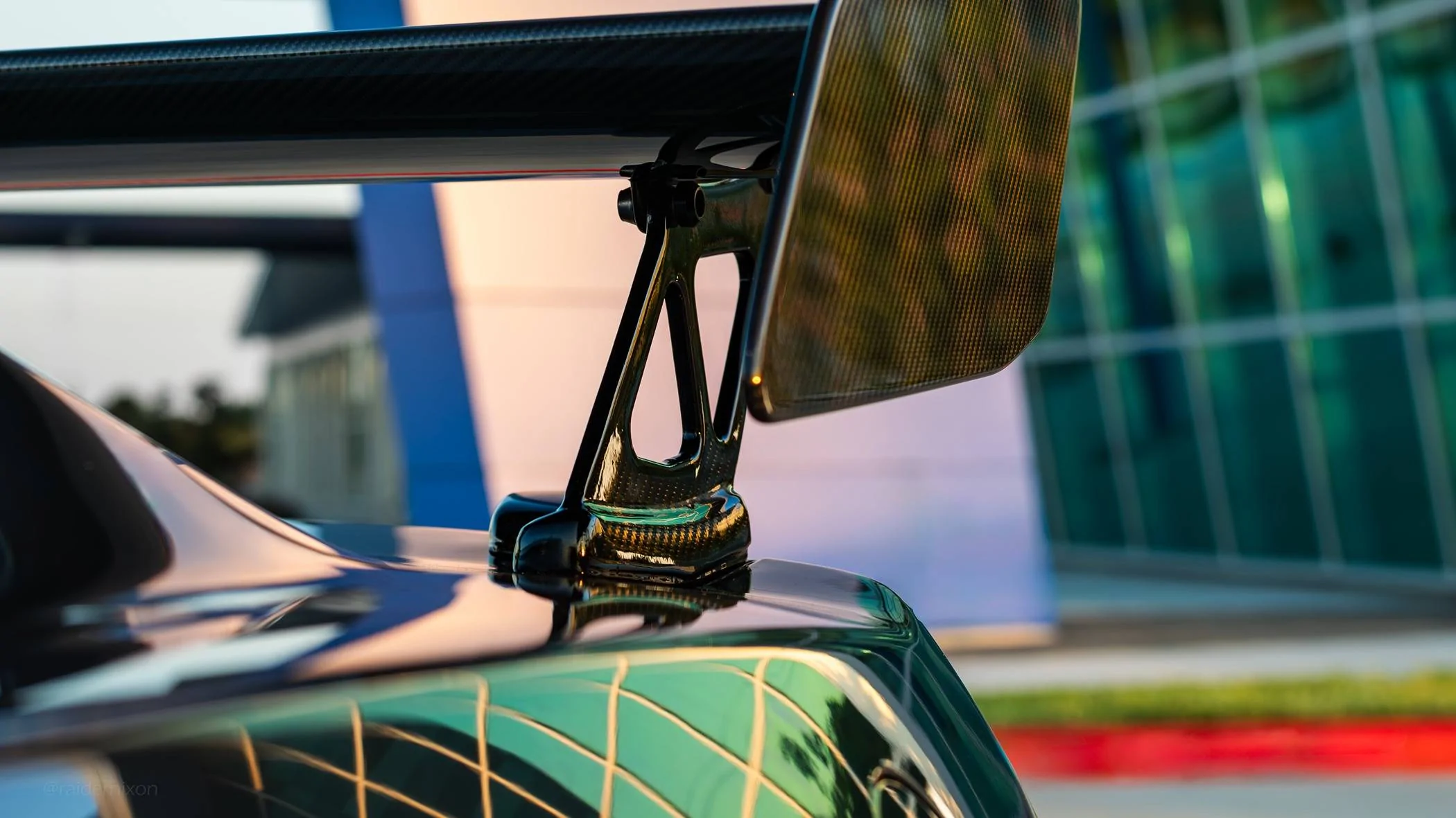

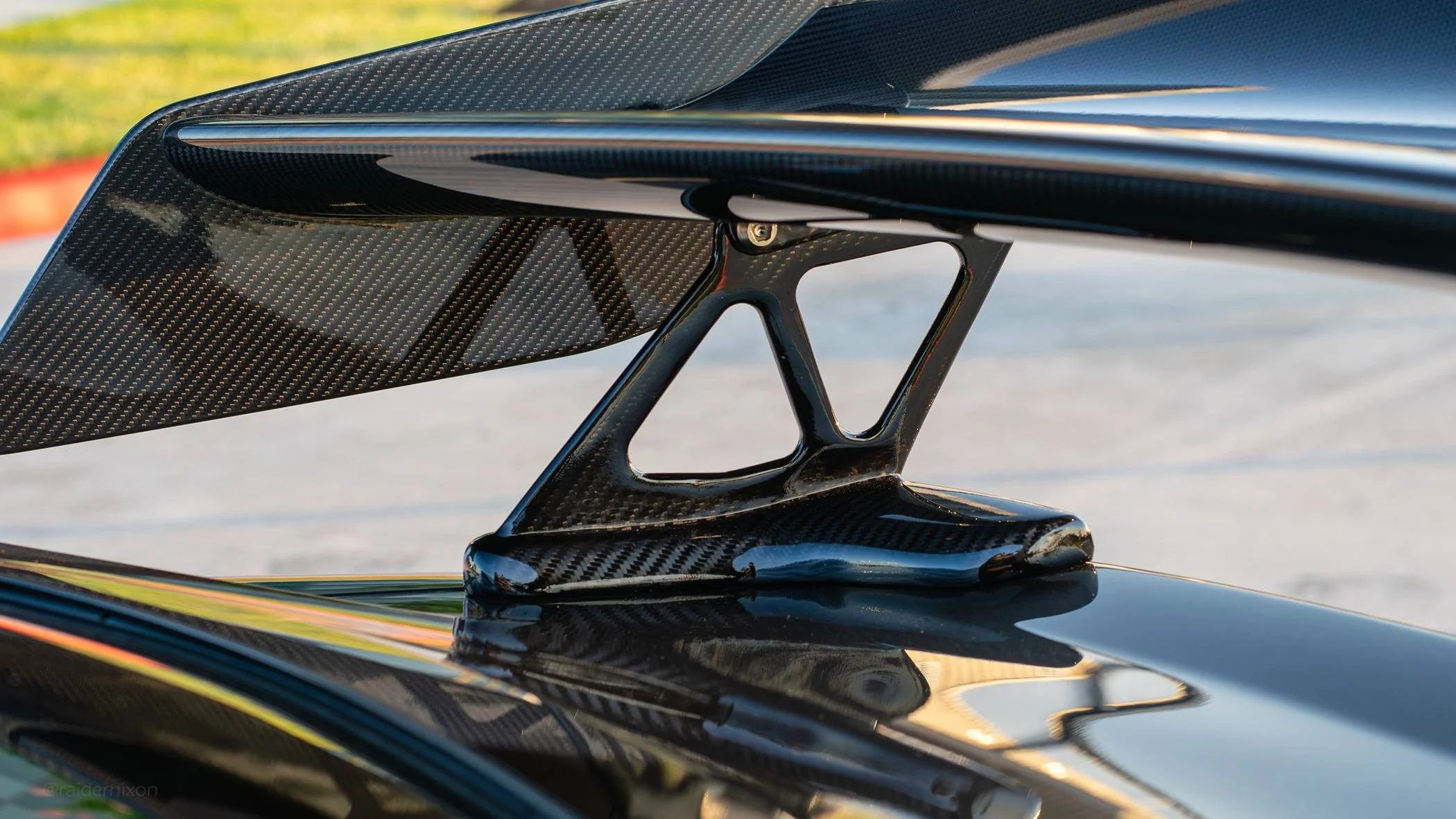

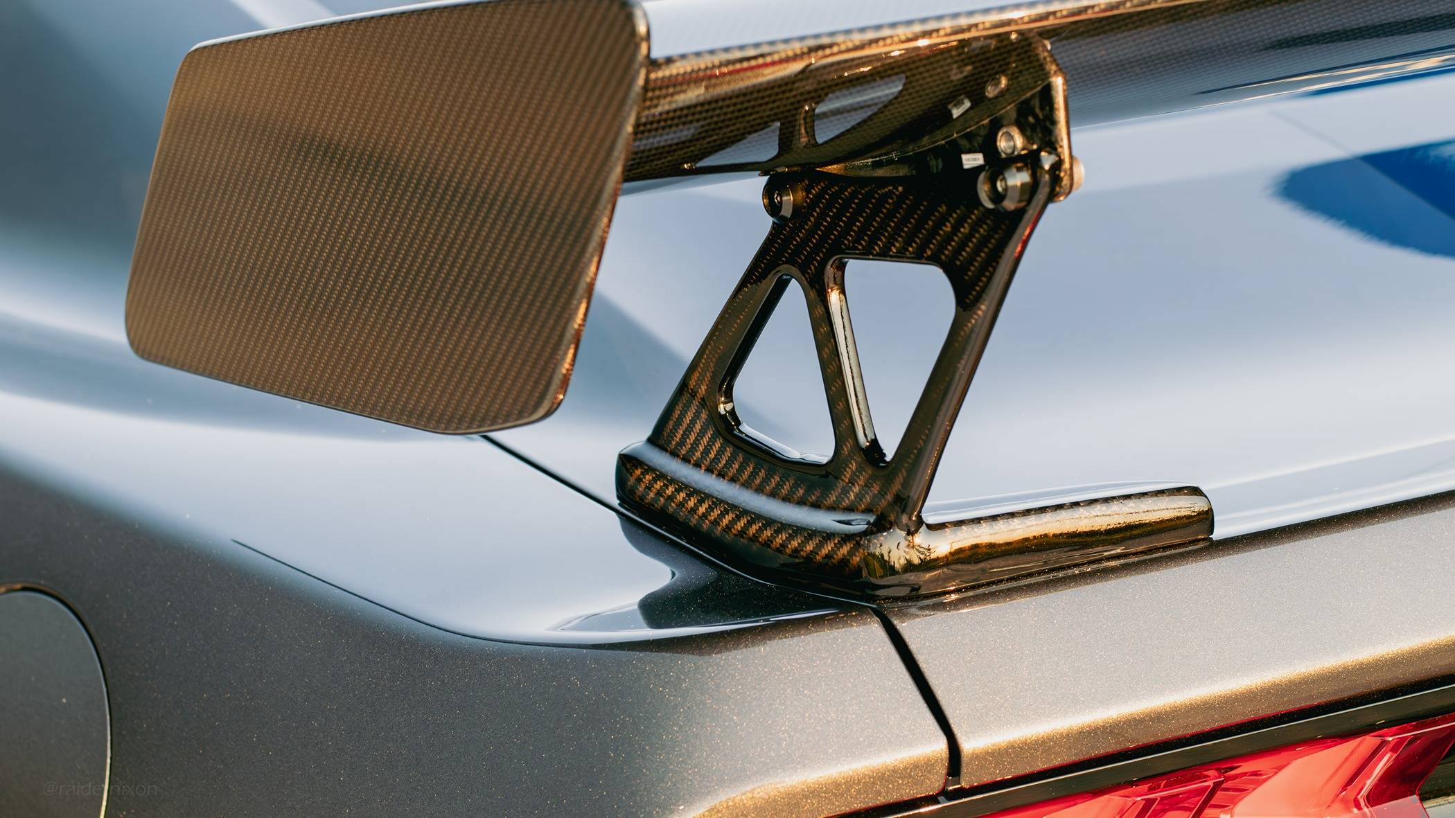

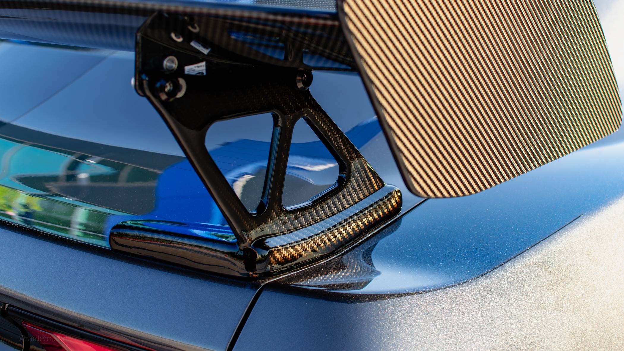

I wanted to share the newest addition to my GT500, which is a set of elevated carbon fiber uprights made by BTI that were recently released for sale to the public. These uprights have been meticulously designed and tested to maintain the overall OEM upright look and improve on the OEM design while elevating the wing an additional 2 inches to match a similar height to the Mustang GT4 race car wing. The uprights are a direct bolt on with the original OEM hardware.
More information on the immense amount of design work and testing that went into the development of these over the past 1.5 years can be found at the following website, along with purchase information: https://www.btirace.com/aerodinamica

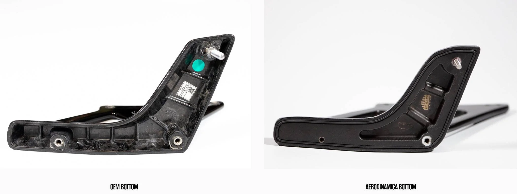

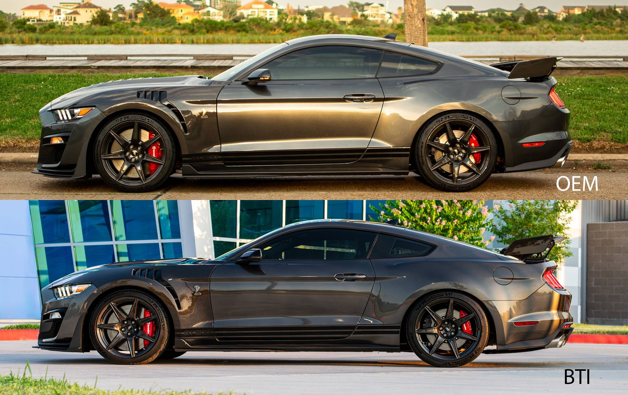

The OEM uprights are made by a process of injected molded carbon fiber and are painted black because the resulting finish does not match the exposed carbon fiber on the car. What makes the BTI Aerodinamica uprights special is that they are made of carbon that is forged in aluminum multi-piece molds which incorporates a skeleton made of carbon fiber, allowing for a clean exposed carbon fiber finish on the uprights, if desired. See the below comparison photos:

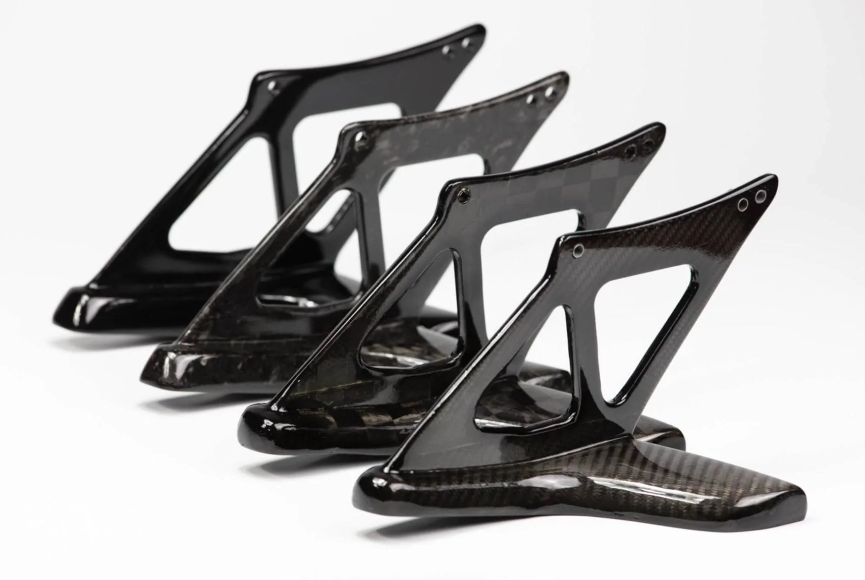

The uprights are available in four (4) “flavors”, including Black, “Naked” (forged carbon fiber), “Victory” (checkered flag carbon), and “Variant” (matches the OEM carbon fiber wing/wheels). See the below photo with the respective finishes left rear to right front:

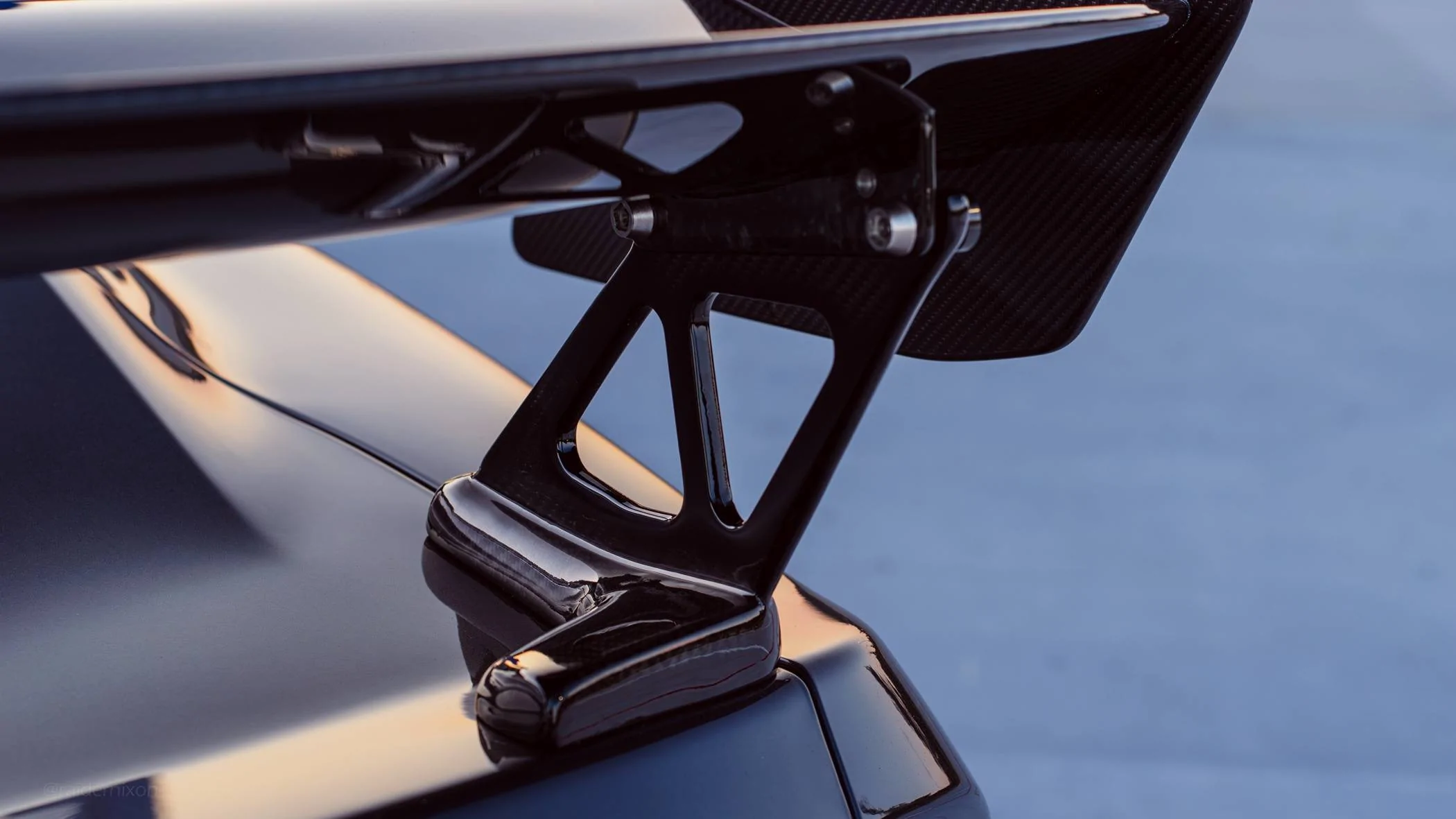

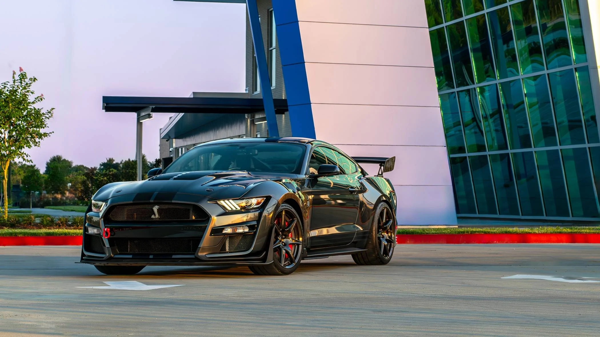

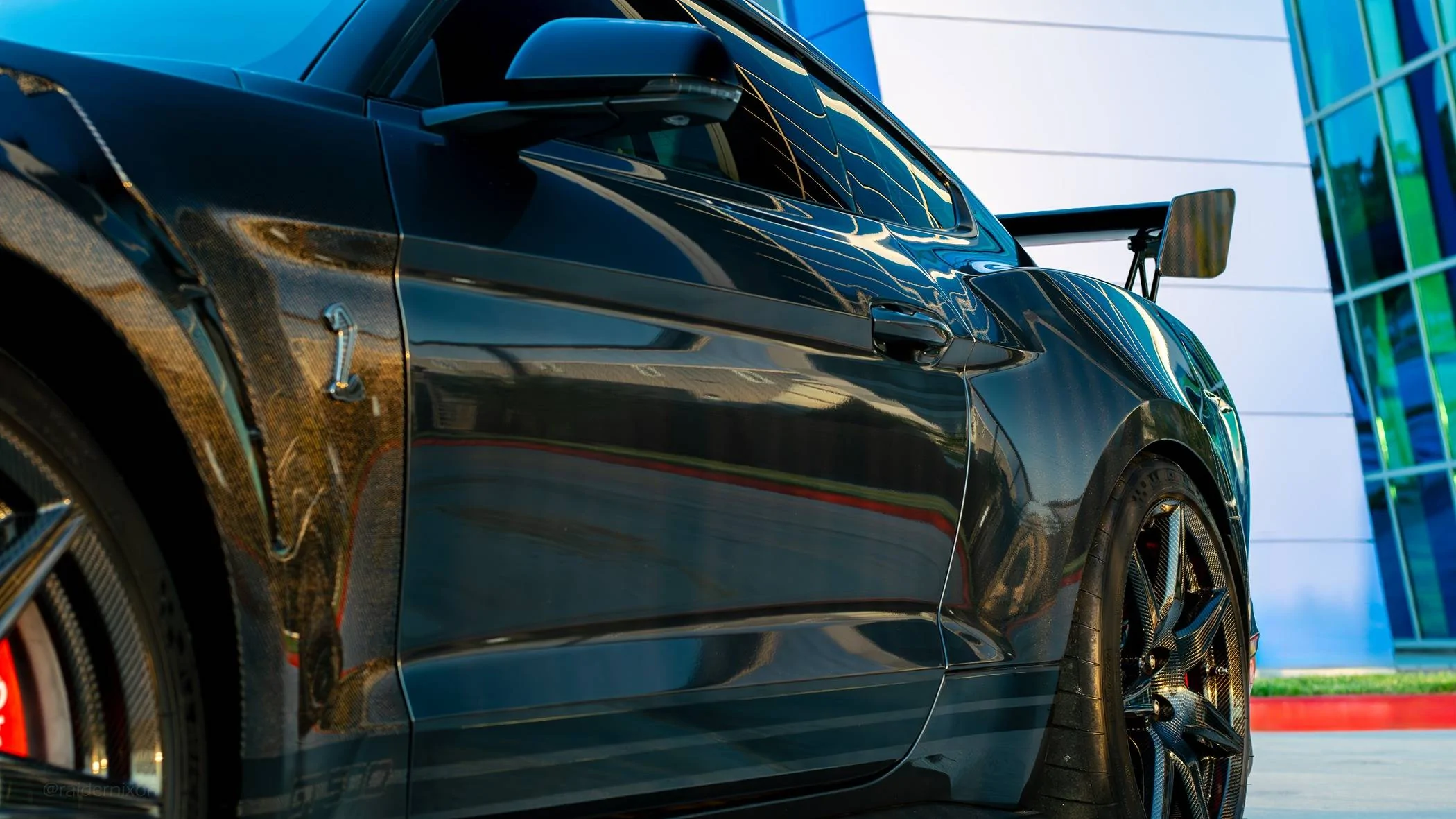

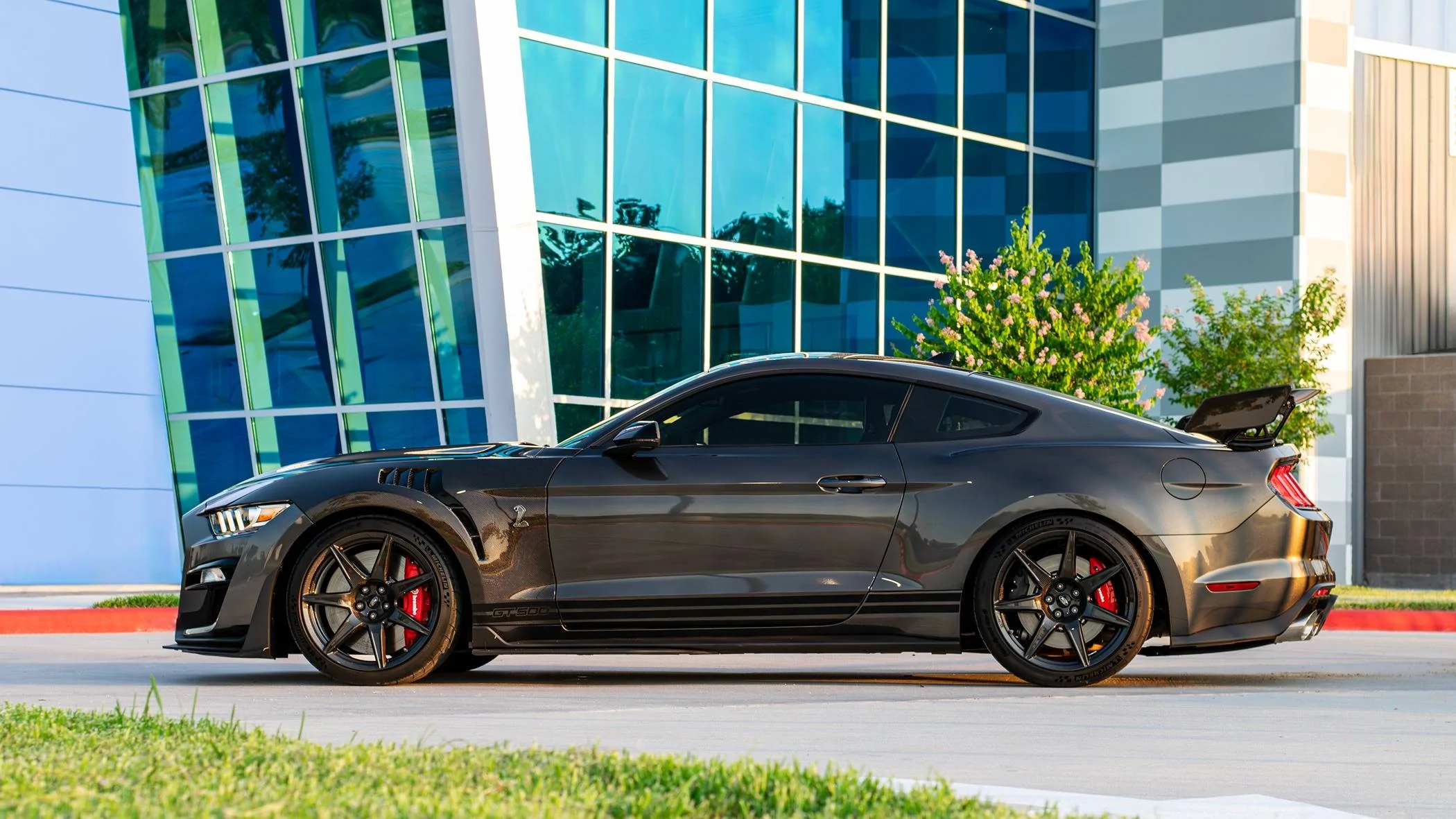

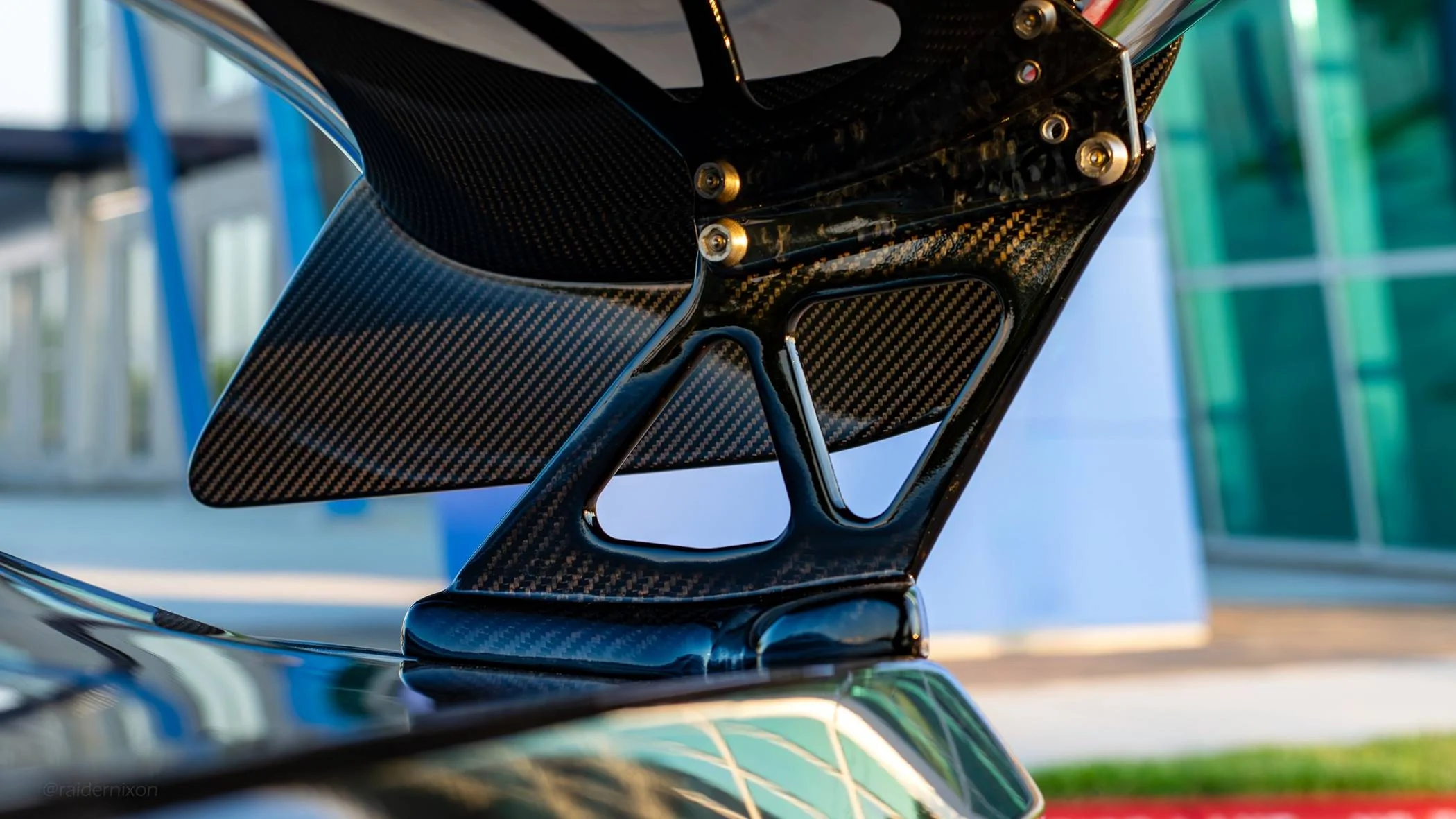

Installation was a breeze and took me less than 30 minutes, even with a screwed up left hand (bike accident last November). The uprights use the factory mounting hardware and precisely fit on my car. Nothing had to be forced to fit. I couldn’t ask for an easier install.

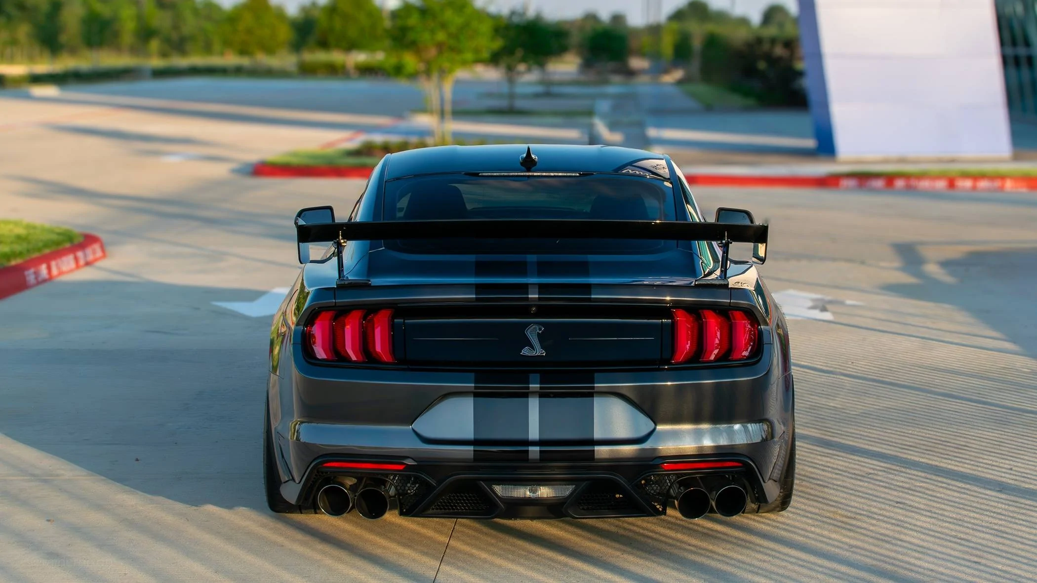

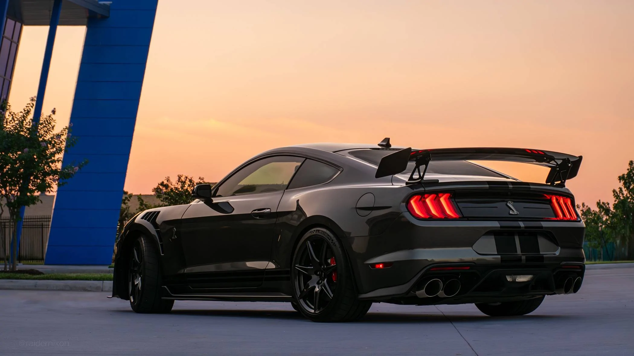

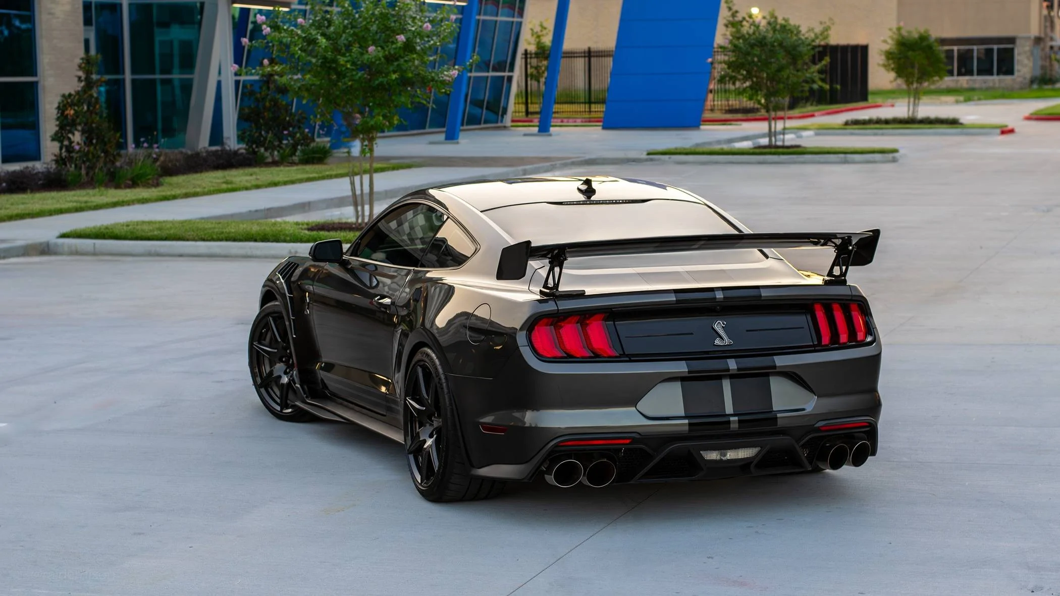

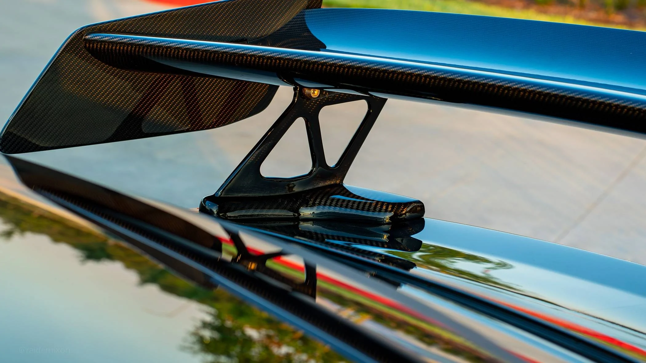

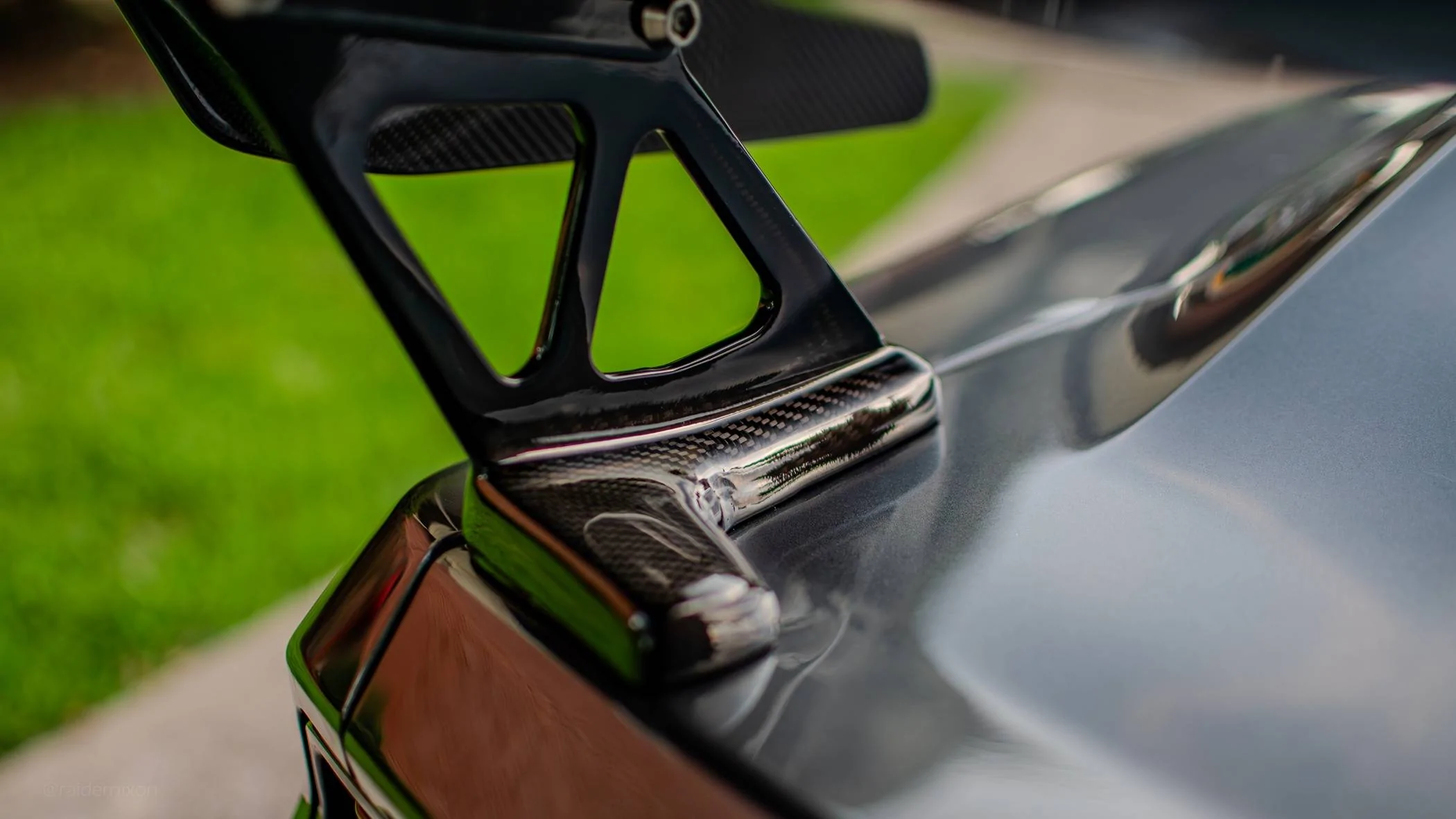

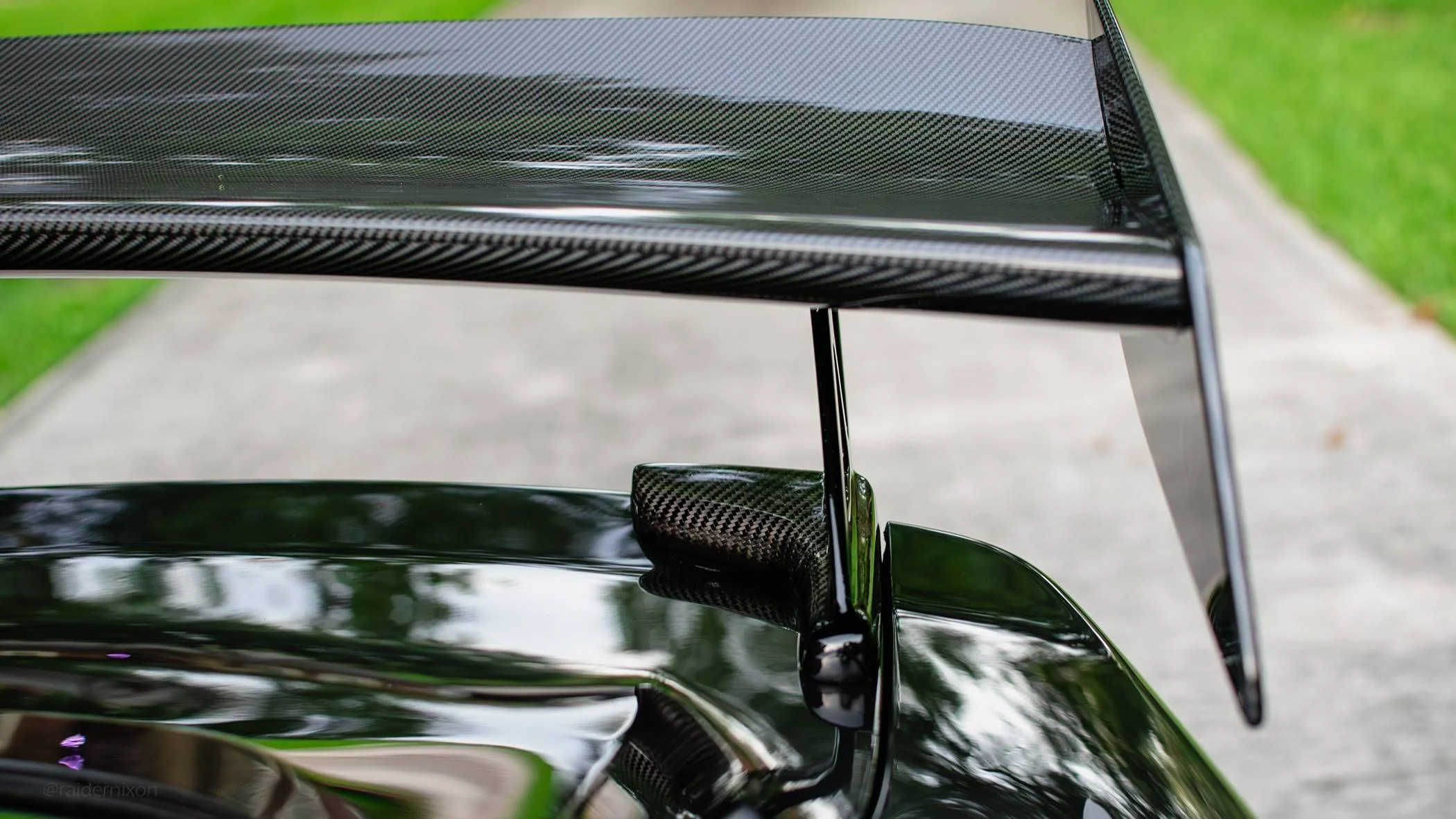

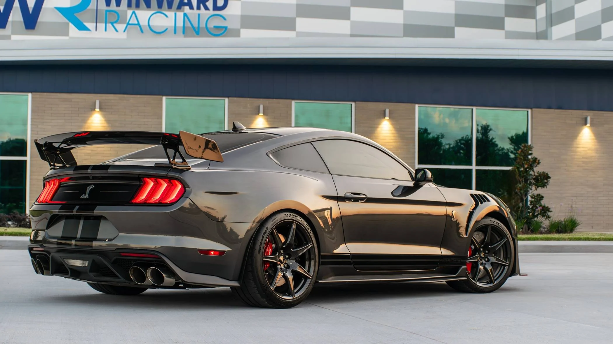

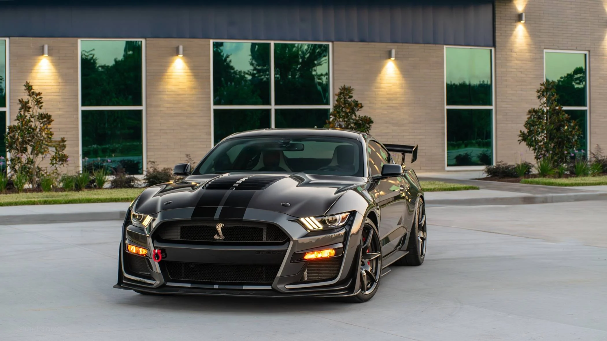

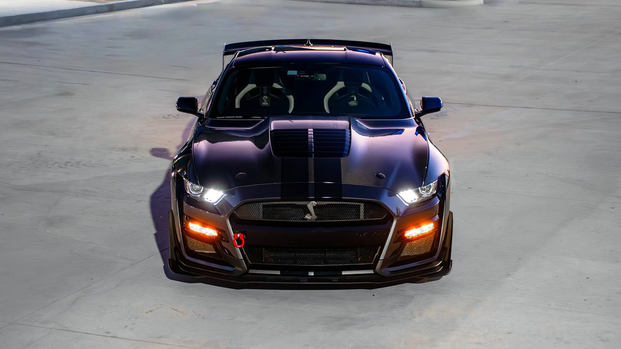

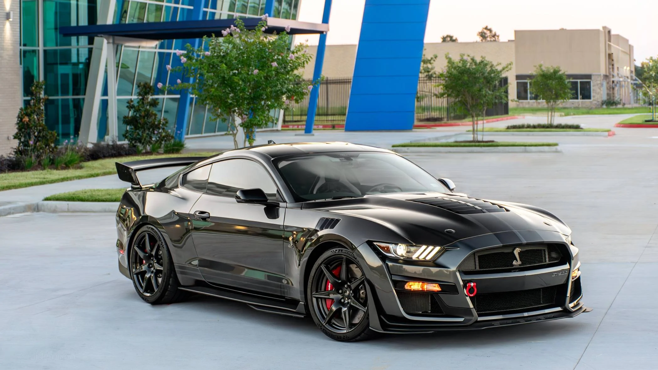

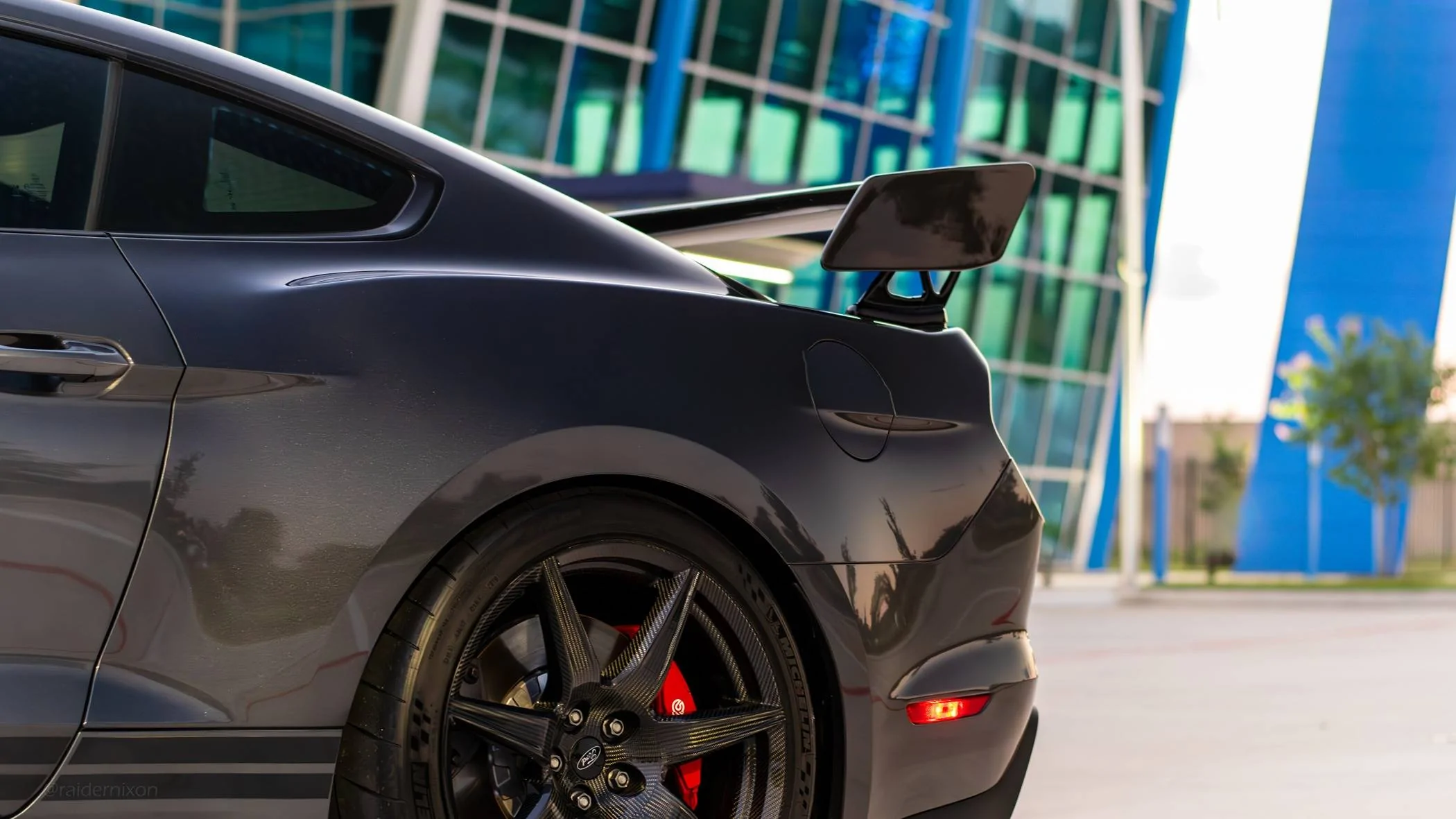

Enough with my rambling. I will let the photos from my photo shoot last week speak for themselves. Full disclaimer: Despite how this post may come across, I am an actual customer that bought these at full cost and was not given these uprights in exchange for a review. I am wanting to spread the word on what I feel is an option that I was seeking for quite some time which finally became available and exceeded my expectations. You will see some of the below photos on BTI's website and I have given them permission to use them.

Your photography skills are rather impressive. Those photos are extremely well done!
I'm drawn to the things you often don't see, in this case, the underside. I like the thickness and heavier than stock ribbing. The o-ring is done better than factory. It's a shame when you see the poor job the factory mod shop did on CFTP cars when they butchered the decklid holes that they "drilled" for the wing. And every time I have ever seen a pair of factory uprights removed, the o-ring on them is flattened and/or torn, allowing water to get in. Ford could learn a lesson here.
Finish on these looks fantastic. Nice to see someone do them in CF instead of two piece aluminum. Good stuff and thanks for the writeup!

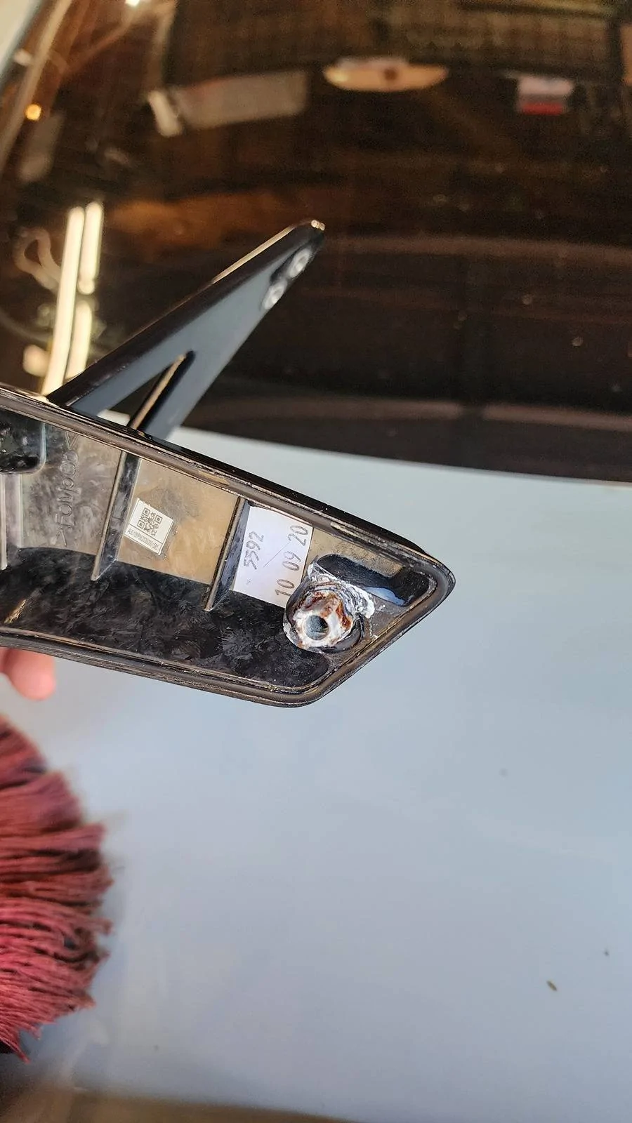

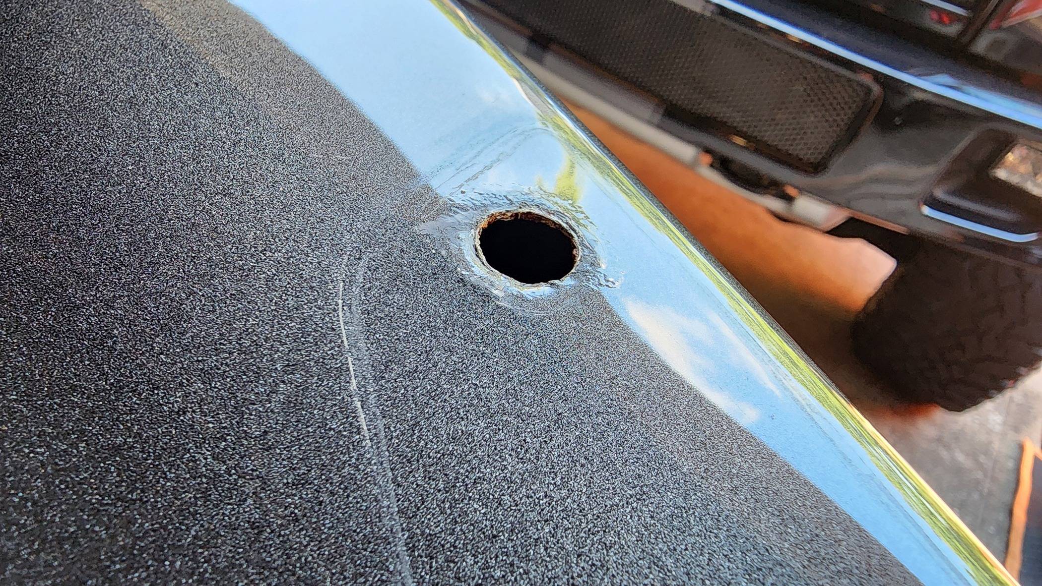

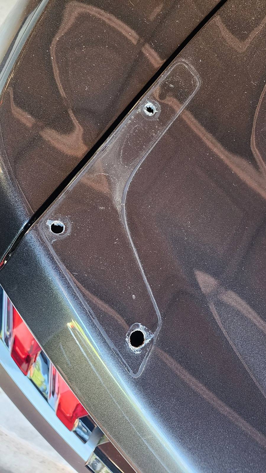

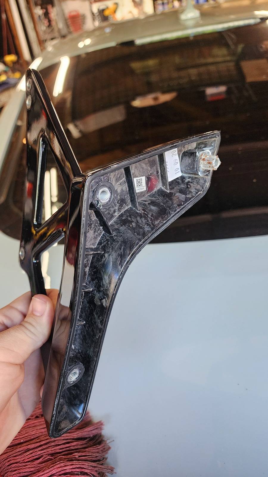

Funny you should mention the underside and butchery on the factory decklid holes. Check out the below photos from when I removed the factory uprights and found corrosion starting to bubble up under the paint. The stupid little rubber washer O-rings were completely disintegrated and the stud had separated from the anchor on the driver side factory upright (I was able to screw it back in, but the nut had almost completely seized onto the stud given the level of corrosion).
I haven't decided how I am going to handle this yet but I feel like the is a corrosion warranty issue. As a note, my car has 2,010 miles on it, is garage kept, and has never seen rain. It really only comes out for track duty. Just light hose water from washings here and there.
I highly recommend that all CFTP owners check for this issue and if it hasn't developed yet, to put touch up paint or SOMETHING over the factory holes to prevent this. The factory O-ring is NOT preventing this. Upgrade your uprights while you are at it :like:

Wow. That should absolutely be a covered issue but likely a battle that is worthy of a fight. The insert pulling out....first I've seen of that and not very confidence inspiring. Good thing you decided to upgrade!

The finish and the amount of choices are quite cool. And you're definitely right, the Hyperion ones go in a much different direction. I'm not a huge fan of super tall wings, so I think the Aerodinamica uprights offer a better balance of added height, looks, and better protection from water intrusion.

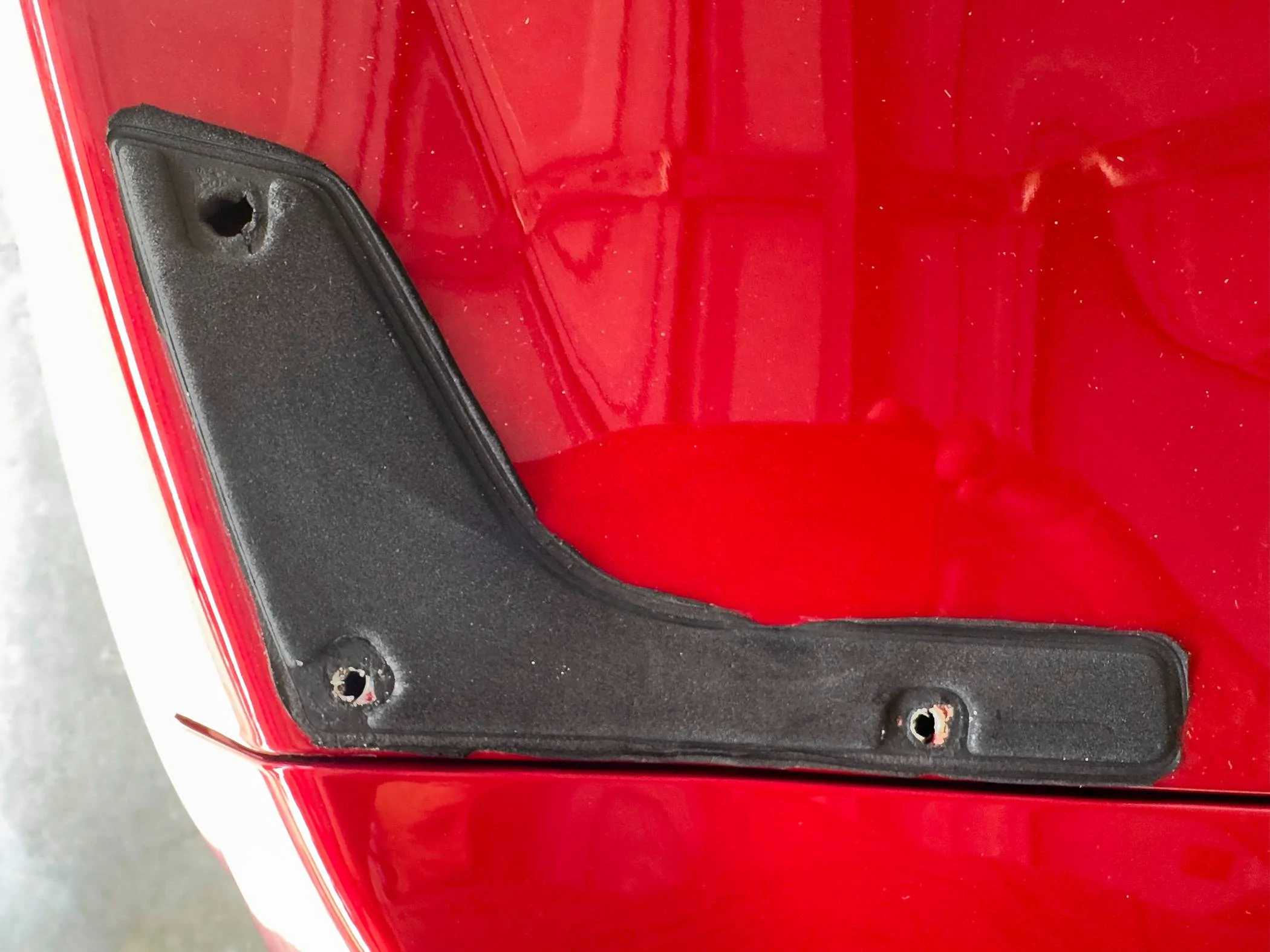

Had the same problem and while I didn't get a Before photo of the horribly-drilled holes, here's a shot of the squashed gasket as Tob mentioned. No doubt yours looked very similar.

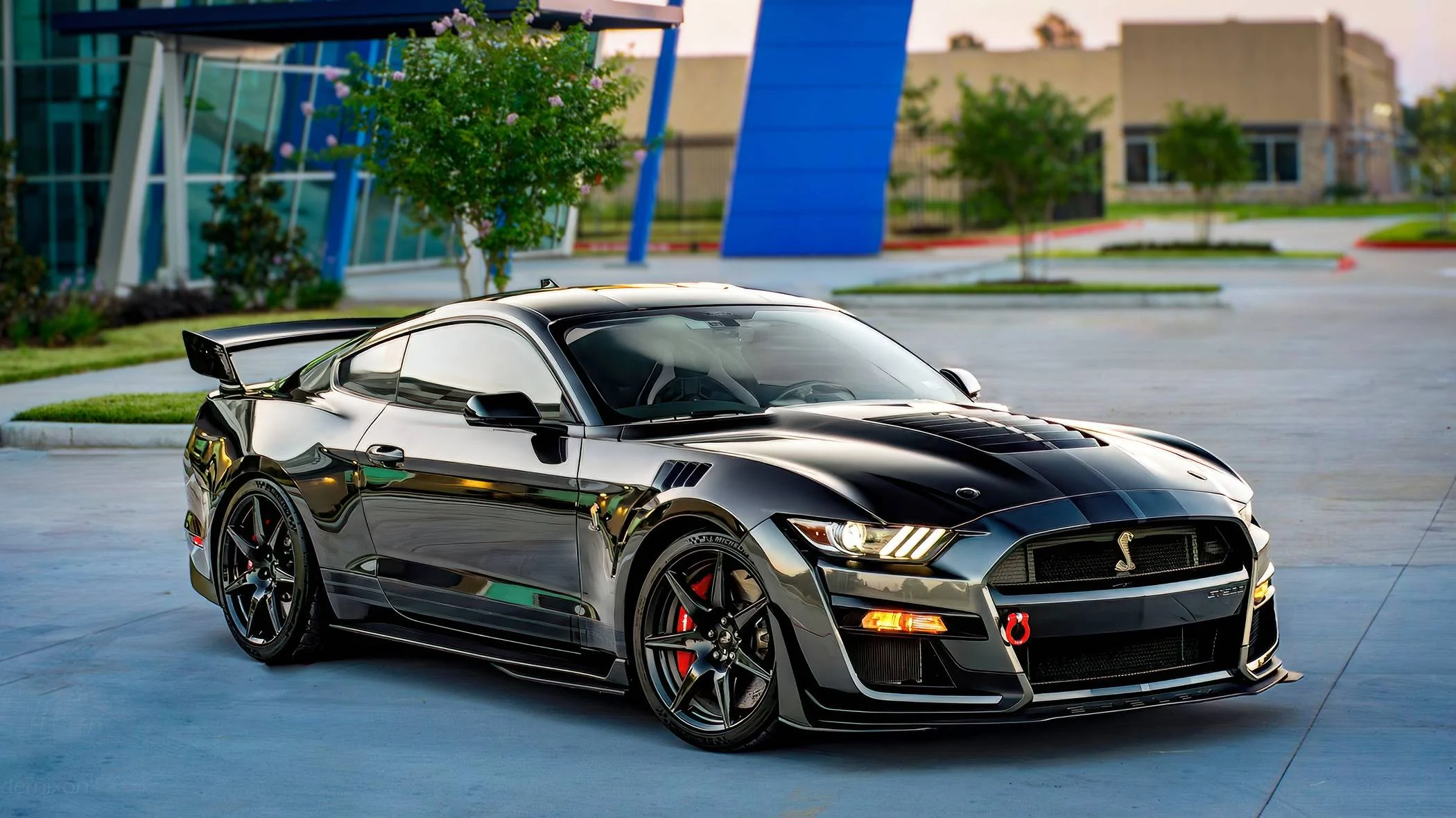

Loved the photos and she looks very sinister <grin> and this was my favorite shot. Superb lighting on that lucky day <smiling again> and aside from the sight of a frickin' gorgeous CFTP, (which, based on the image, had to have been polished, <third smile>) I especially liked the killer reflections. Great background as well..good choice. :=)

Thanks for the comments!
My setup is fairly simple. I used a Nikon D5300. Most of the shots were done with a Nikon 35mm lens. For a few shots, I used a Nikon 50MM and 18-140mm lens. I have Vivitar Polarizing caps on each lens.
Golden hour was exceptional during the evening of this shoot. The clouds west of here were casting some interesting colors. I had to use a tripod to capture many of these shots to keep noise down. The above image was actually quite a pain to get, as the lighting was rapidly changing and made it very difficult to get a shot with virtually no noise to it.
I shoot in raw format with manual setting dictated by the camera's internal light meter. During each shoot, I will take a handful of reference photos with my cell phone (Samsung S22+). I then use Lightroom to adjust the colors and lighting of the raw photos to match the reference photos, as the phone does a pretty good job with lighting and colors, but fails to capture the detail and perspective of an SLR camera.
