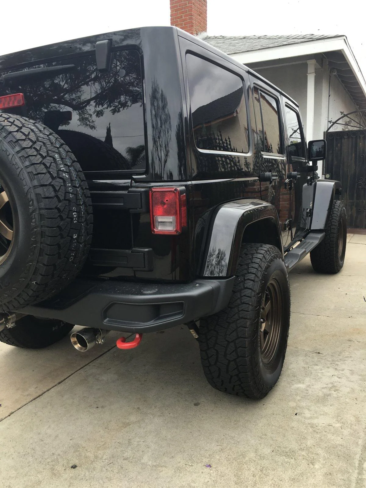

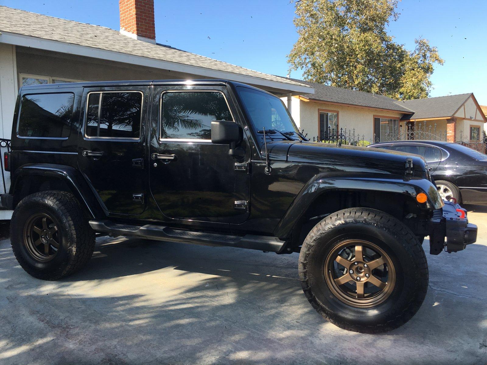

1. I've always been a fan of bronze wheels, especially a red car on bronze wheels. My previous car was a lifted Jeep Wrangler with bronze TE37v replicas and 35 inch tires.

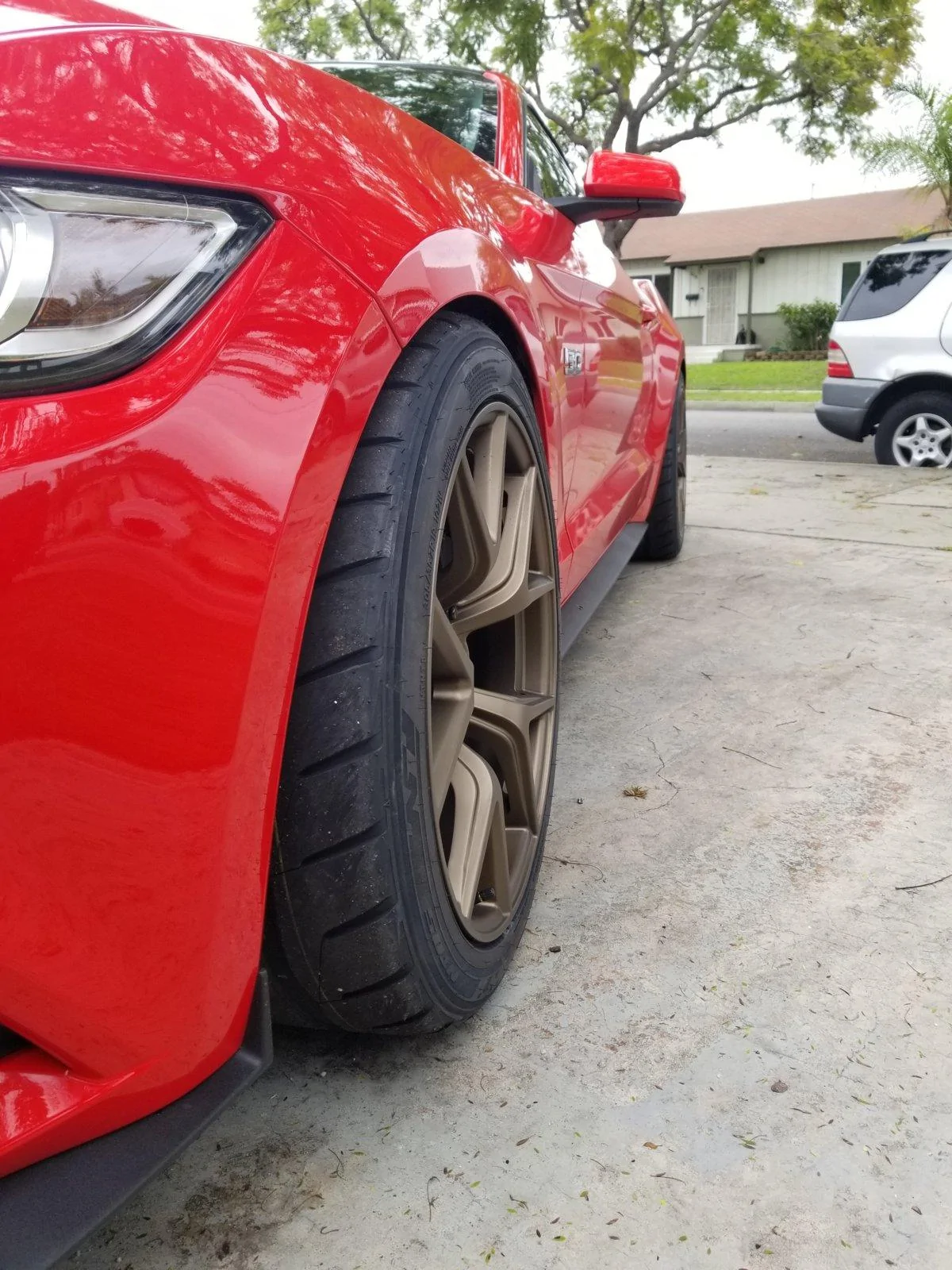

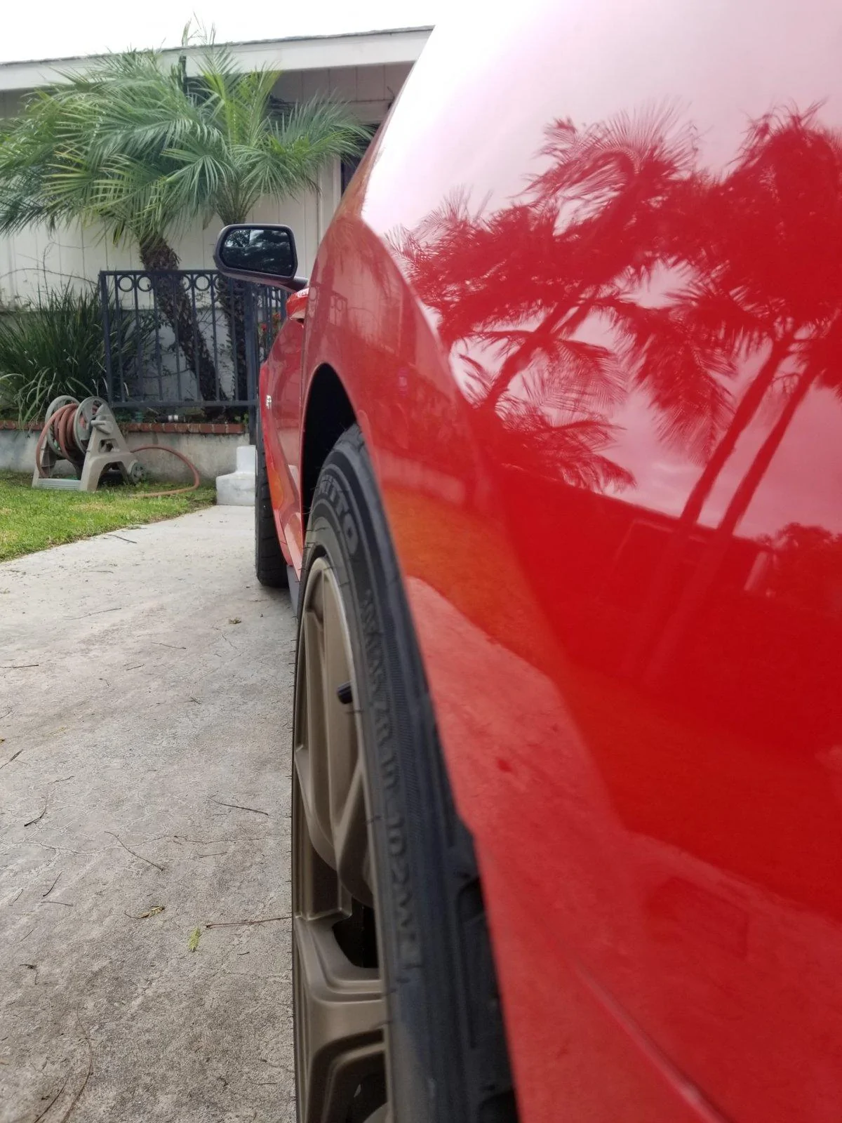

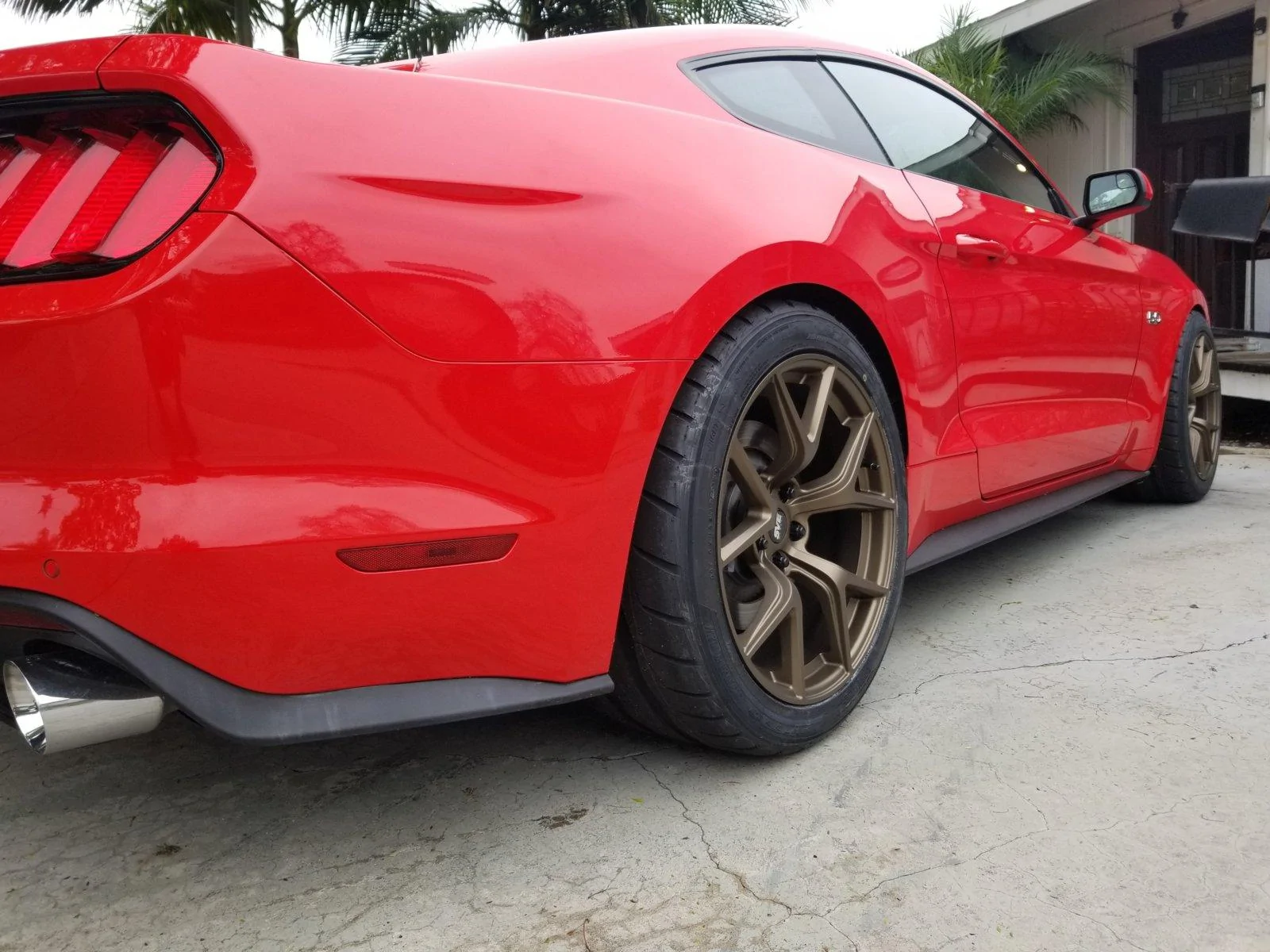

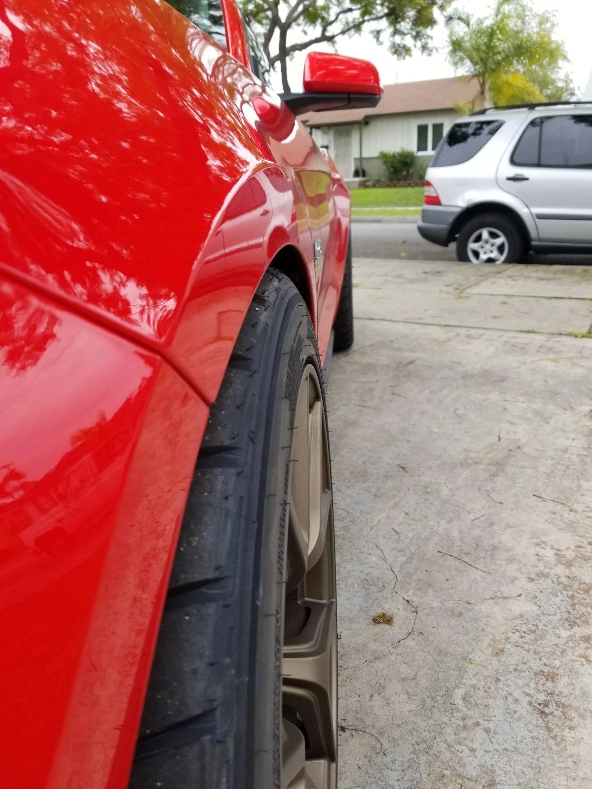

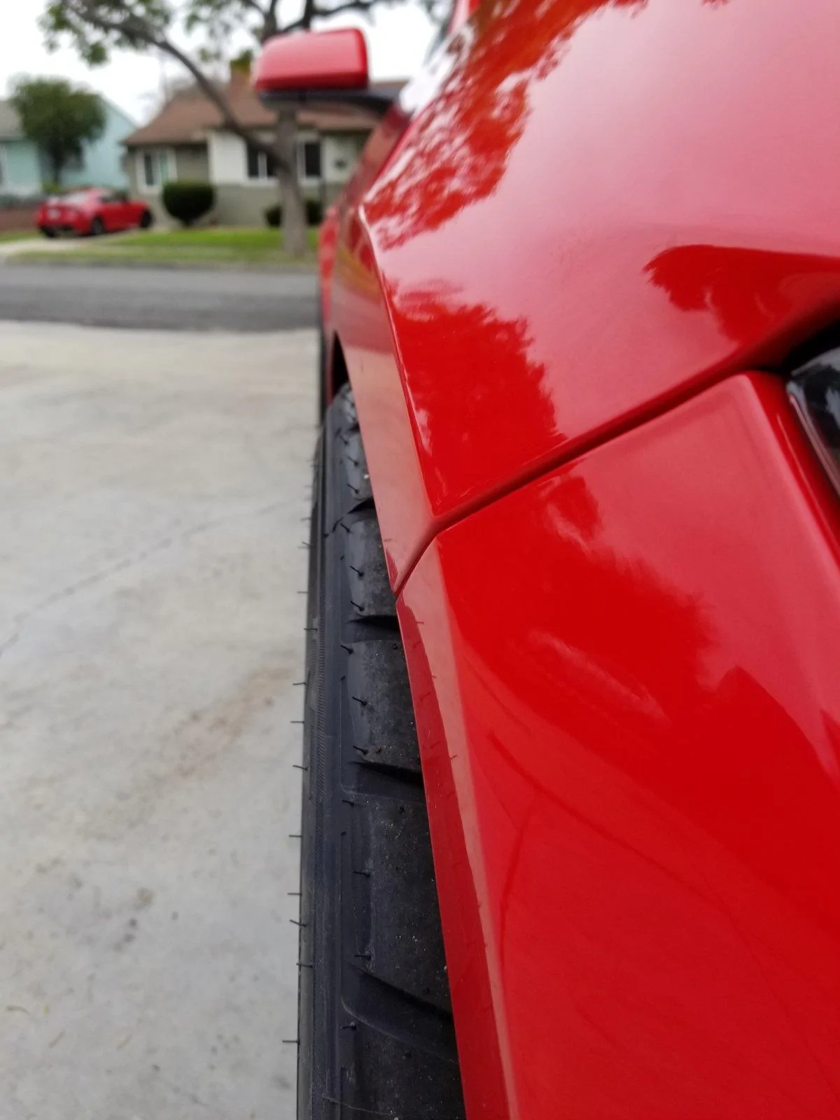

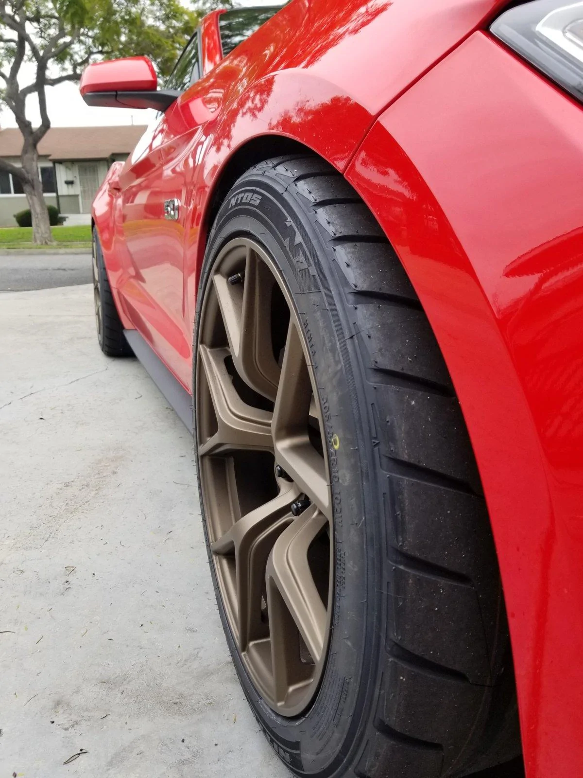

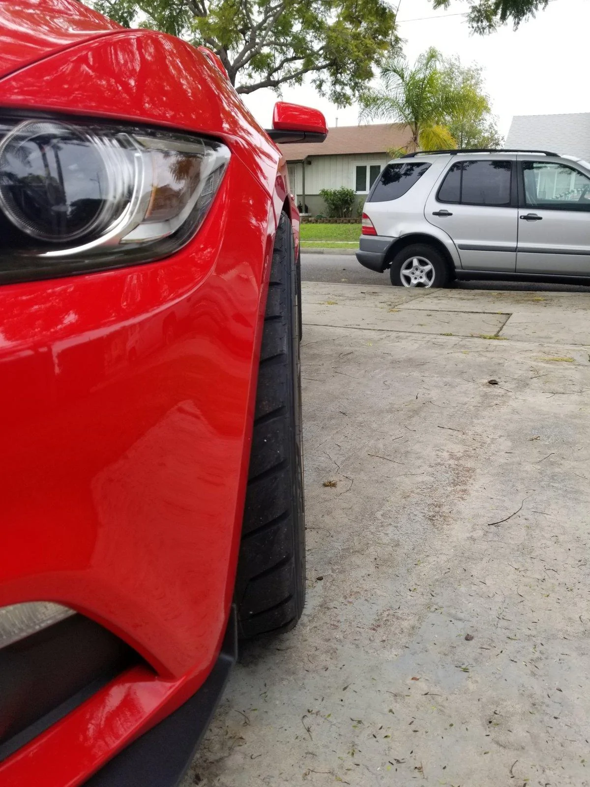

2. Just got around to taking some close up pics to show fitment. Again, specs are as follows:
- 19x11+50 with Nitto NT05 305/35/19 all around
- Eibach Pro Springs - about 1 inch drop all around
- BMR CB005 IRS lockout and brace
- BMR camber bolts on the front
- 25mm bolt-on spacer / adapter on the front (will convert to ARP extended studs and 25mm hub centric spacer ASAP)
- 2 degrees of negative camber on the front
- 1.75 degrees of negative camber on the rears
I think there may be space to fit a 20mm or 25mm spacer on the rears as well, considering many people have done a 325 rear tire. Does anyone with similar spec wheels and tires have input on this?
The 25mm spacer is needed for inboard clearanceDid you need the 25mm up front for rubbing or just looks?

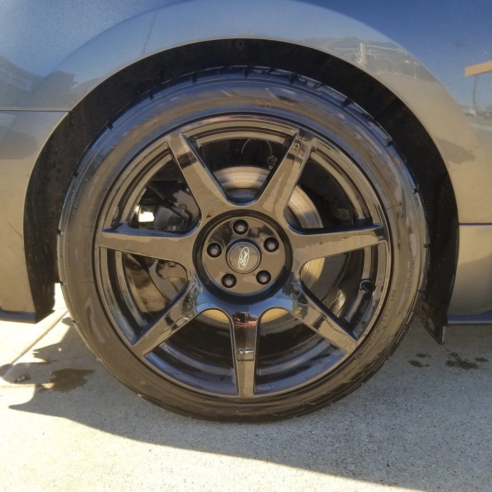

Pix please!OEM Center caps do NOT fit, but LMR says they have some caps that DO fit. They say "Ford" and are center caps for a GT 350. Since they only say Ford, and not GT 350, I got them for my wheel set I have waiting for my 2019 Mustang GT that is on order.
You can get them from Ford for about $9 a piece.Pix please!
Don't mind the dark...but does it have a glossy finish?They will lighten up some in direct sunlight, otherwise they are pretty dark.
Yes, they are glossy.Don't mind the dark...but does it have a glossy finish?
10" are flush with the fronts on 285's. The rear will have a slight poke with 325's.Will the 10" and 11" rims on the rear look the same as far as being flush with the fender
Am I correct in thinking on the 11" on the rim extra width is all inboard?
