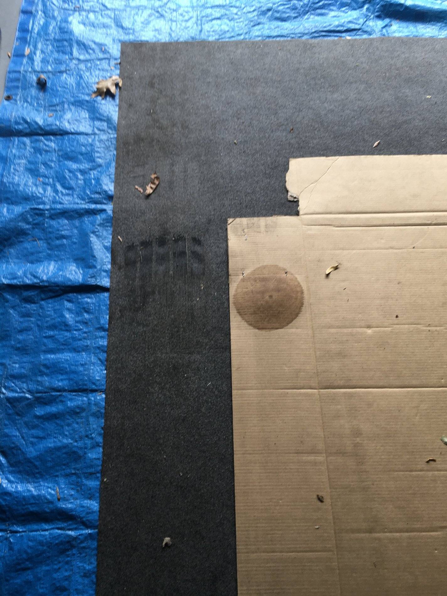

Hi - Today I rolled the car out of the garage after sitting there all winter. There was an oil spot under the car (see photo) just behind the driver side front wheel. I marked where it was on the car (see photo) and you can guess what it lined up with. Of course a few drops of oil on a piece of cardboard looks much worse than reality. That loose tube to the reservoir is indeed leaking, albeit minimally, and I will share the photo with the service dept. if they doubt me. I still couldn’t push it on as there isn’t enough give in the tubing so I’ll impose on the dealer to fix it. So thanks for the original post as I might not otherwise have realized where that oil drip was coming from... Bruce

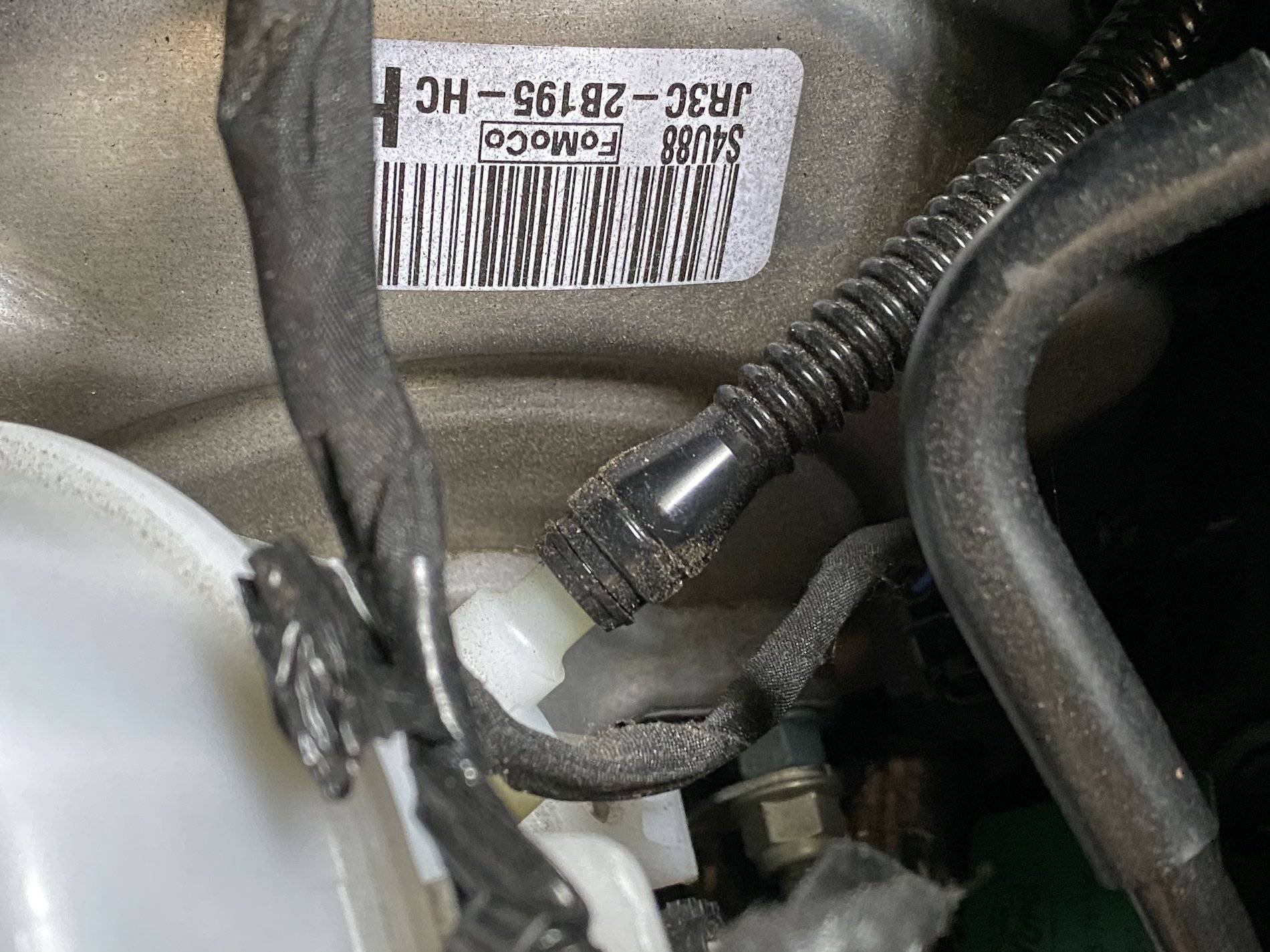

Read this article https://www.mustang6g.com/forums/threads/urgent-check-clutch-line-at-brake-master-cylinder.84132/ and please check yours..... I checked mine and damn hose was on the very end of nipple like in the pictures. Had to push it back all the way on as seen in the pictures as well. Was highly irritated finding this, if this had come off, that could be very bad news.
Ford should have used a clamp in such a important connection.........just BS.
Cant believe I did not see this before now when checking my levels under the hood.
I have 7500 miles on mine.
Wanted to make everyone aware :thumbsup:
