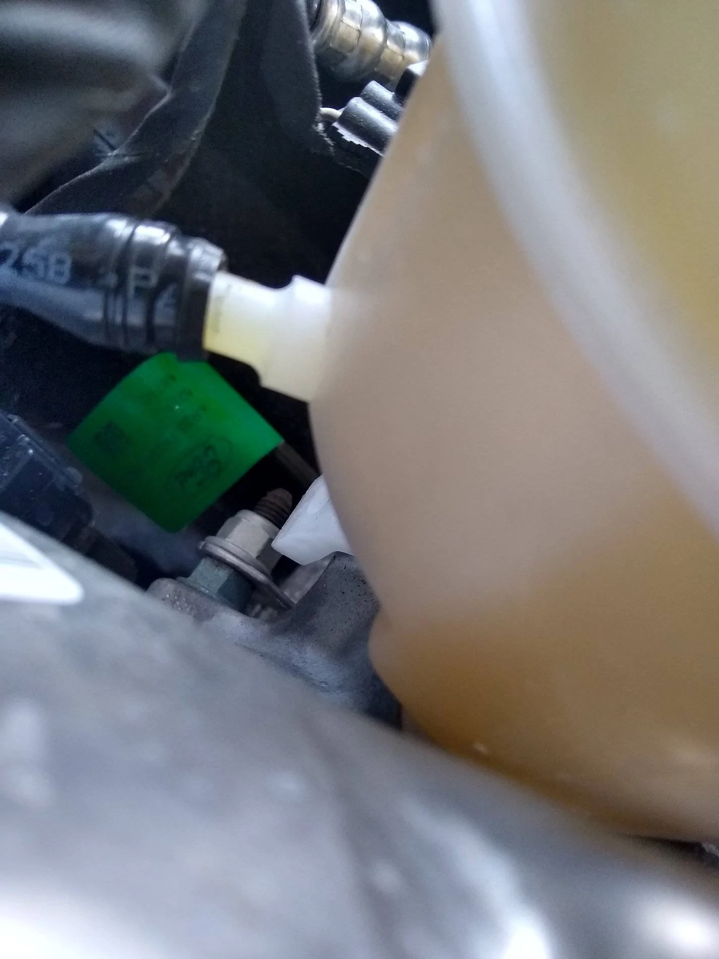

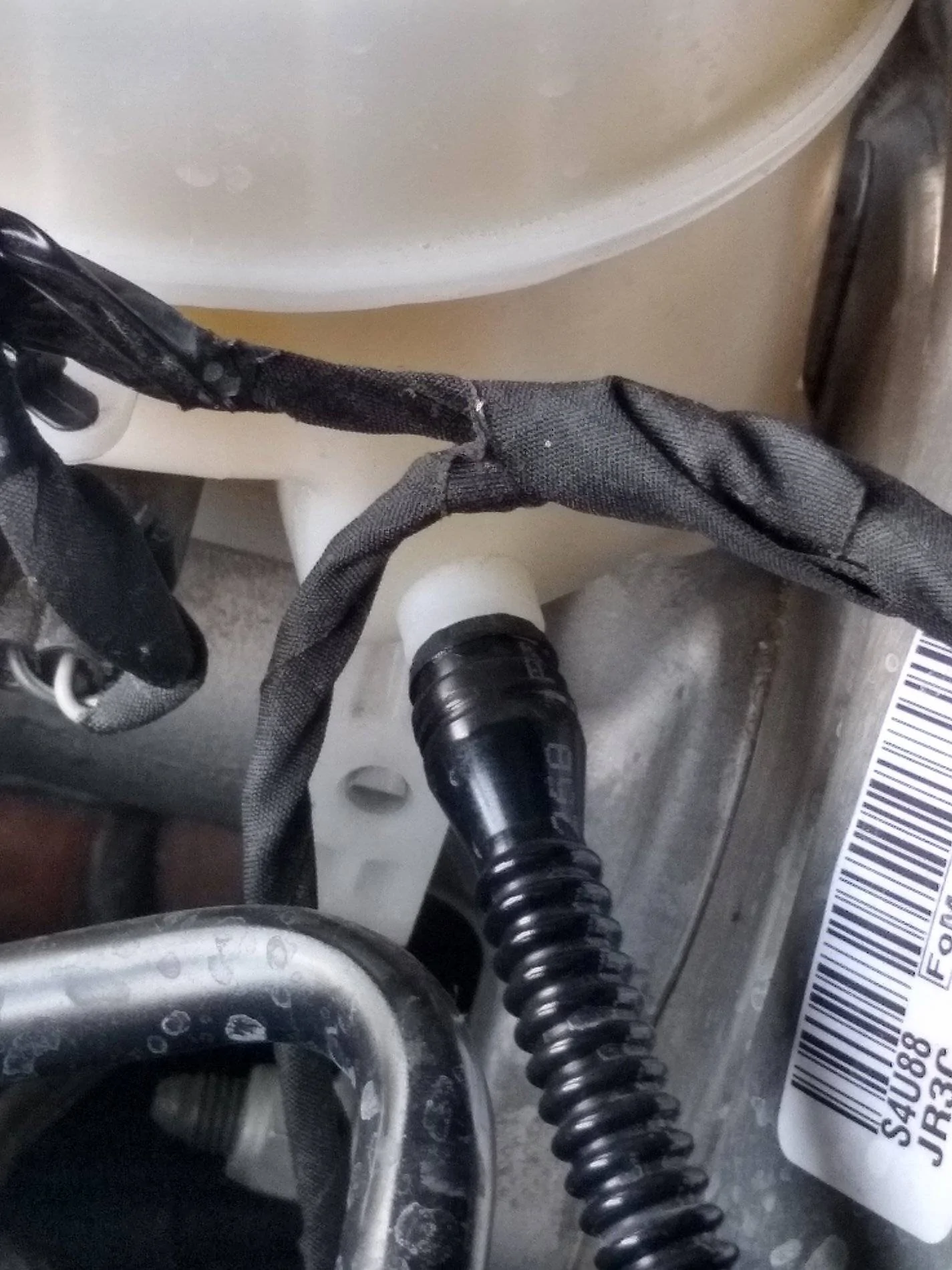

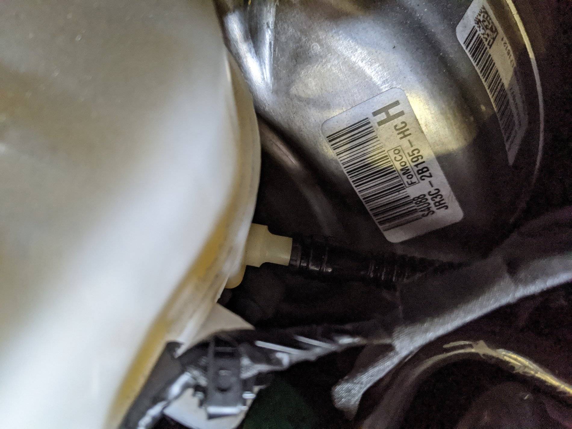

Mine was about half way out no leaks or seepage so I pushed it in.
Mine didnt have any resistance. It moved up really easy on the nipple. I will check in a few miles if it has moved again.Mine was also halfway out. That tube is so short it's almost impossible to push it all the way on. I just left it as is since it;s not leaking right now.

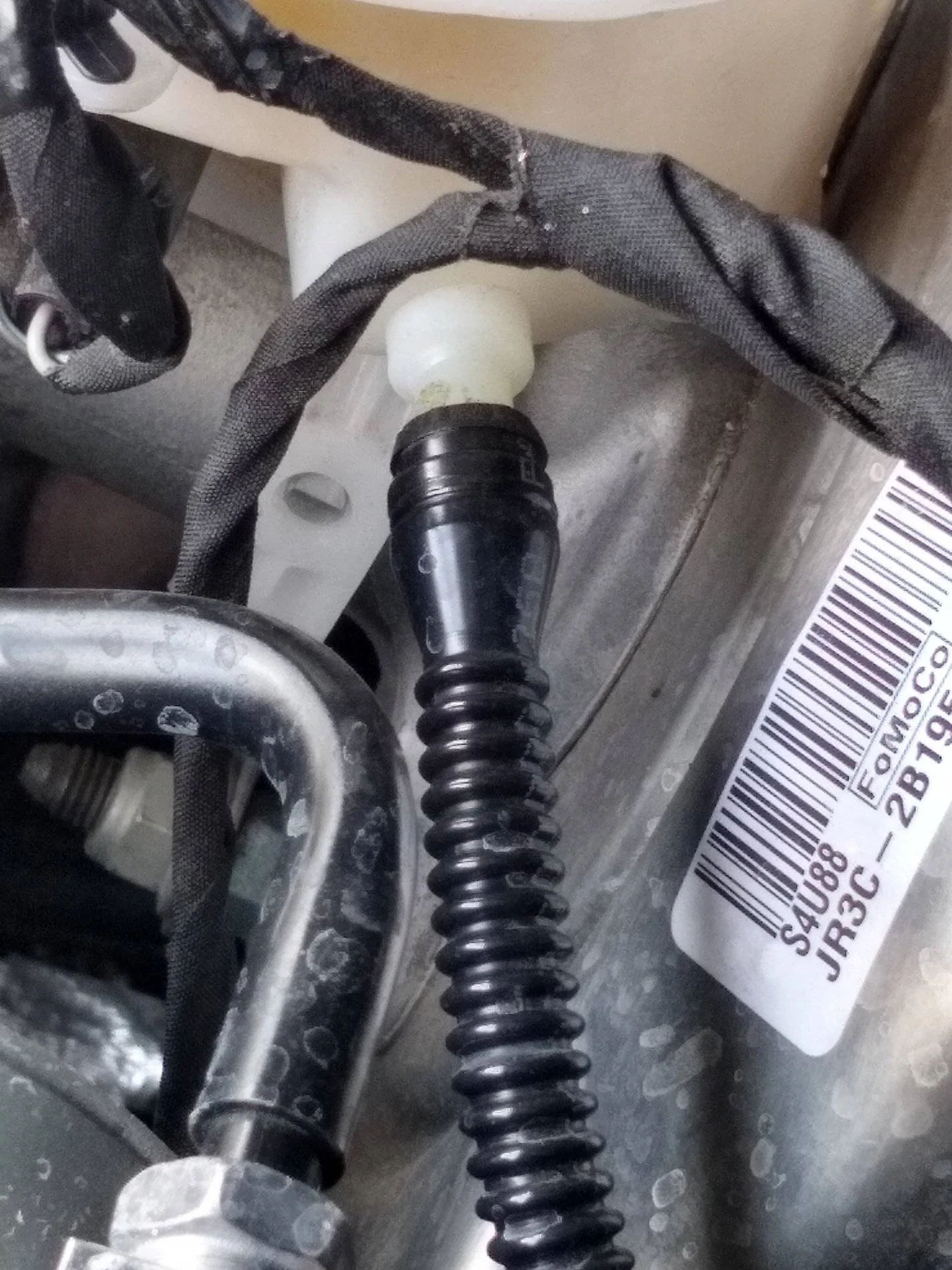

Mine was at the very end, and being held on by the barb at the end of the shaft.Mine was about half way out no leaks or seepage so I pushed it in.
Mine hasnât move back either. But I went ahead and bought the Steeda kit as insurance.Mine was at the very end, and being held on by the barb at the end of the shaft.
After several days now having been moved all the way up, it does not seemed to have moved back down with normal driving.
But will be monitoring.

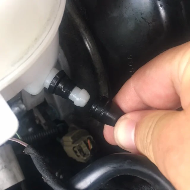

Read this article https://www.mustang6g.com/forums/threads/urgent-check-clutch-line-at-brake-master-cylinder.84132/ and please check yours..... I checked mine and damn hose was on the very end of nipple like in the pictures. Had to push it back all the way on as seen in the pictures as well. Was highly irritated finding this, if this had come off, that could be very bad news.
