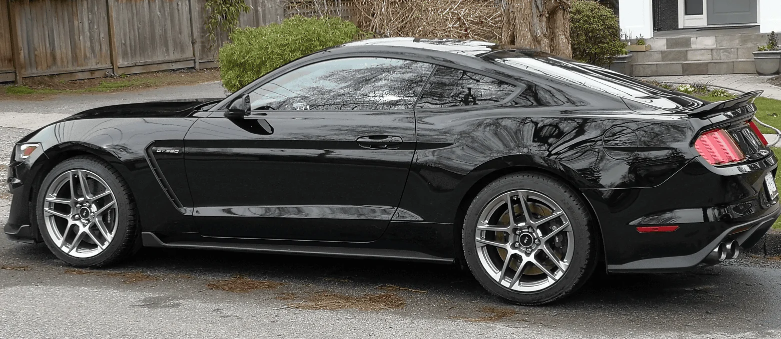

First visual impressions:
Perfect offset, From the back view-looking toward the front, along the side, the Poke is totally OEM. The color, still not sure about the gunmetal, I had the gunmetal color wheels on my 2015 GT premium w/50th Anniversary wheels and they looked good, but it was a triple yellow car. With the shadow black car, still wondering if I should have gone with the satin black wheels.
First driving impressions:
The steering: Amazing, absolutely no tramlining, totally gone. And the steering seemed rock solid, with no side effects whatsoever from the increased scrub radius. I was totally satisfied and happy that I now have some 40,000-mile tires to carry me on down the road.
Final Thoughts: Been driving with my new setup for several months now. Can I still take the 270-degree entrance ramp to I-75 at 95MPH… ? Yes, (With no traffic of course)
I am totally satisfied with this setup and not planning on going back with OEM. My original wheels/tires never came within 6” of a curb, the tires still have some mileage left on them. The wheels are mint, still factory mounted/balanced, so I put them up in my tire rack, not sure what I should do with them, I may end up selling them.

Test Fitting the Wheels for clearance and offset
Final Stance and Look
