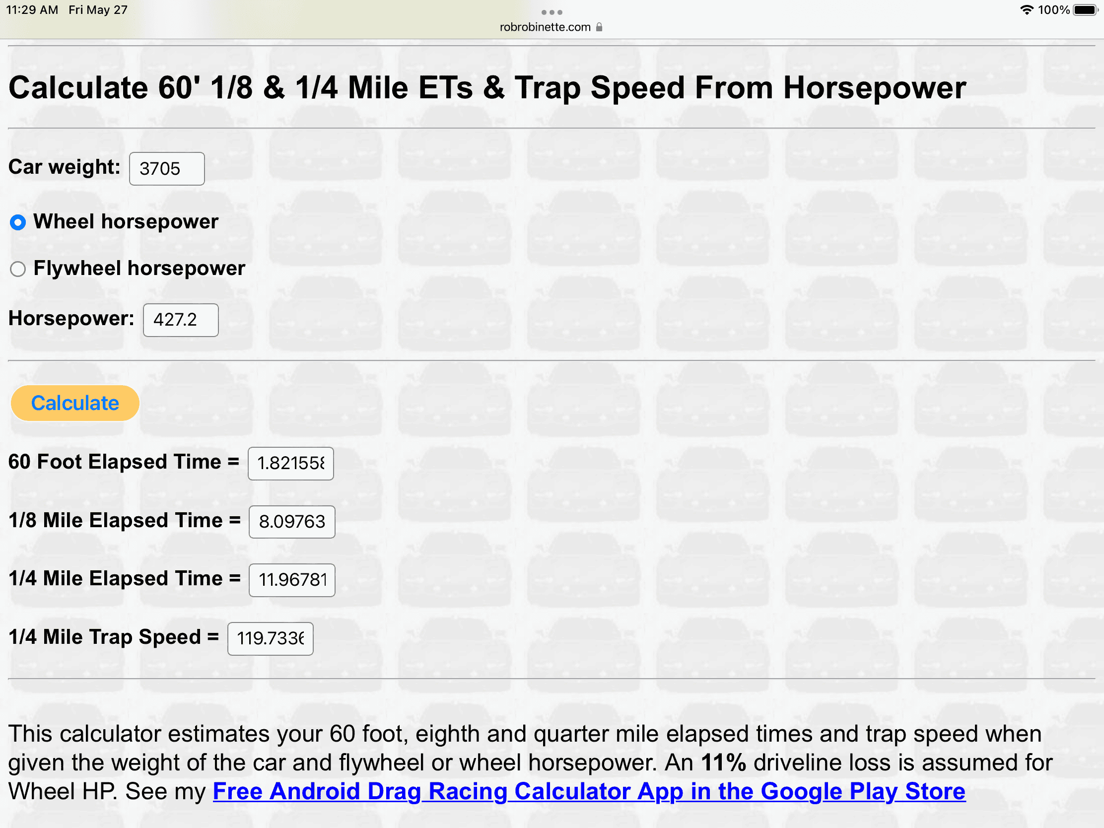

Thank you. Ford Performance’s website shows that the Bullitt ran a 12.9 @ 112.XX out of the box. Let’s also take the factory hp rating of 480 at the crank and assume there would be an 11% power loss (or 52.8 hp) at the tires due to driveline absorption, which would put real world numbers at 427.2 rwhp.

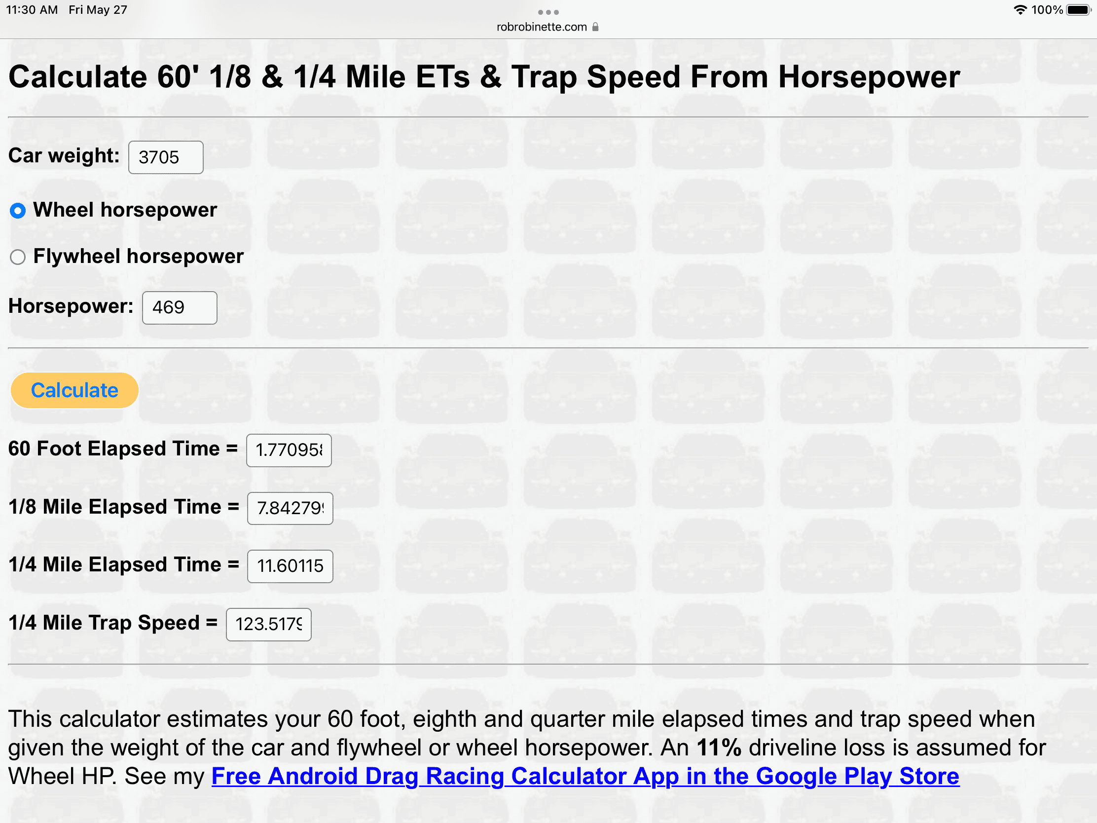

Now let’s do the same thing with my car and add in 11%, to arrive at crank hp numbers based on my Dyno criteria which was, the car spun the roller to 469 rwhp. That would mean that my car would make 520.59 hp at the crank.

With the mods I have done to the car, I was hoping for at least 11.40s - 11.50s on motor and 10.30s - 10.40s on nitrous.
Lastly, let’s I put that information for both cars into a 1/4 mile calculator based on the factory curb weight of 3705 lbs.
Factory Bullitt 1/4 Calculator estimate
My modified Bullitt 1/4 mile Calculator estimate
