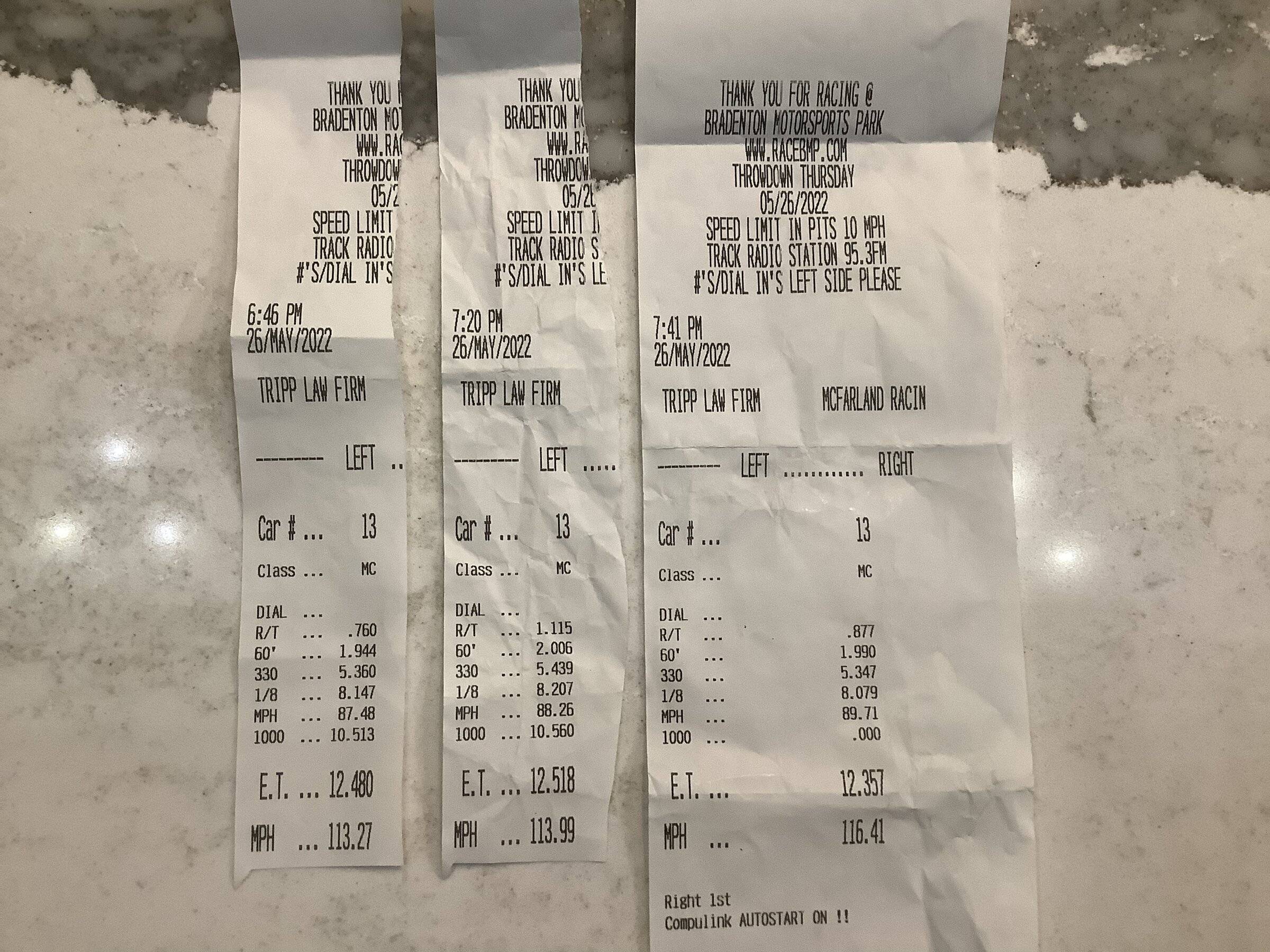

Okay folks, I’m back from the track and let me be the first to say, that it was exactly the opposite of what I had hoped for. There were several things that went wrong. Let me try and go in chronological order here, while being completely transparent.
Run #1 - The car hooked and the force on my body caused me to inadvertently pull the gear shift lever out of 1st gear and into neutral. Needless to say, the run was botched.
Run #2 - Launching issue (my error). I did not press the trigger button for my Hitmaster 1st stage launch, as the indicator light on the dash was illuminating when I pressed the clutch in. I was thinking this was a good thing, as I wouldn’t have to hold the trigger button and shift knob at the same time (one less thing to do). This resulted in a sloppy 12.50 pass at 115 mph. I returned to the pits and began analyzing things. I looked under the driver’s seat at the two digital timers for the Hitmaster and noticed that only the shift timer was counting down and triggering the indicator light on the dash. It was at that moment that I realized, I needed revert back to pressing the 1st stage trigger button and releasing it and the clutch at the same time. It was also during this time, that my buddy asked me what rpm I was launching at and I told him 7400 (I wasn’t looking at the tach, but rather going off of what I though I had set the 2 step launch rpm at on the WOT Box a month or so prior). Well, a quick test of the 2 step revealed that it was set at 5K rpm and not 7400.
Run #3 - Not captured on video, but it was a 12.40 pass at 111 mph.
Run #4 - I adjusted the Hitmaster 1st stage valve and launched. It felt pretty good (a very smooth launch with some spin, but nothing too crazy) and then I miraculously went from 1st to 4th gear and the run was botched. I decided to call it a night after that.
Here is the checklist that I created and mostly adhered to for all but one pass.
Prelaunch checklist
  1. Turn off TC and Adv. Trac
  2. Pull into water box
  3. Dump clutch and dust off tires (stopping short of staging beams)
  4. Arm Hitmaster
  5. Pre-stage, wait for opponent and stage
  6. Grab and press 1st stage trigger button with right hand
  7. Depress clutch, put car on 2 step and release clutch and trigger button
  8. Successful launch (provided all the above went well)
Here is a demo video of steps 6 & 7. You can only see my right hand pressing/releasing the Hitmaster trigger switch, but I am also releasing clutch pedal at the same time.
The moral of the story is, I F’d up and didn’t do some things right and it showed. I’ll take some time to carefully go over the WOT Box programming with my laptop and make sure everything is set right before the next outing. Lastly, while this was not what I had hoped for, there were several lessons learned and therefore, I don’t consider tonight’s track visit a failure. It’s just going to take some time, but I’ll improve with time.

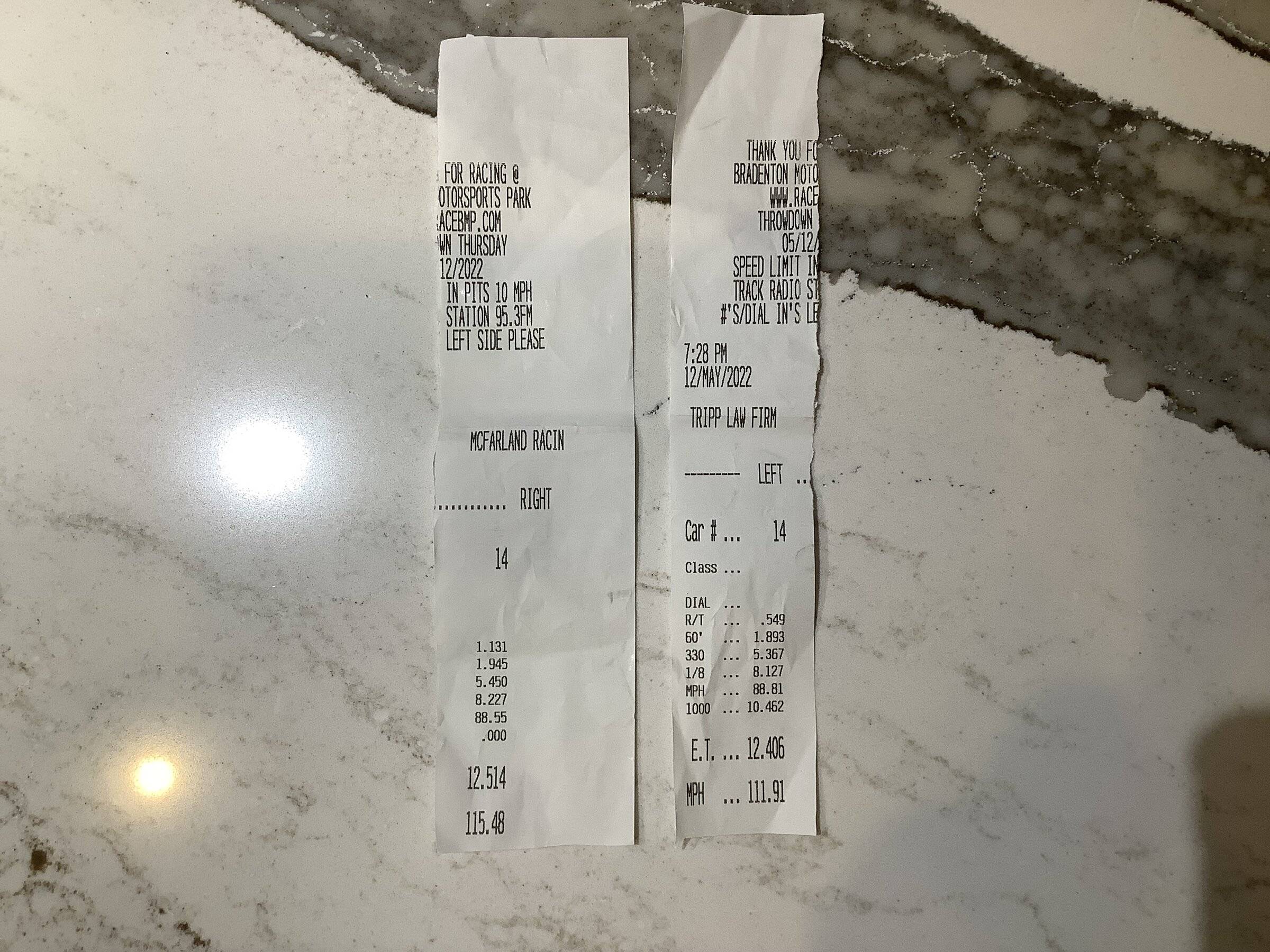

I was able to make it back to the track for the second time yesterday and the car didn’t impress me at all. I ran a 12.40 and 12.50 pass @ 113 (trapping in 4th) and one 12.30 pass @ 116 (trapping in 3rd). I’m still having trouble with the car and don’t know what to do to make it perform better, or as it should for the mods that it has. I thought I had made the proper adjustment to the Hitmaster after the last outing because during testing with the key on and ignition off, when I released the trigger button, the clutch would dwell at 2/3 pedal travel before releasing the remainder of the way, after the launch timer timed out, which is what the manufacturer said it is supposed to do. I should also,add that I had reached out to the owner of the company for setup assistance after the first outing (emailed him time slips, videos of the runs, a detailed explanation of the Hitmaster’s adjustments at the time and how the car performed, as well as several questions), but his responses were very vague. This left me feeling like I would be all alone in figuring out the proper setup.
Additional notes: When I put the car on the track yesterday, the clutch felt like it was slipping each time I made a pass. I sounded Like I was fanning the clutch and I wasn’t doing that at all. I also got locked out on the 1-2 shift during three other attempted passes.
I really feel like my the clutch may be on it’s way out. However, during the drive home from the track, everything seemed normal, but I wasn’t doing any testing with high rpm launches or shifts either. I really wish I could have at least figured out how to properly set up the Hitmaster (before experiencing potential clutch issues), which I do feel has attributed to my troubles. As it stands now, I’m going to pull the drag wheels, put the factory wheels back on and baby the car on the factory clutch, while I regroup and decide which direction to go from here. I don’t know if that will be installing a new clutch only, or possibly a tranny upgrade. Either way, I’m super frustrated after working on the car for the past 22 months and getting less than favorable results out of it, especially with all of the money and effort involved here.

You need to launch higher , a little (little lol) wheel spin is good for N/A motor . With a 1.9-2.0 60ft you must be bogging the motor down. That will kill ET and MPH.
