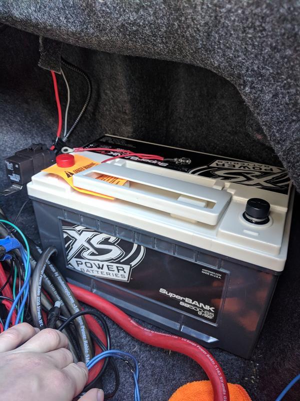

    Haven't updated this thread in awhile. Pulled out the rear D3100 battery to save on weight. Replaced it with a 500 farad XS supercap bank. Saved 80lbs!
    Voltage drop.... Rests at ~14.7V
    D3100 battery: 13.5V
    Supercap: 14.1V
    Neither: 10.8V
    Needless to say I'm impressed.
