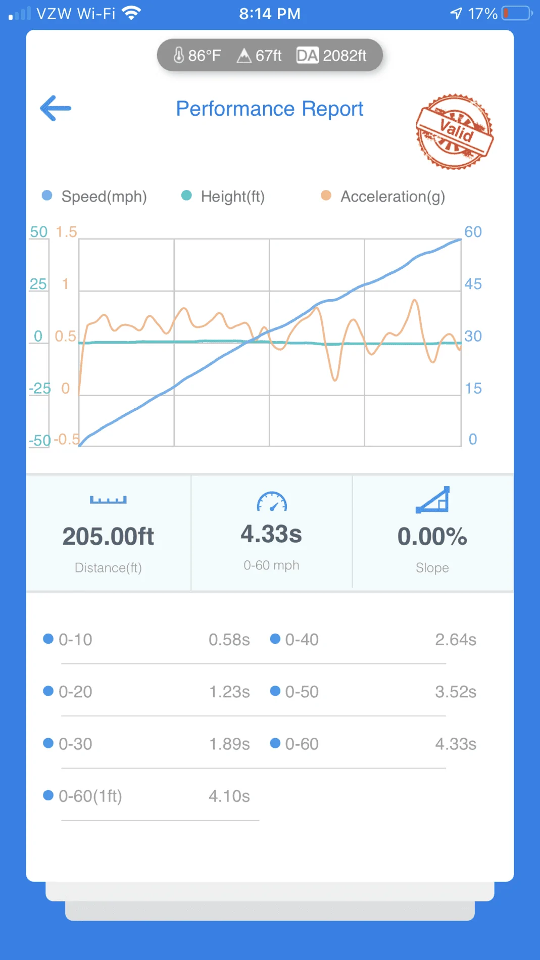

I did this today at the track, 2020 PP1 with just a tune. It’s been faster with slightly better air but I didn’t have the dragy at that time.

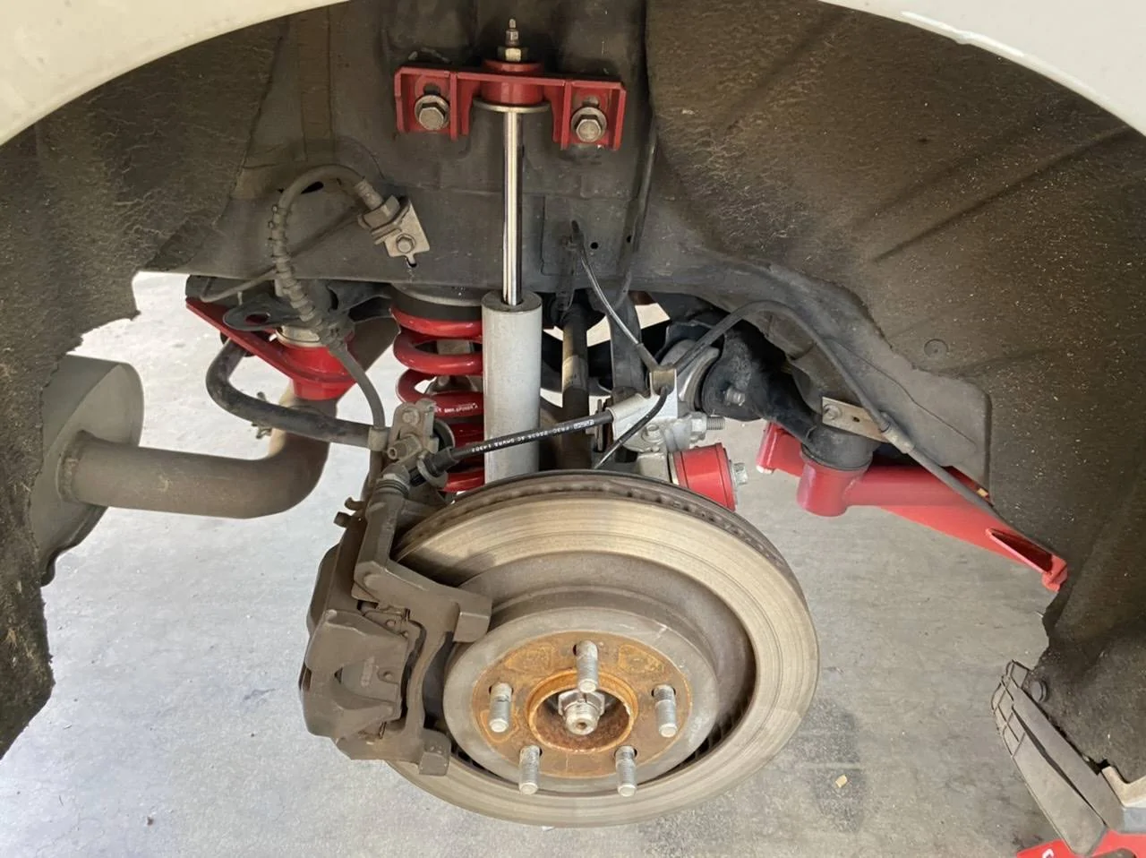

I have (almost) full BMR Suspension on my 2015 GT PP. MT82 car. Just intake, exhaust and 91 tune. 5200ft elevation.
BMR Drag Springs
BK081 (LCA Bearing)
CB005
CB762
TCA048 (Poly vertical link)
Shock mounts (J+M)
FP Toe link bearing
RTR shocks/struts (Kony yellow rebrand)
Steeda centering dowels in the rear
Steeda trans bushings
GT350 half shafts
BMR drag spec alignment (maxed out at -.6° camber)
Nitto NT555g2 295/35/20 on 10.5x20s.
On the street (Dragy) consistently runs 2.35-2.4 60ft, 3-4K rpm. Track mode, advance trac both on or off. 27-34psi, doesn’t seem to matter.
0-60 times always about 5.6s.
Went to the drag strip once with everything but the LCA Bearing installed. 2.25 60 foot, 13.5s @ 106.5mph. Replaced the rear wheel bearings after this… believe it or not, they were shot and causing a significant amount of wheel hop.
Interested to hit the strip again with the LCA bearings in… but I can’t, for the life of me, figure out why the 60 foot and 0-60 are so slow on a car with full suspension. I know the altitude has a big effect, but it shouldn’t affect the 60 foot and 0-60 THAT much…

Are you getting alot of wheel spin though? The 555g2 cannot hook for anything. Look into their 555r2 and its a night and day difference.

Very little with 295 555r2’s. Swapped into a set of 315 NTO5R’s I had, same deal. No decrease in time. See dragy footage. (Engine was hot… 5.99 0-60. Very consistent with that 2.38 60 foot time, though)
I’m pretty close to stock power… just a Catback and tune (91, yuck). Probably about the same as stock on 93.
