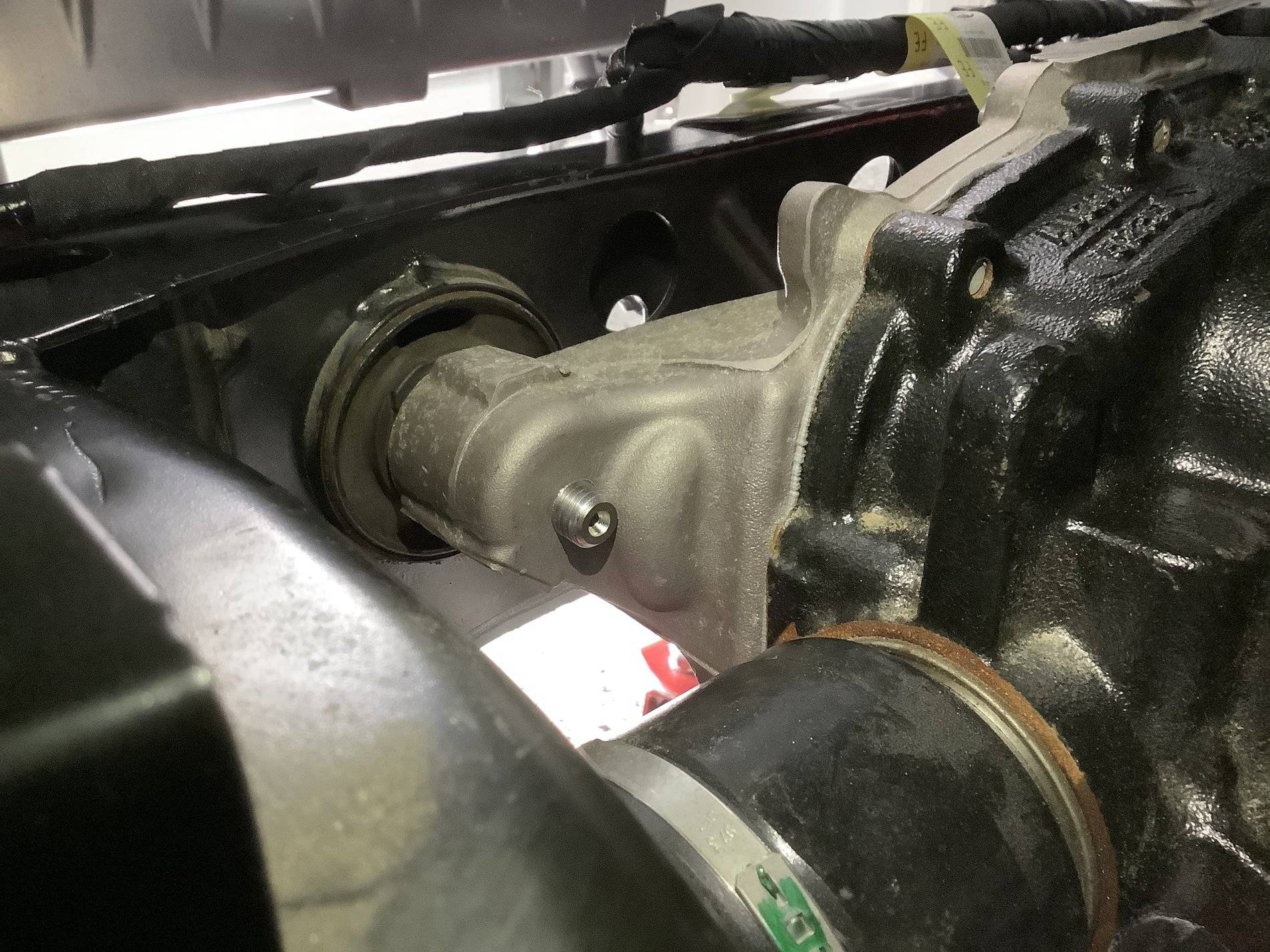

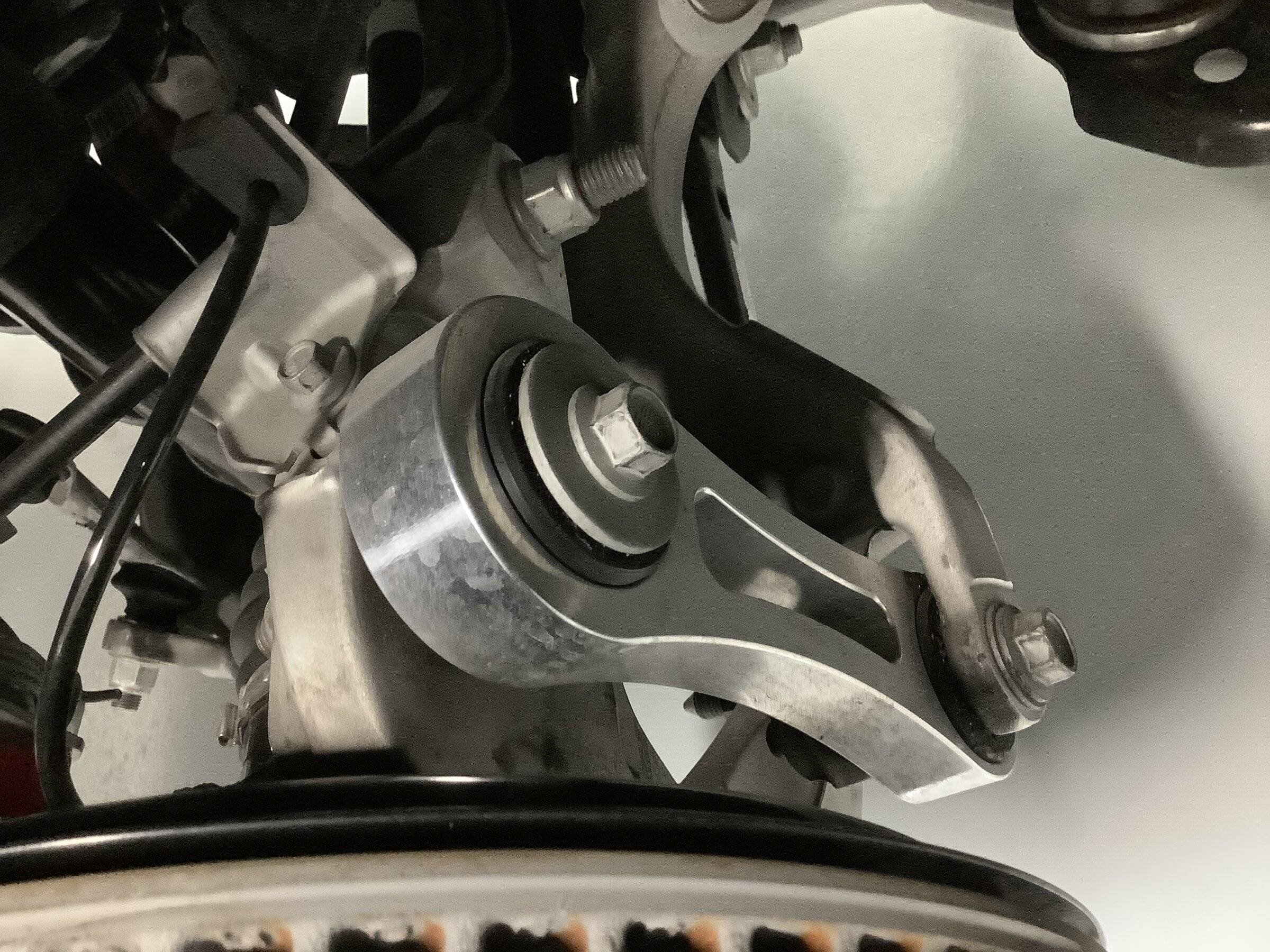

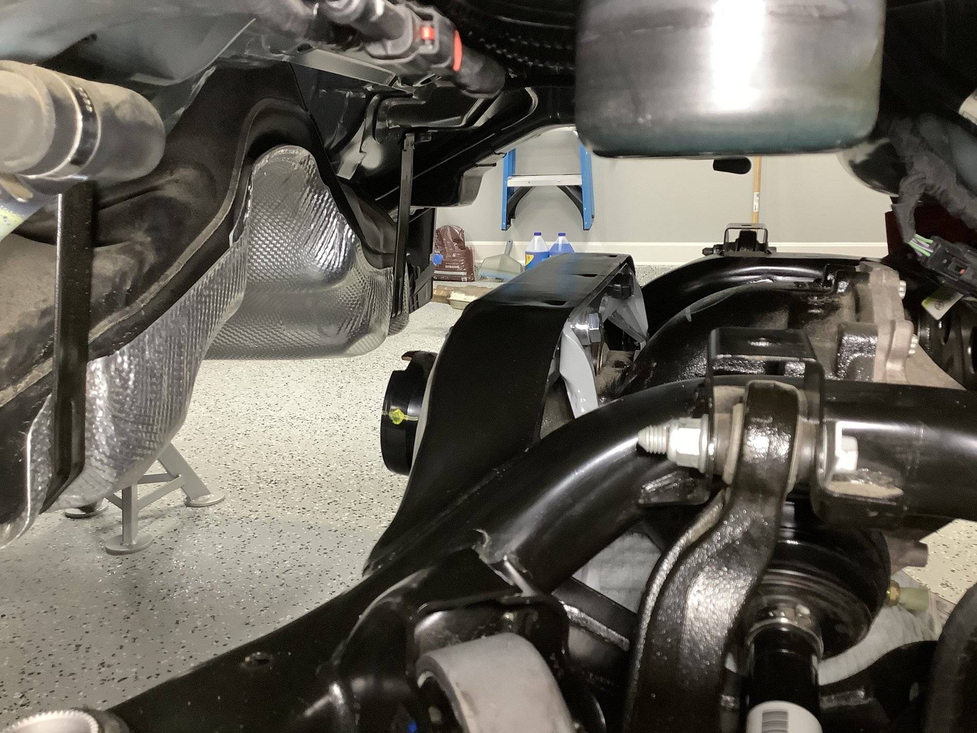

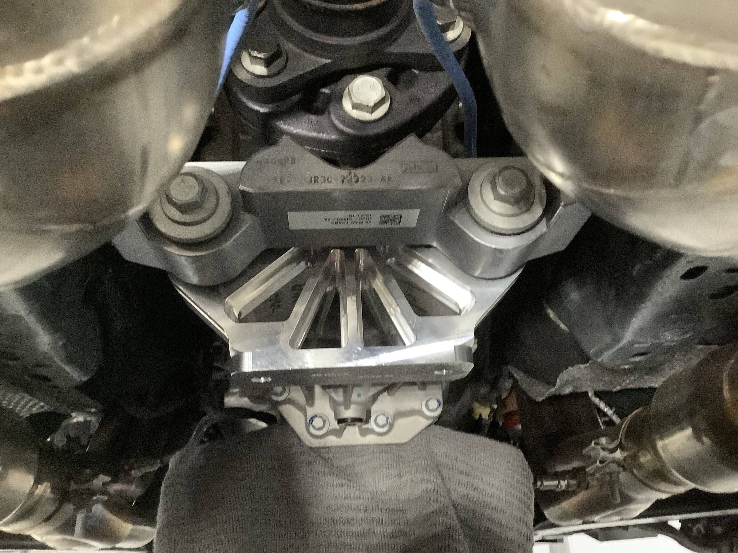

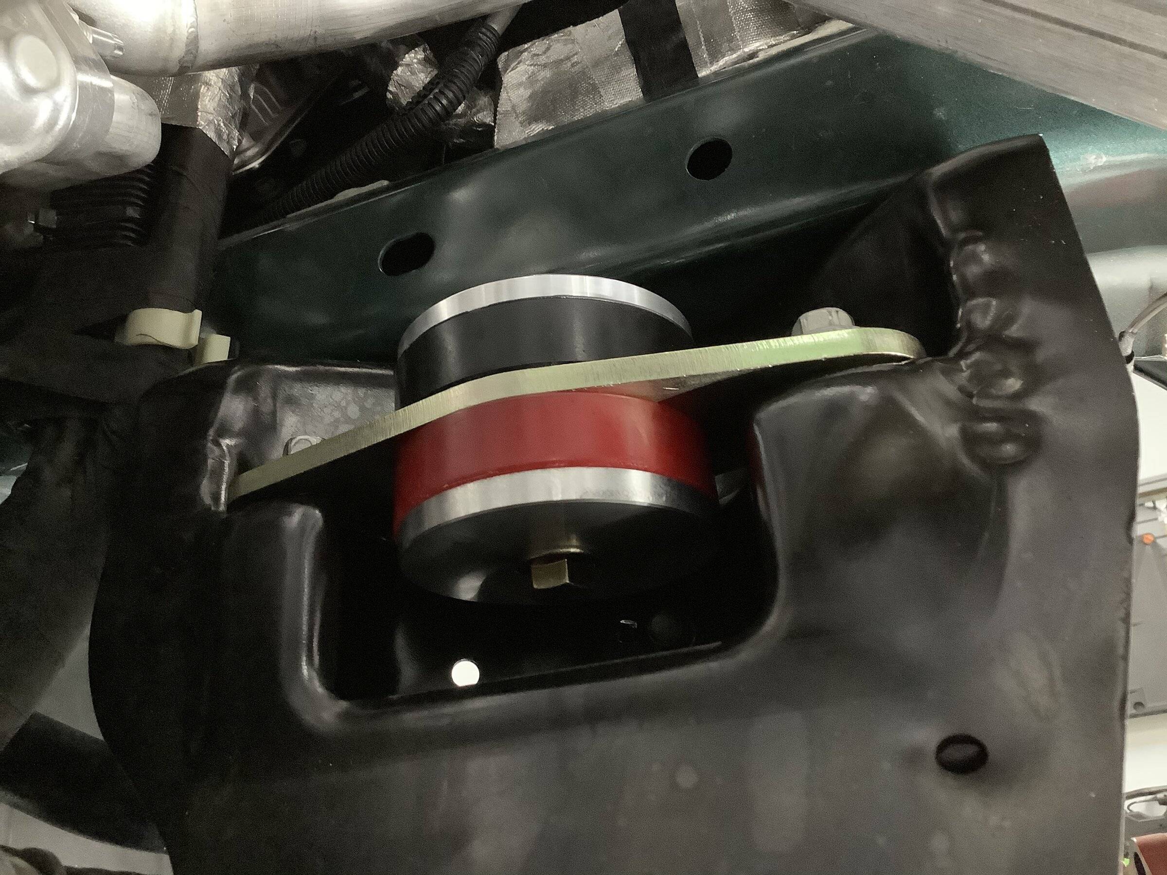

Have a look here to see just how bad wheel hop is on the S550 platform.

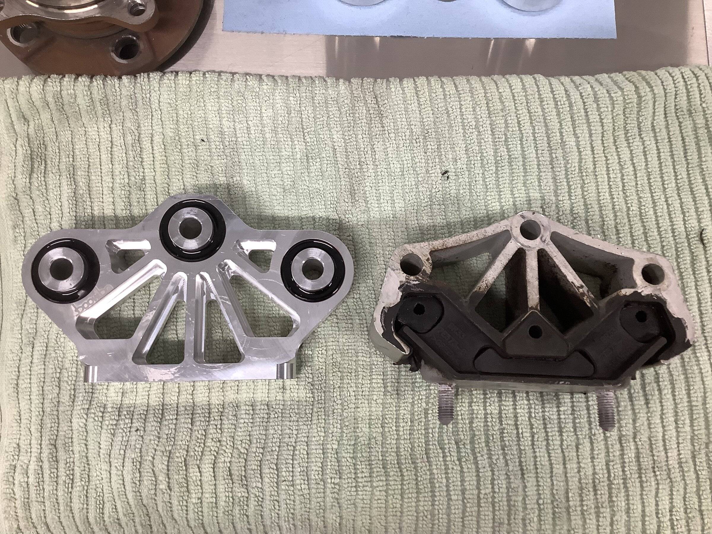

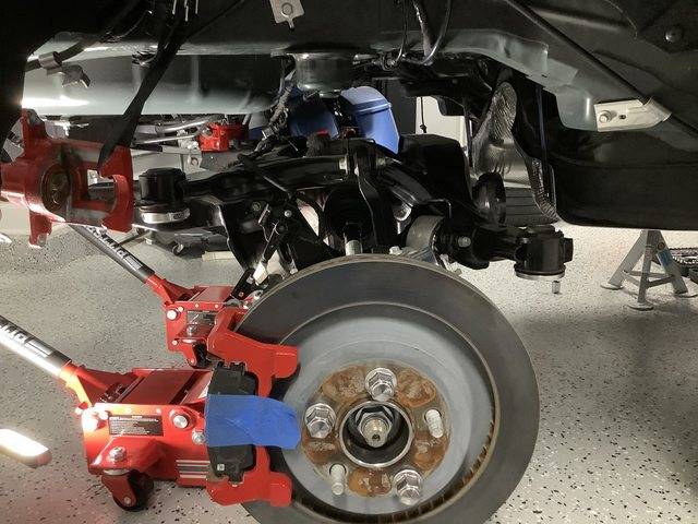

I’ve installed the following suspension and drivetrain related parts on my Bullittt to help it perform the best that it can on the street and strip:
- Steeda differential bracket (hardcore part which required completely removing the entire IRS assembly from the car)
- Steeda subframe braces
- Steeda subframe bushing support kit
- Steeda subframe alignment kit
- Steeda differential bushing kit (black bushings) with through bolt kit
- Steeda Billet aluminum vertical links (with delrin bushings)
- Steeda RLCA spherical bearings (PITA mod, but I’m sure glad I did it!)
- Steeda adjustable camber links
- Steeda adjustable toe links
- BMR camber lockout kit
- Steeda adjustable motor mounts
- Steeda driveshaft safety loop
- Boomba Racing race transmission crossmember bracket
- Ford Performance half shafts
I think this is as far as I can go with suspension mods, as my car is a magneride car and I’m not willing to get away from that, nor do I wish to lower it and risk scraping a very expensive set of LTHs.
