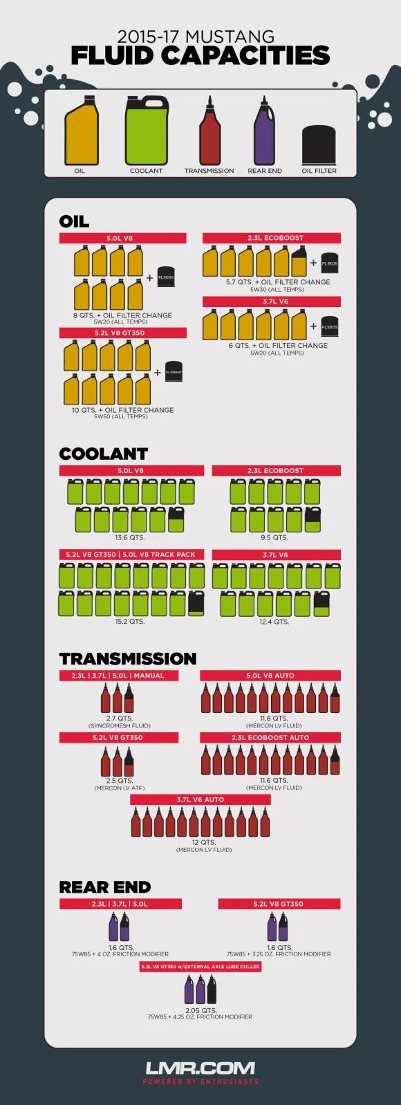

Does anyone know exactly how much fluid to put in both the manual trannny and rear end? Should I fill up until it reaches the fill hole?
