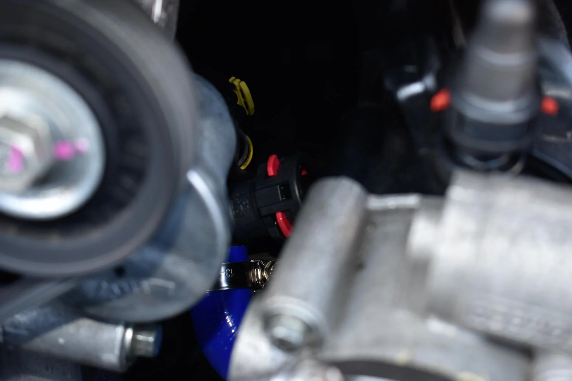

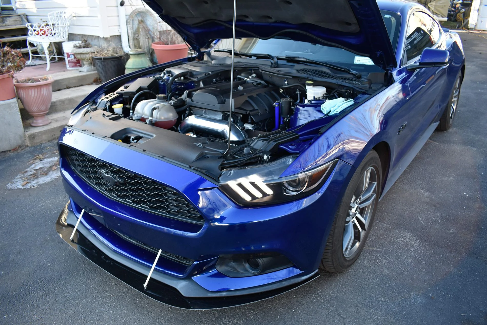

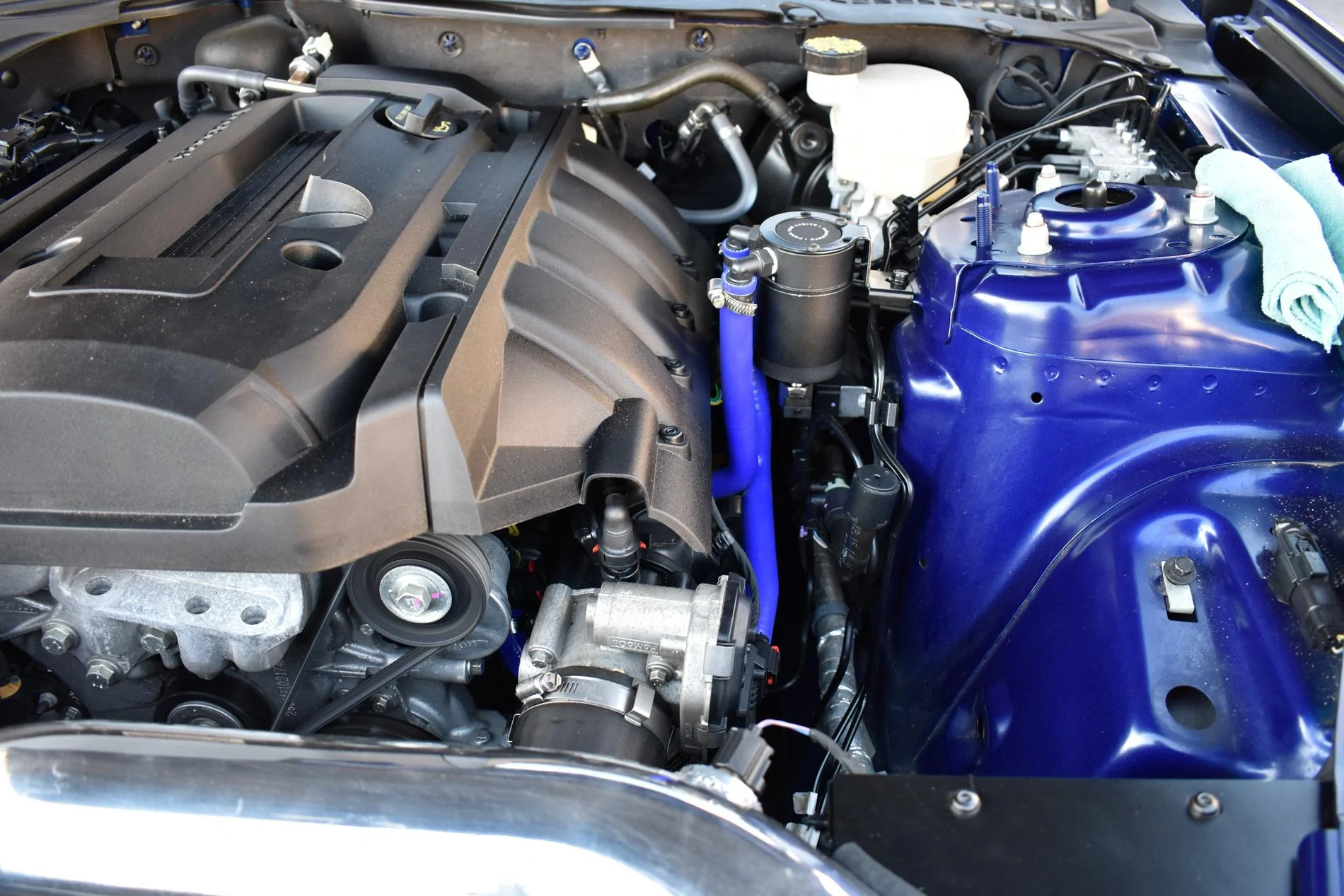

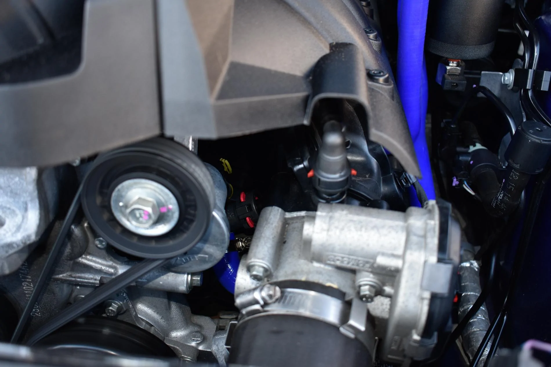

Hi every one today i installed the mishimoto catch can on my 2015 ecoboost mustang the install took aprox 30 minutes. the hardest part of the install is geting the stock exap line off because the clips that hold it in are a pain to get off, next i installed the new lines ( i got the blue lines to match my stang ), i put a shot of wd-40 inside and around the connection to aid in installation, it is important to note that the clips will only allow you to lock them when they are pushed all the way on, next the can installs on the strut tower and thats it your done! i chose the mishimoto because it was the only one i found that has a baffle and uses a bronze filter like used in air compressor water separators
