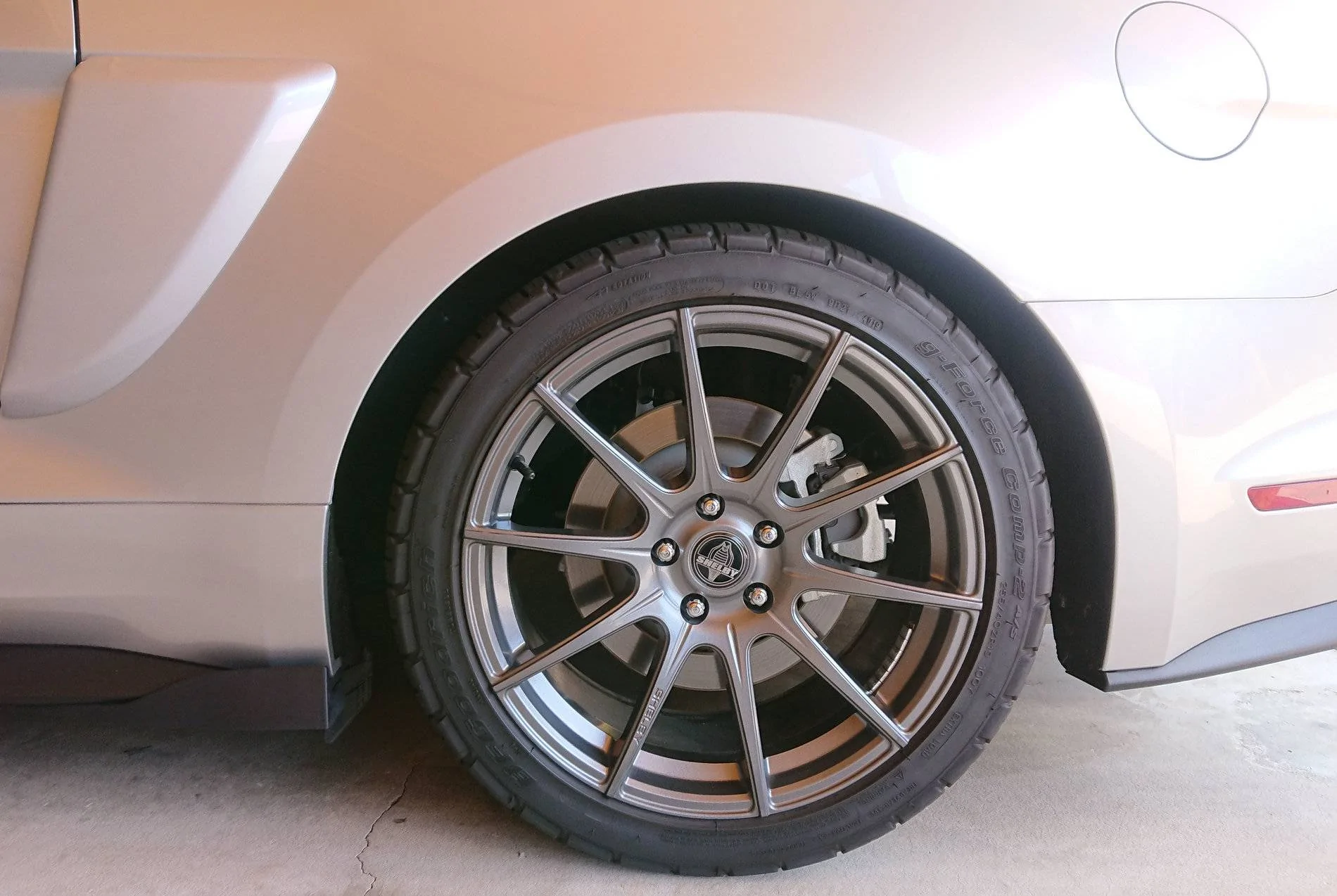

I have the Steeda Minimum Drop Springs with FP track shock/strut kit. I really like it and have no issues. I run square 255/40/19 AS tires though with ET 35 19x9 (Stock Engine)

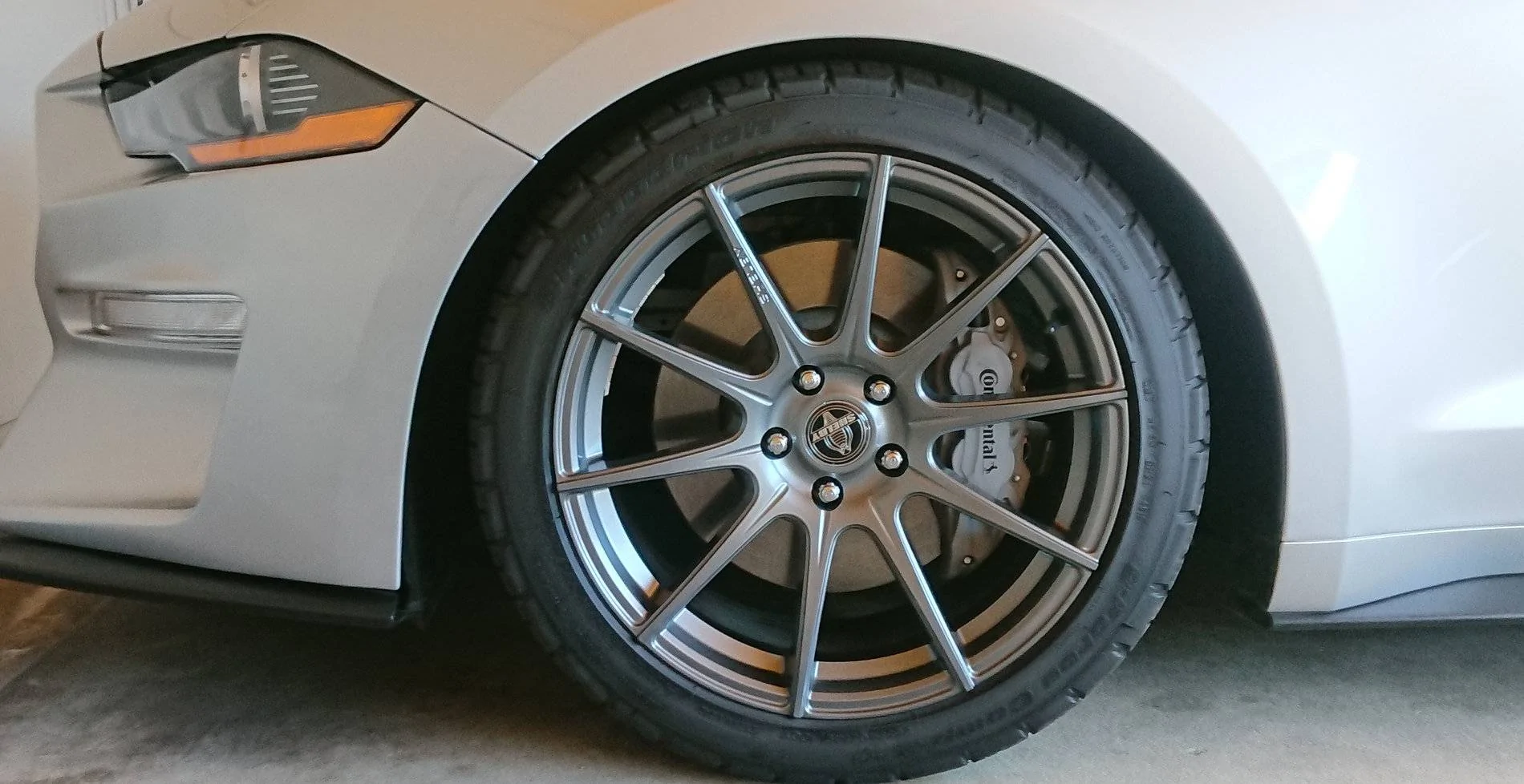

I have the Steeda Minimum Drop Springs with FP track shock/strut kit. I really like it and have no issues, kinda old photo, still had the stock 255/40/19 PZero tires, switched to beefier BFG
How's the ride on bad/city streets compared to stock susp.?
Less bouncy, sure might feel road grooves/bumps more but the car stays planted and level as it goes over those groves or bumps, not floaty like base GT stock did. I do not feel a harsh ride, just a sporty type, maybe would feel more harsh if higher spring rate and thicker sway bars perhaps?

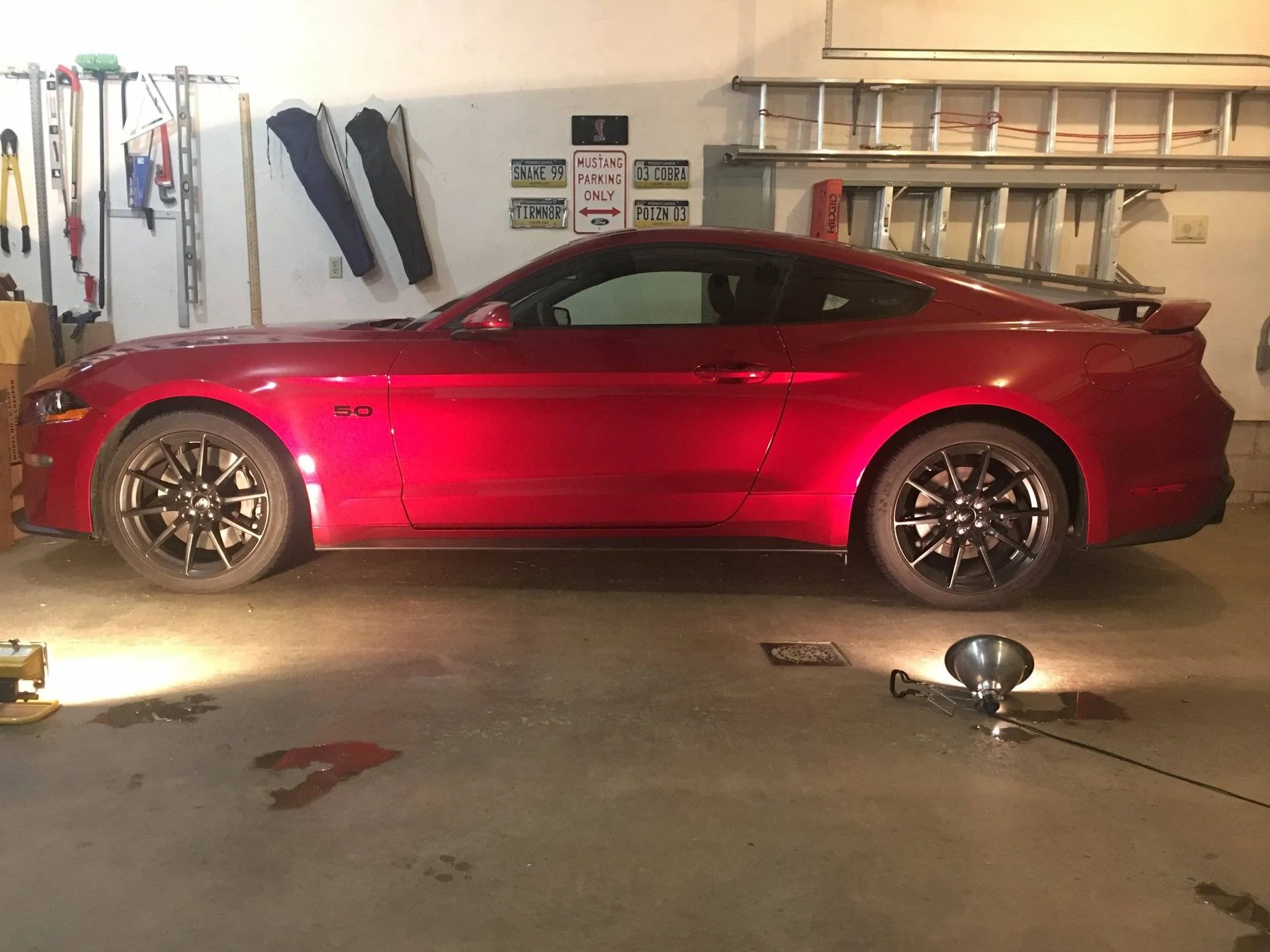

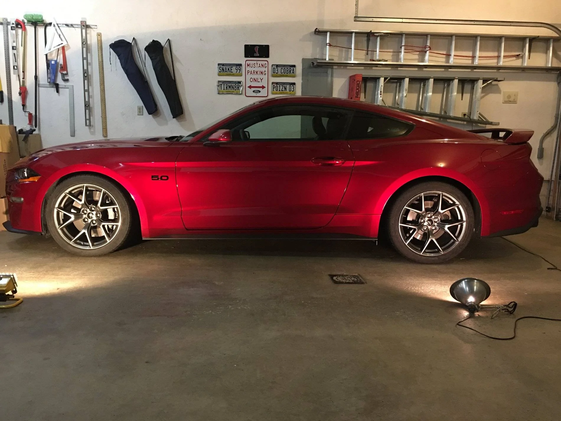

Well I installed the J&M min drop springs today and am not happy. The listing for them says "average drop 0.5 inches", but my front dropped 7/8" and rear 3/8". I think the front looks too low now, and am concerned about possibly having rubbing issues with the tires. Emailed them asking for advice on their website contact form. Wonder if I can just stack 3/8” of washers over each of the 3 studs under the mounting surface to raise the car up? Here are before and after pics...

I got the J&M springs and the shop that installed them didn't have any problems with them.
Did you measure before and after to see exactly how much front and rear drop you got?
