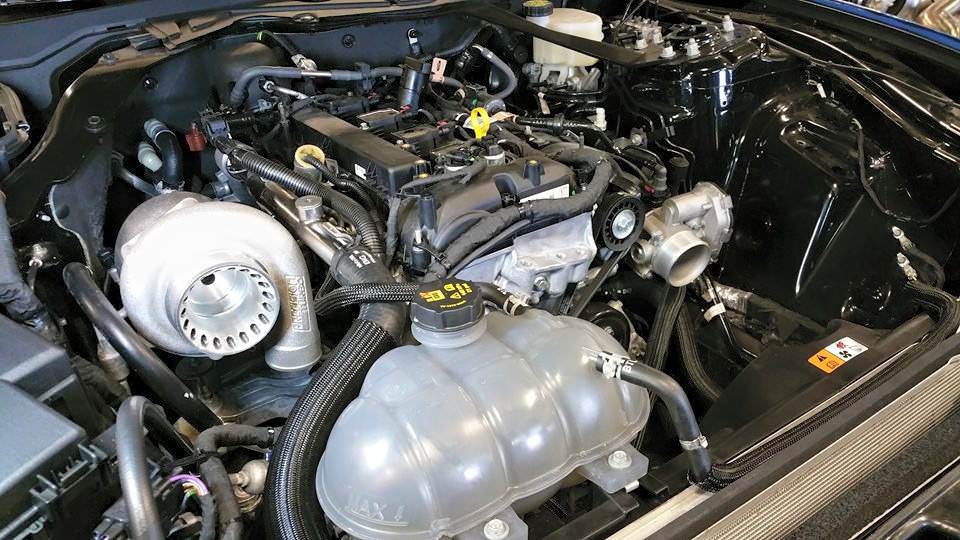

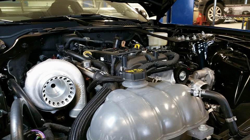

    On top of that, we are also one step closer to our turbo kit as well. Picture below shows or mock up Precision Ball Bearing 5858 CEA turbo on our R&D car. We are going with T3 standard scroll inlet, 4-bolt outlet, and Anti-Surge Ported Cover. Comp-gate 40 external wastegate will be utilized which will set us apart as most kits that are using internal wastegate.
    [​IMG]
    [​IMG]

  6. neodark
    neodark Left 4cyl @home
    First Name:
    George
    Vehicle(s):
    Ecoboost 201A
    Joined:
    Sep 3, 2014
    Location:
    Melbourne, FL.
    Posts:
    1,487
    Likes Received:
    233
    Rating:
    100%
    1   0   0
    You should really clean that engine, there's a snail in there. :thumbsup:

    0   0   0
    Will the stock intake and intercooler hoses match up with that turbo?
  15. OP
    MAPerformance
    MAPerformance Well-Known Member
    Gold Sponsor
    First Name:
    Sales
    Vehicle(s):
    2015 Ecoboost Base w/ Performance Package
    Joined:
    Jan 14, 2015
    Location:
    Cottage Grove, MN
    Posts:
    1,680
    Likes Received:
    997
    Rating:
    100%
    1   0   0
    Stock intake would be impossible, we will be seeing what modifications need to be done to our intake to make it work. The more we develop this the more it is going to look like an inclusive kit that will include intake, downpipe (if you have our downpipe it will connect to the v-band at the adapter), External Wastegate, passenger charge pipe with BOV, oil lines, and coolant lines.
    It will utilize the stock intercooler, our intercooler, and any aftermarket intercooler that has the the inlet/outlet in the factory locations.
