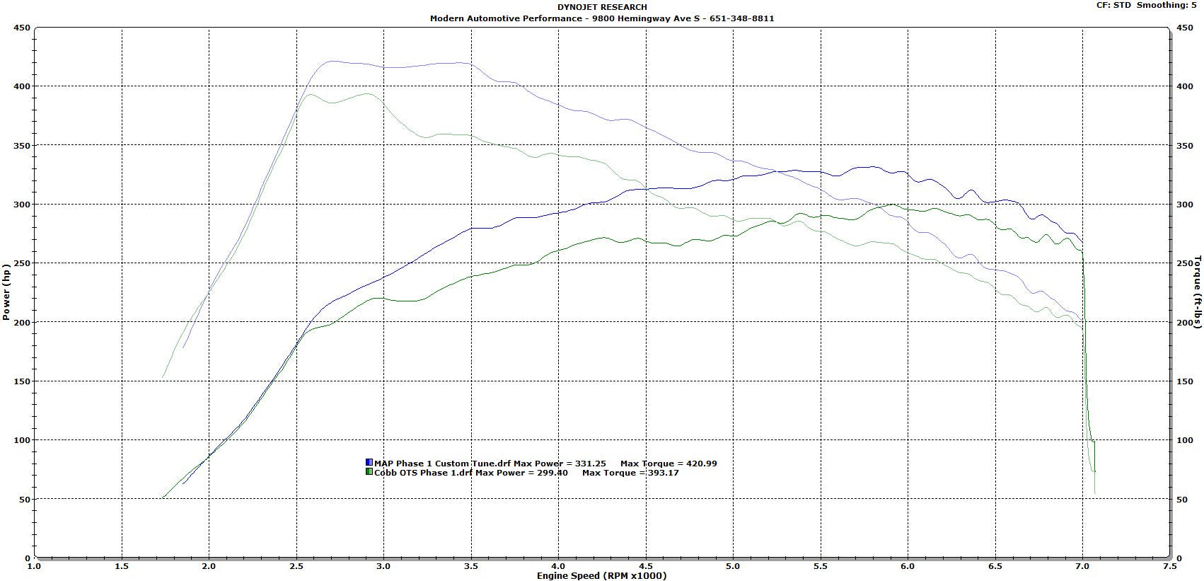

    Full Phase 1 tune is available now, which is MAPerformance Intake, Downpipe, Catback. 100% Stock EBM tune will be available early next week. Tunes for customers running just MAP downpipe will be available next week as well. Anybody that purchased an AP from us and purchased another intake, downpipe, or exhaust we will have something for you as well so please feel free to email as well!
    Here is full Phase 1 package dyno graphs. By itself, vs Cobb OTS and compared against stock. Below that will be the boost and afr plot to show how we were able to smooth out the boost curve vs the Cobb OTS tune. All runs were done on 93 octane with the factory intercooler piping and diverter valve.
    Phase 1 with MAP Custom Tune
    [​IMG]
    Phase 1 with MAP Custom Tune vs Cobb OTS 93oct STG 1
    [​IMG]
    Phase 1 with MAP Custom Tune vs Stock
    [​IMG]

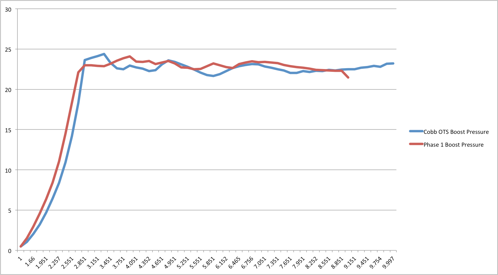

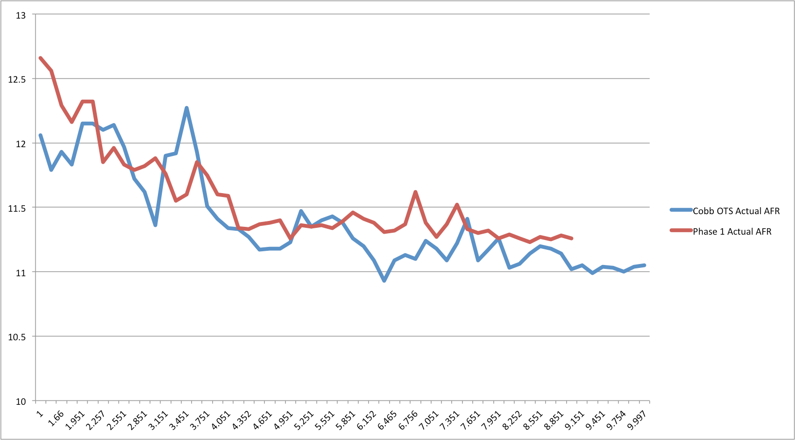

    Here are boost and AFR overlays between Phase 1 with MAP Custom tune vs Cobb OTS 93oct STG 1. These graphs were done with time as the X-Axis, if we used engine speed it would of looked like we cut our pull short. Time shows that our car reaches the end of the pull much faster as it is producing more power.
    [​IMG]
    [​IMG]
    As you can see our boost curve is much smoother than the OTS tune, and our AFR is also more stable through the pull. Not to mention a +76hp and +144tq gain over stock!
    MAP Tune Average AFR after peak boost: 11.43:1
    Cobb Tune Average AFR after peak boost: 11.26:1
    MAP Tune Average Boost after peak boost: 22.96psi
    Cobb Tune Average Boost after peak boost: 22.72psi

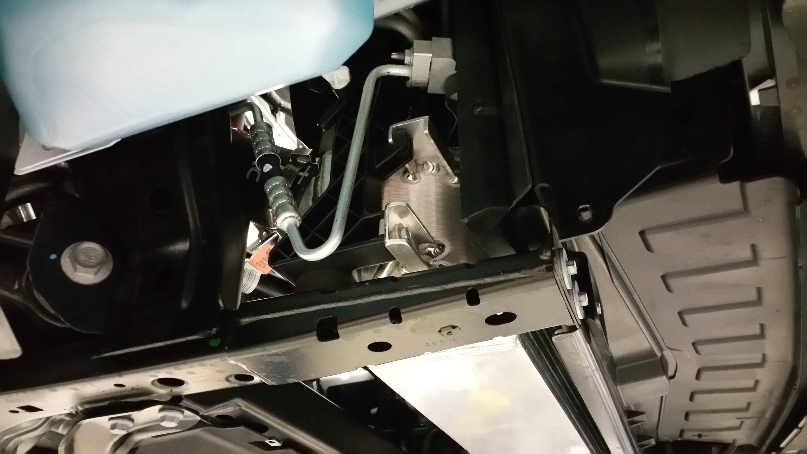

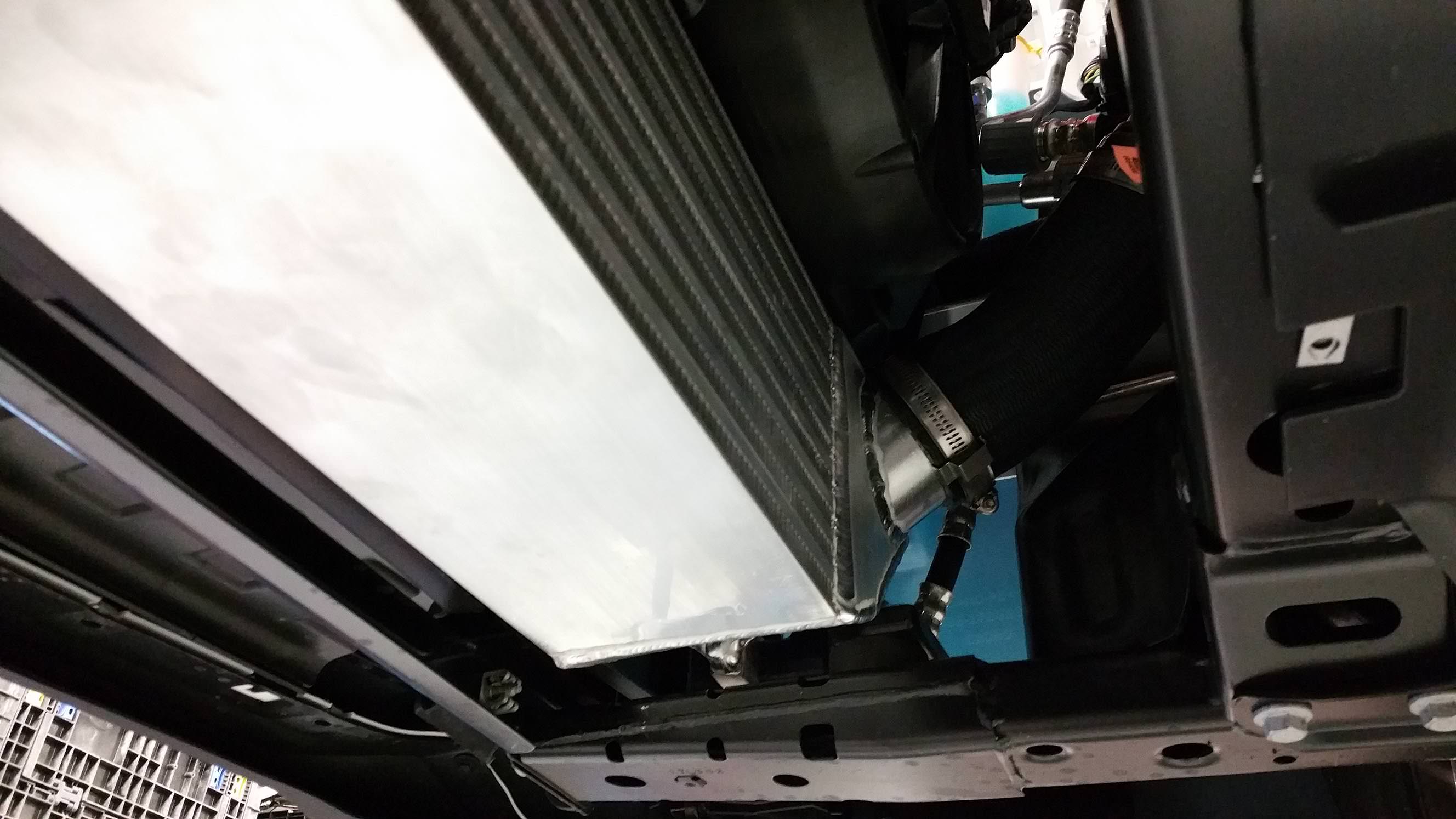

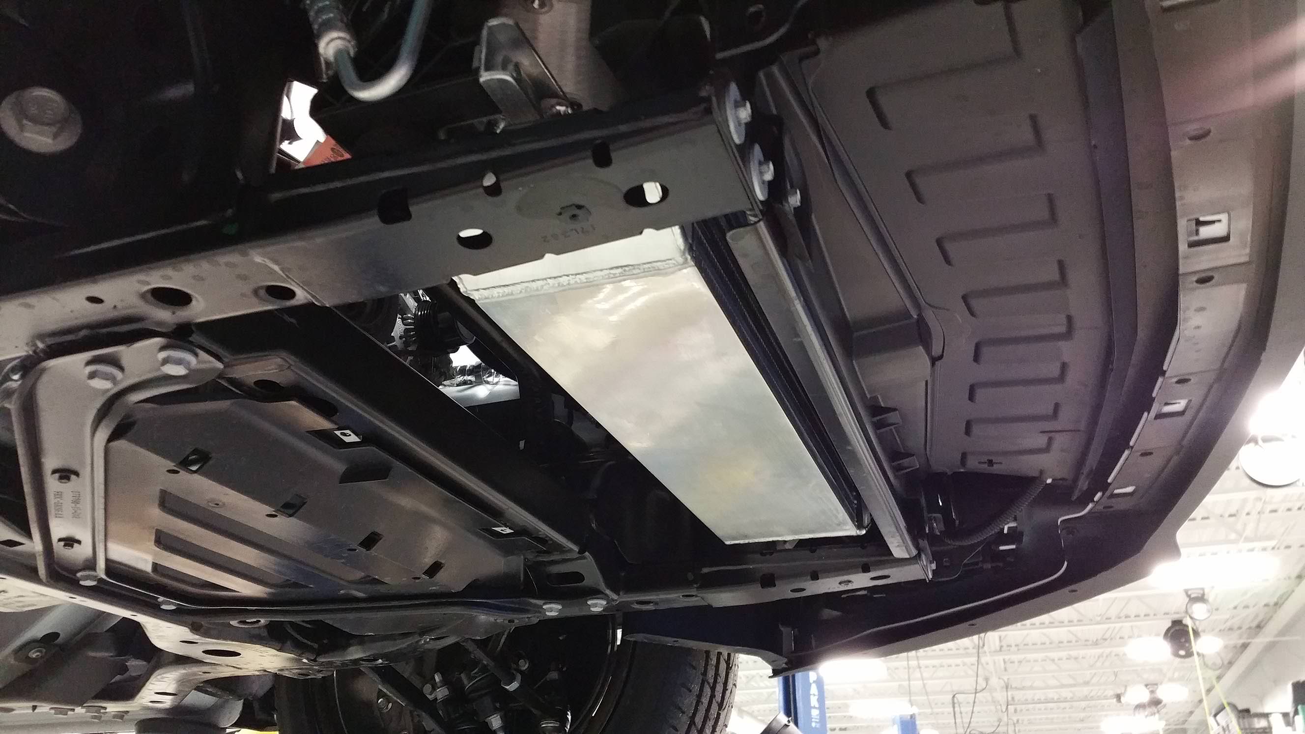

    On the previous page I posted a picture of our core for the intercooler we will be producing. Now our prototype endtanks have been fabricated and the intercooler has be installed on the car. We are planning on testing the intercooler this weekend or early next week. The first part of testing will be to make sure the intercooler core is efficient in cooling the extreme charge temps the EBM generates. Once we determine the cooling efficiency is up to par, we will finalize the end tanks. We will be looking into billet end tanks, or cast end tanks depending on which one wins the cost:effectiveness ratio.
    Here are some pictures I snapped last night of the intercooler fitted to 15SVO's EBM with stock intercooler piping.
    [​IMG]
    [​IMG]
    [​IMG]
    [​IMG]
    [​IMG]
    As testing is performed I will be updating the thread with pictures, graphs, and data. Hope to have another full update around Tuesday of next week!
    If you have any questions, please post up!

    Impressive set of gains! So that's what a bolt-on Ecoboost will look like. I believe those numbers are similar to the numbers Livernois had when they ran their 11s run. Any plans for a trip to the track?
