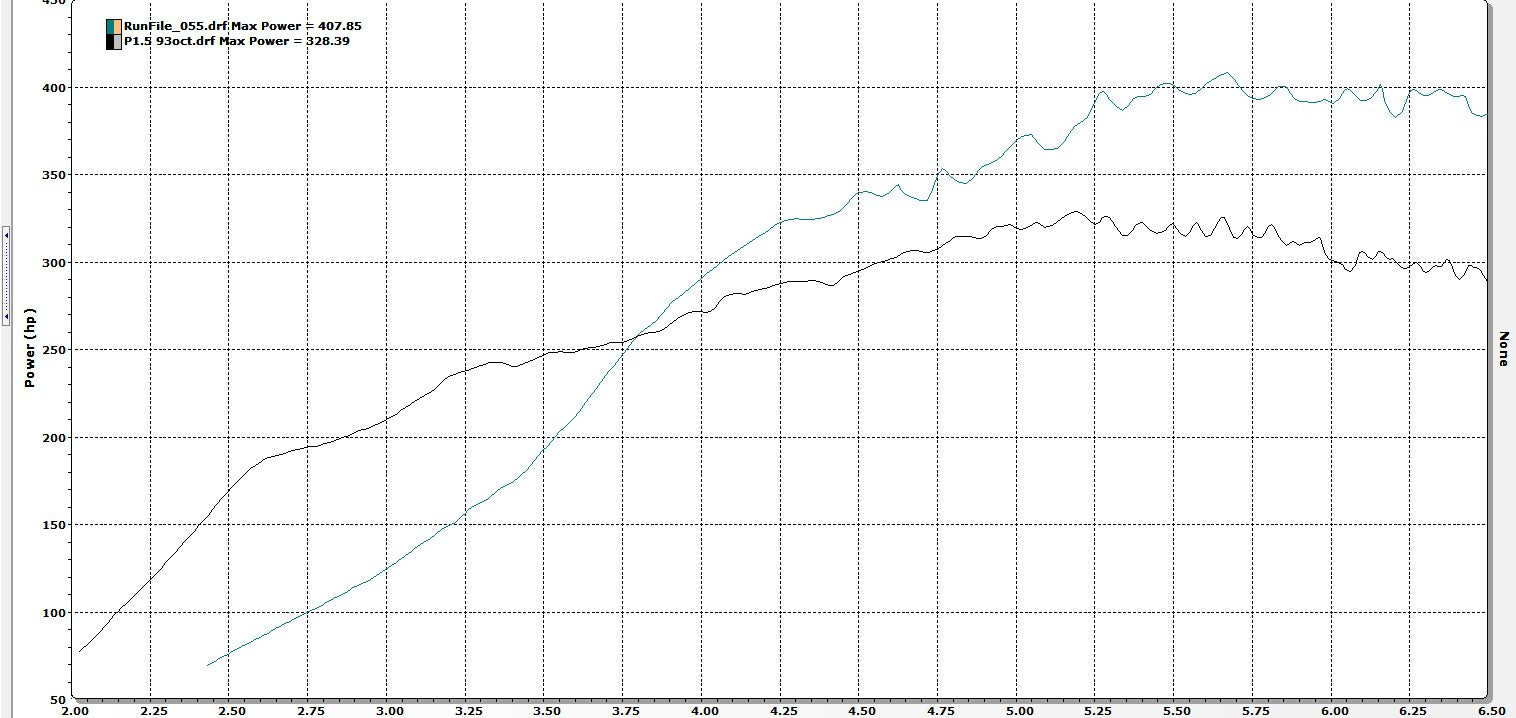

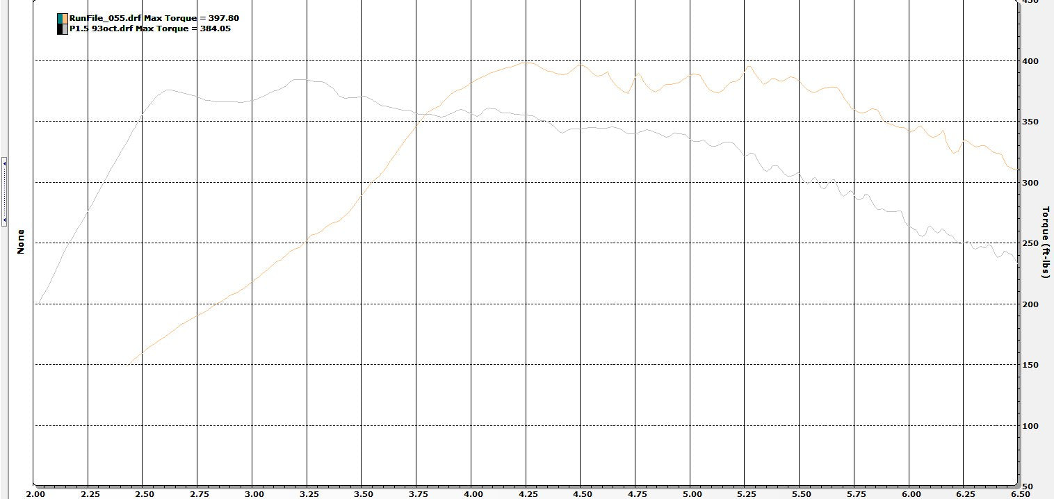

The torque is later because it is a bigger turbo that moves more air, so its going to take some time to get up to speed. The torque on the stock turbo hitting sooner doesn't mean anything in my opinion because it immediately drops off. The torque curve on the stock turbo is garbage, it's high peak torque number doesn't help in anyway.
With our turbo kit you can still use the cat-back and FMIC if you already purchased it. The kit will get you everything else!
idk, as I look at the graph, the TQ from stock AND bigger turbo start to drop off right away. Yes the bigger turbo has bigger numbers, but it still drops. However the graph shows the bigger turbo now has less usable RPM range. And for some reason the sharp drop in both HP and TQ starts sooner with the bigger turbo. I know you mentioned the rev limiter but why does it seem more limited, (sharp drop sooner), than the stock (stage1.5)setup? (again from what I see on the graph)
Just trying to understand some of it myself. I would prefer more instant off the line ooomph.
