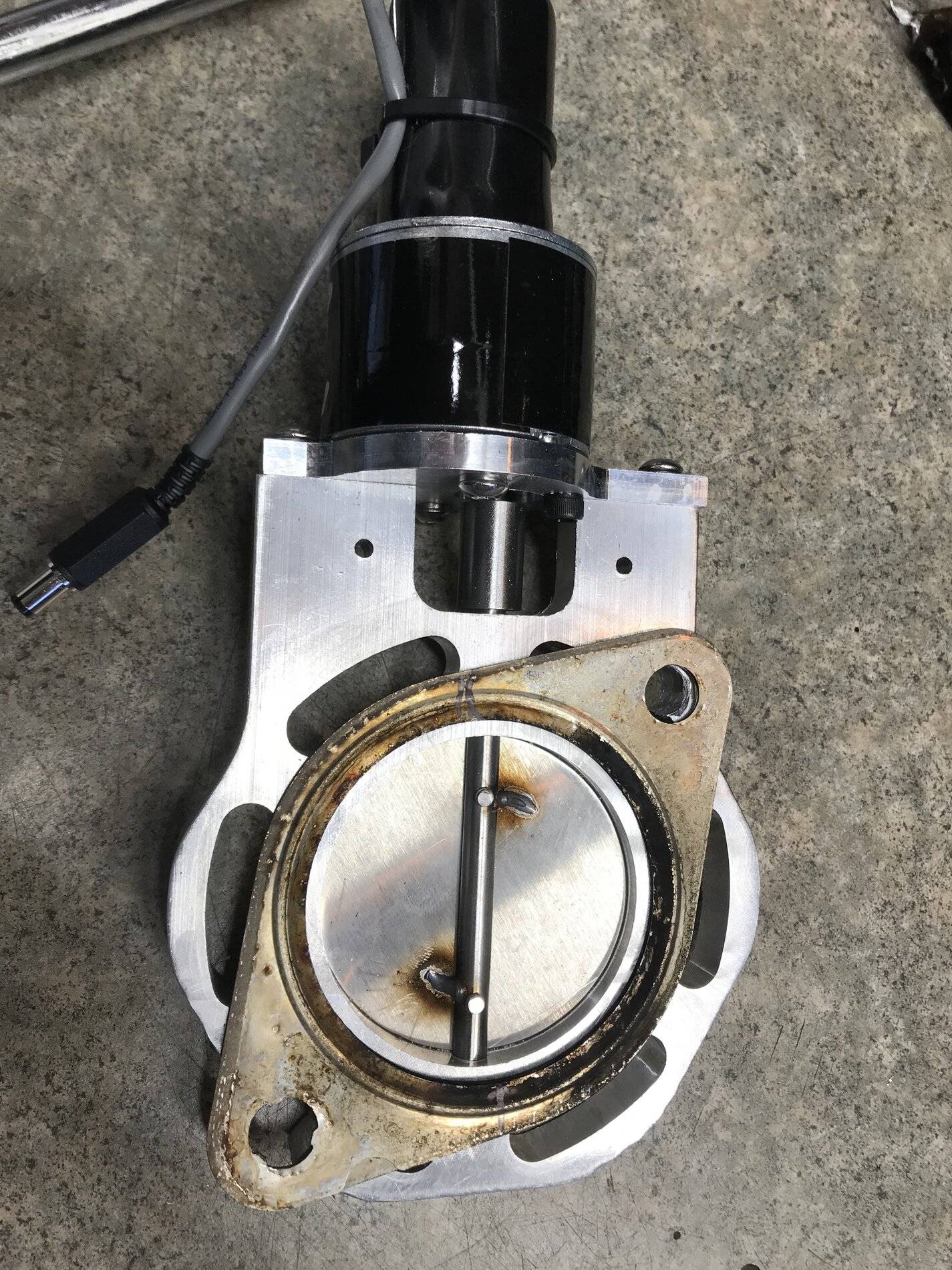

so ive already talked to them about it weeks ago. the center to center of the Roush 2 bolt flange is 4-1/8ish the pattern per Charles Gets president of badlanzHPE told me direct, the 2.5 diameter is 3 inch from center to center 3.0 is 3 3/8 3.5 is 3 7/8 so none of them would bolt to a 4-1/8 flange

Just checked my pics from when I did mine and you are correct. Around 4 1/8" center to center for the Roush flange. Well, that stinks.

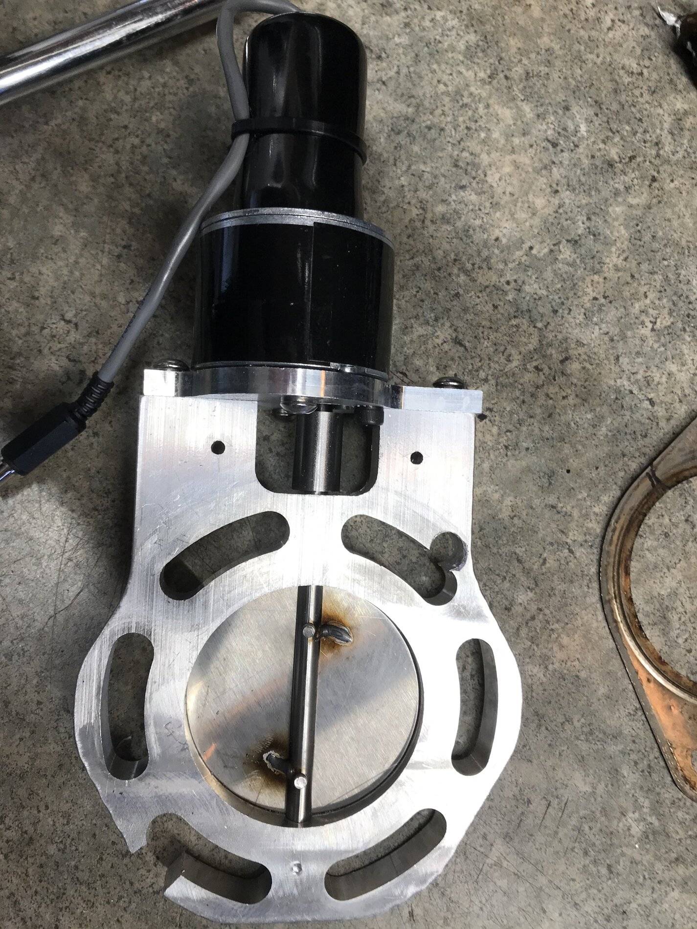

Ok I bought the 2 1/2 cutouts and drilled 2 new holes. I will say that the welding inside the pipe was rough and needed some grinding but they work great. Here are some picks of what I did.

Oh and mount them sideways and run the wire though the drain plug in the trunk so no drilling.

Looks good man! At least we know these CAN be used with mild modification.
