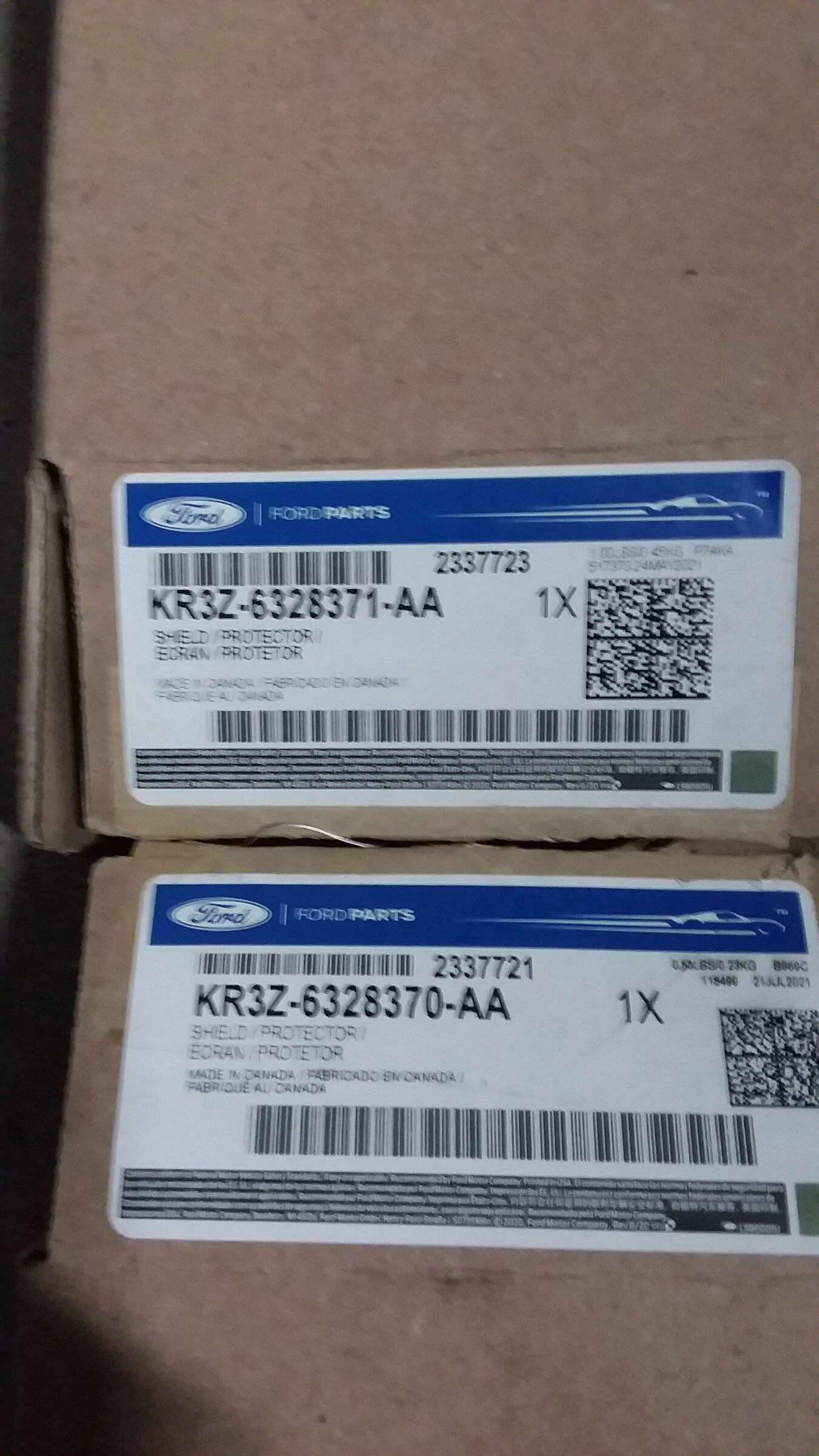

Also, the splash guards in the spread sheet are the GT500 ones which are different from the ones melwff is showing
Where in this thread did I show the full number?
I just looked at the Mach 1 tab and GT500 tab, they are the same on the spreadsheet and it looked correct.

A picture is worth ........
Sometimes there is a reason not to throw out the box.
