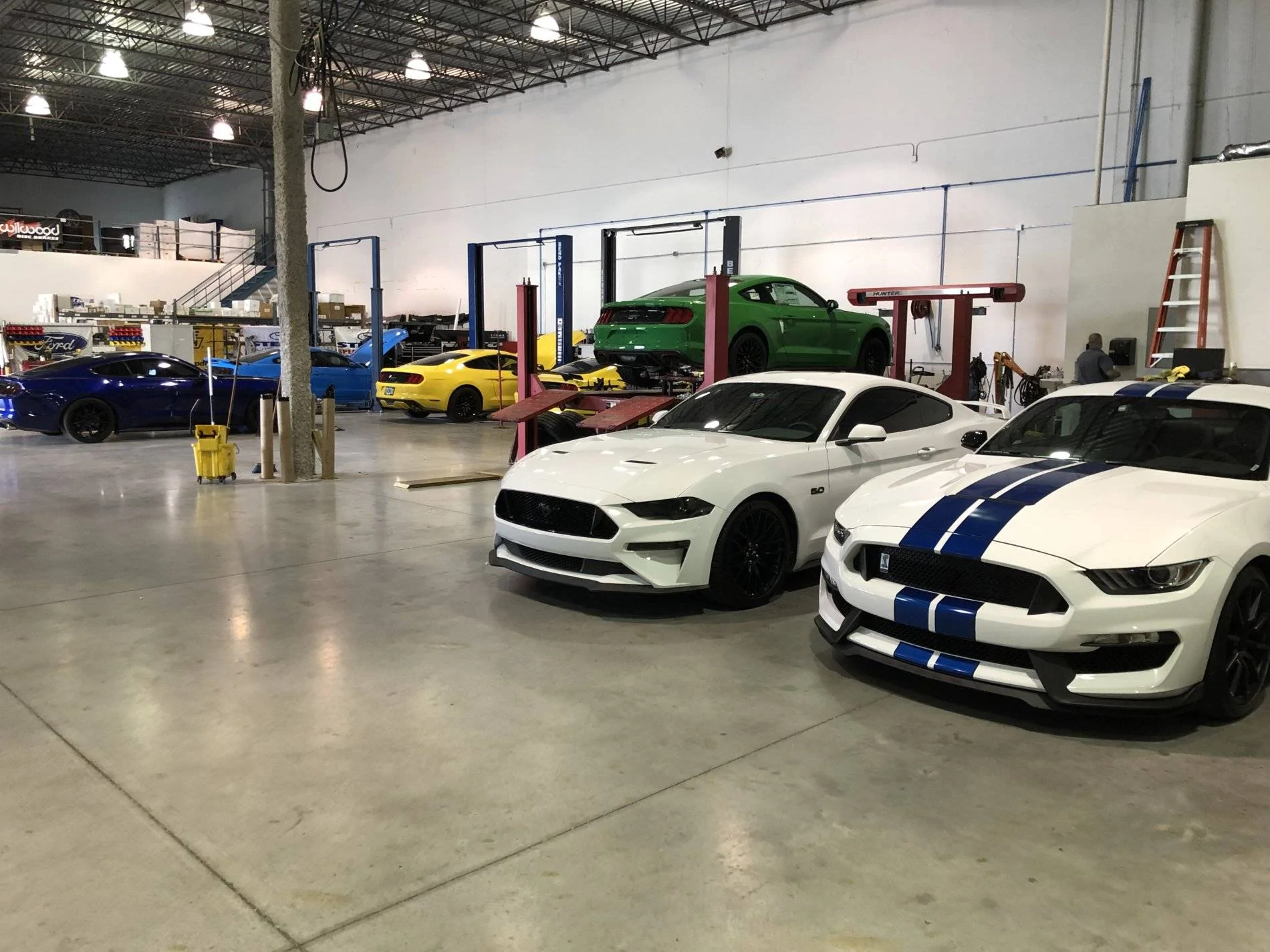

    Looking forward to meeting you Picture of our Pompano beach facility work shop area.
    Our senior tech has been with us for 32 years and our install tech 20 years. They know the S550.
    We will make sure your happy! Team Steeda.
