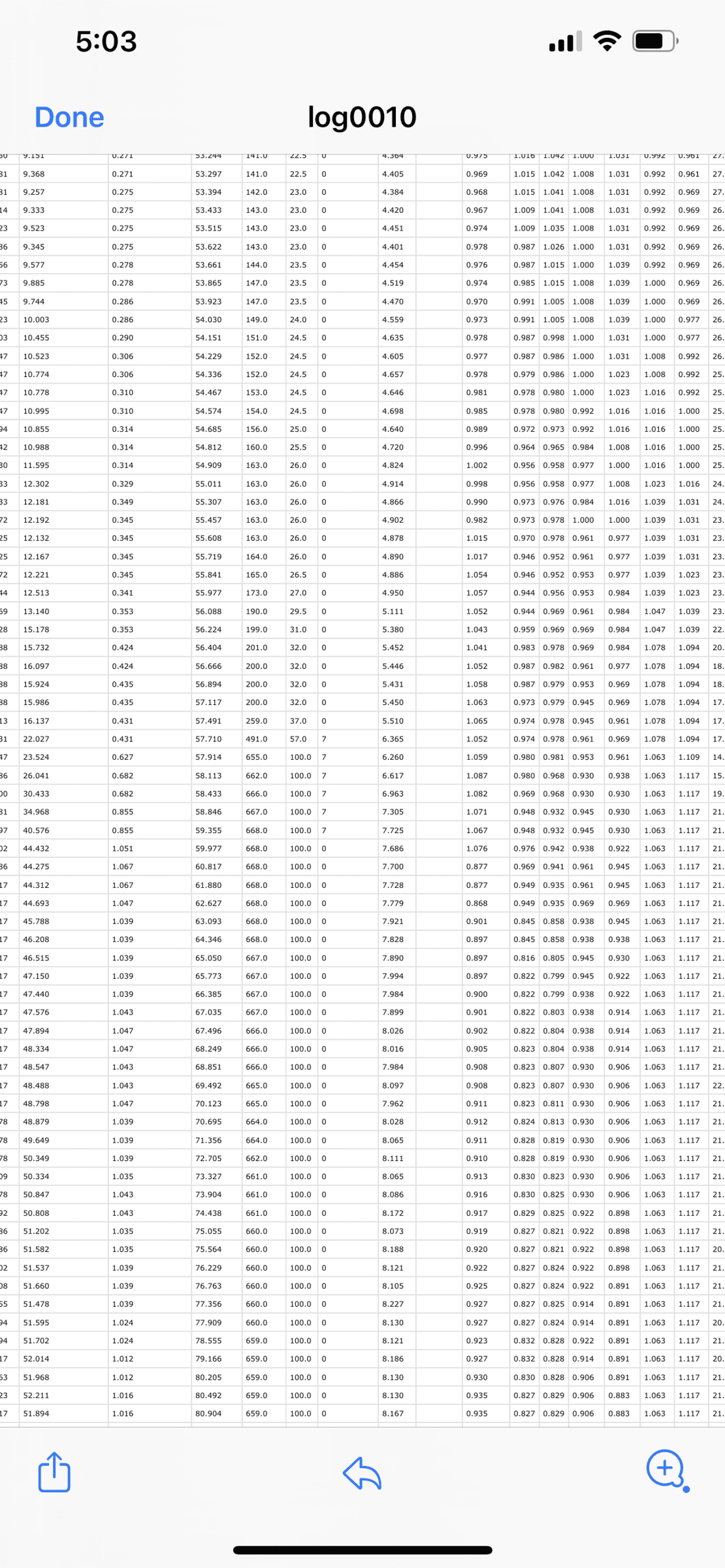

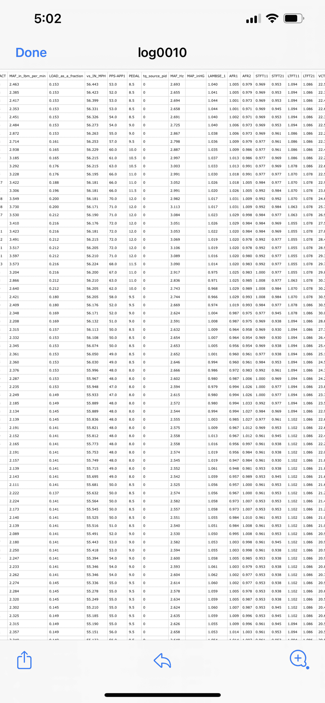

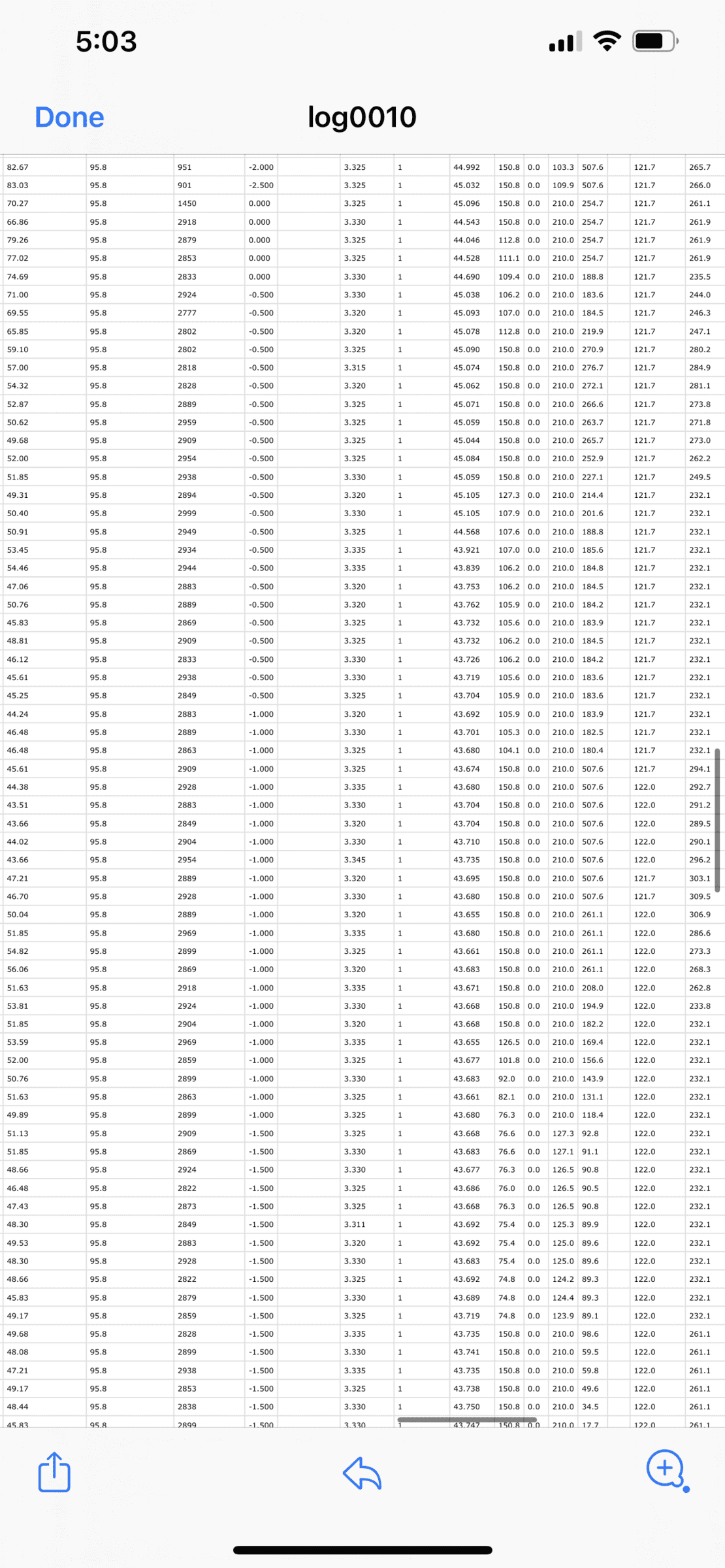

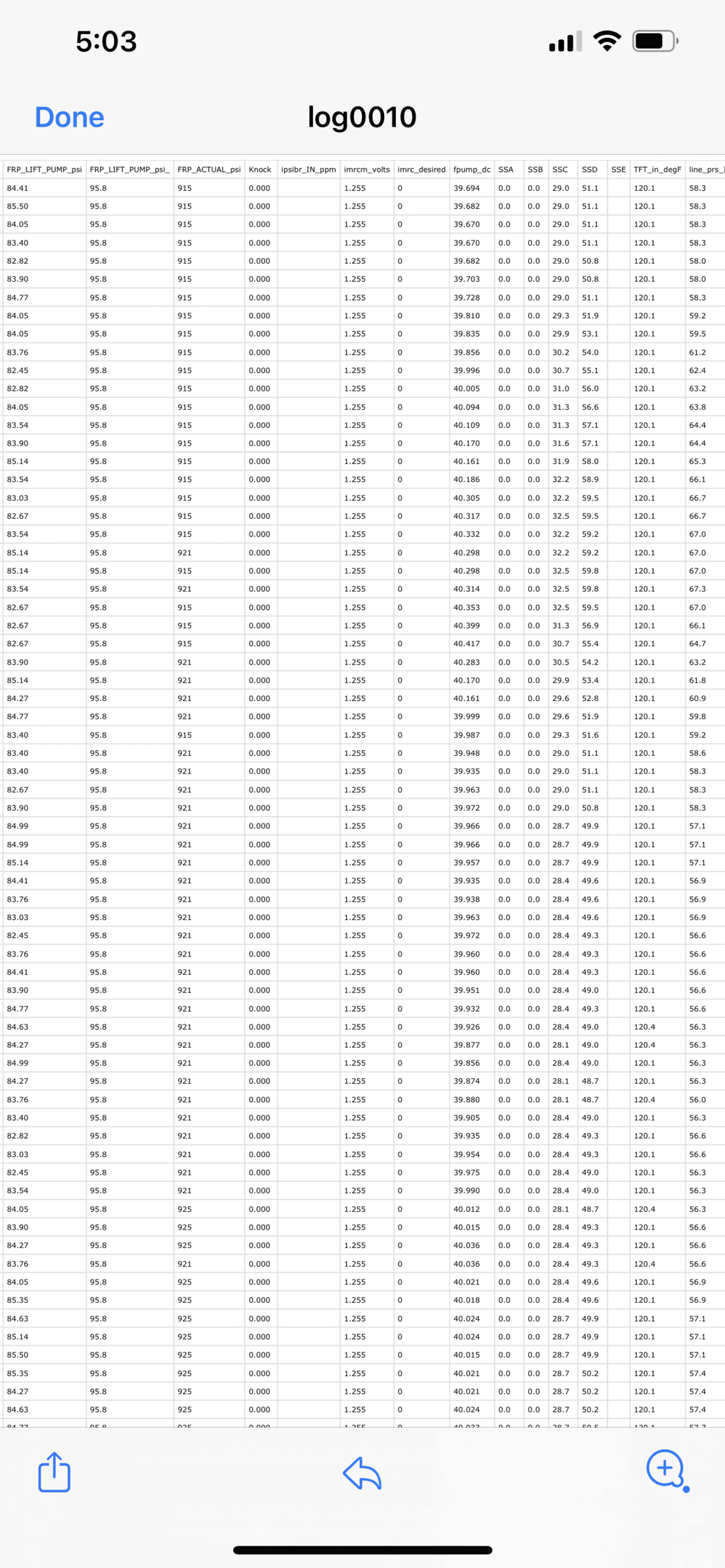

Here are the logs if it helps. First 2 pics are for MAF, AFR, and Fuel Trim readings. 1st pic being cruising and 2nd pic during WOT. Last 2 pics are for fuel pump pressure. 1st pic being cruising and 2nd pic during WOT.
