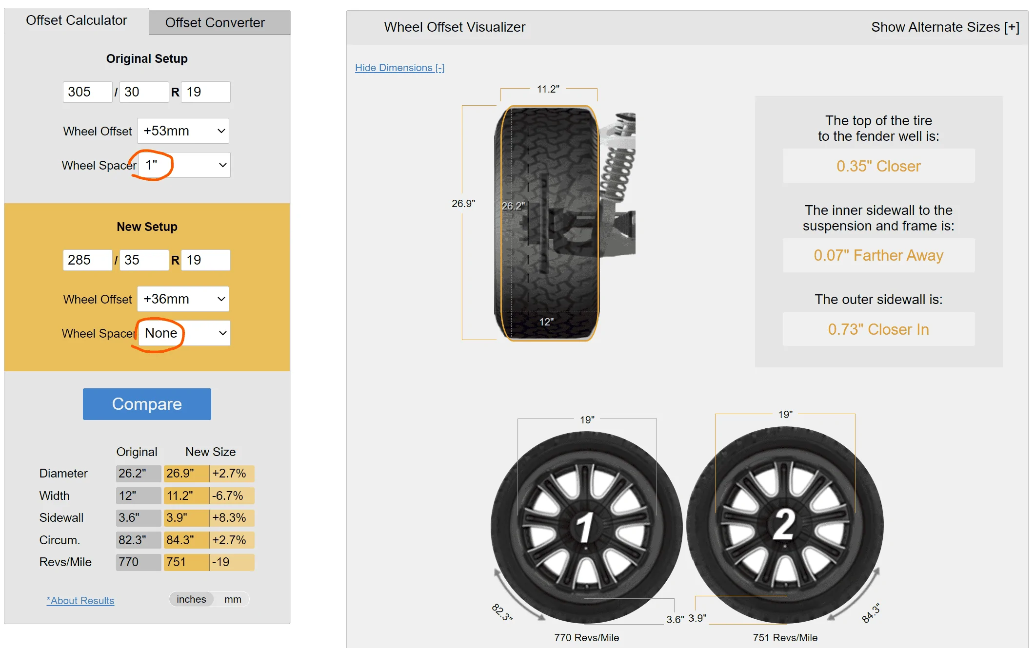

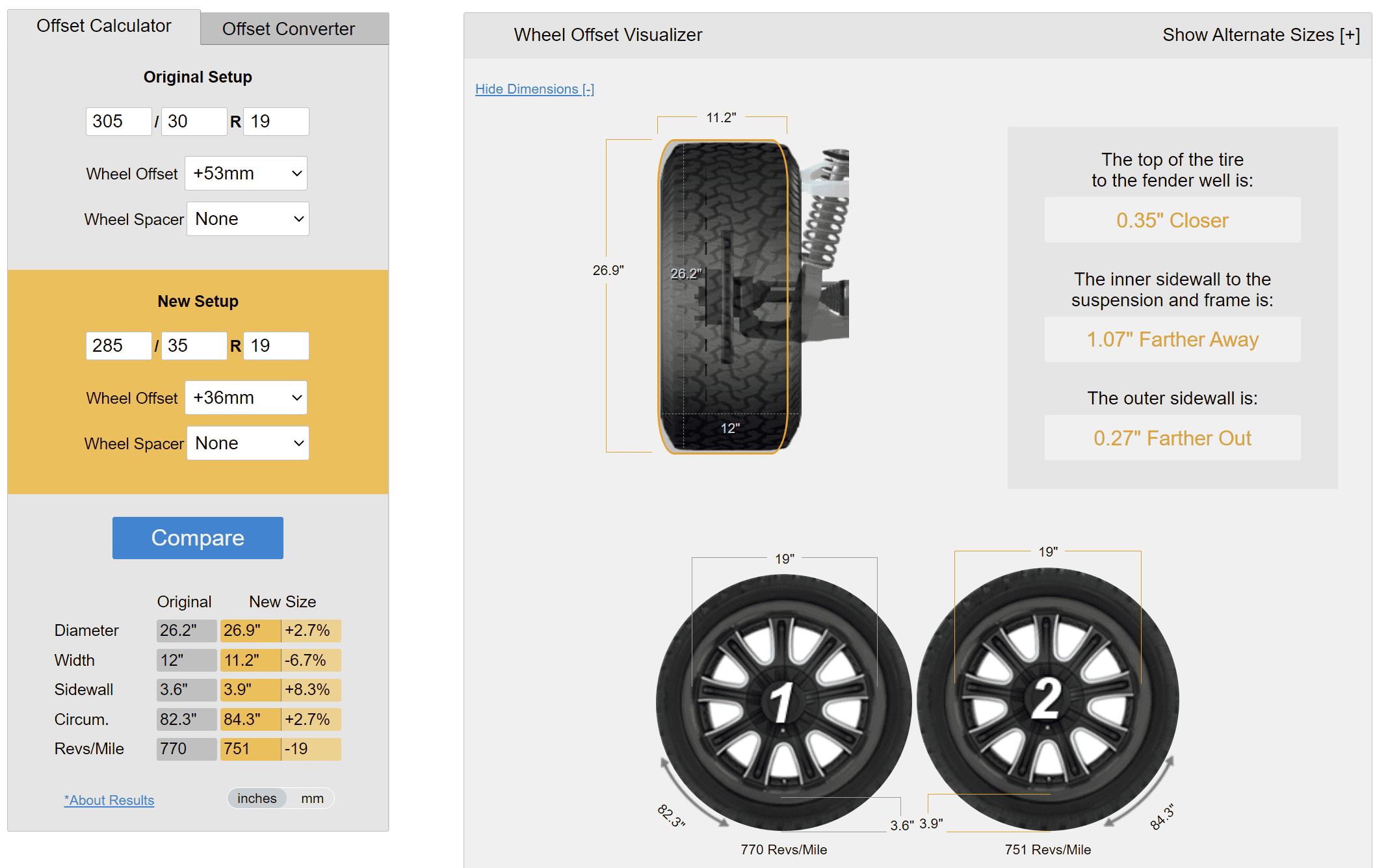

Couple quick points. You say for year one, you want rims and tires, specifically 10" wide rims and 285's. In year two, if you want to go to 305's, you are going to need new wheels again, or you will pinch down a 305 pretty quickly. My suggestion is go wide on rim size for the first set. I run a 305 on an 11.5" rim, admittedly its an RT660, which is wider than most 305's. But still, I would go wider than a 10" rim so I can stretch a 305, and buy once, cry once. Apex has great rims for your car, at a "reasonable" price, especially for flow formed/rotary forged (whatever you want to call them) wheels. And they offer group buys throughout the year.
Second, I could be wrong, but isn't a 35mm offset is going to poke out the back like crazy? I have 56 mm offsets, and mine are flush. I run 56 mm offset with a 32mm of spacer in the front. Did I miss something in another post where you confirmed a 35 mm offset will fit the rear? Again, I am likely totally wrong, but something seems wrong about a 35 offset in the rear.
the more I think about @Bloodham25 approach, the more I like it. he could use 10 rims set as daily for street tires once he moves up to 305's. stock 255 fronts on PP1 are a joke even for street driving, and 285 square would be ideal setup for street. so, it's not totally waste of money.
Rears:
Fronts:
Rears:
Fronts:
I think that's the goal is to keep the 10's all around for just daily commuting and the first year of track. Second year having a more dedicated 11's and 305's with track tires would be ideal.
The car is also a daily driver for me for the time being (Looking at a beater next winter, but I currently have an SUV that's my dad's that I use 95% of the time) so 285's for street use feels ideal.

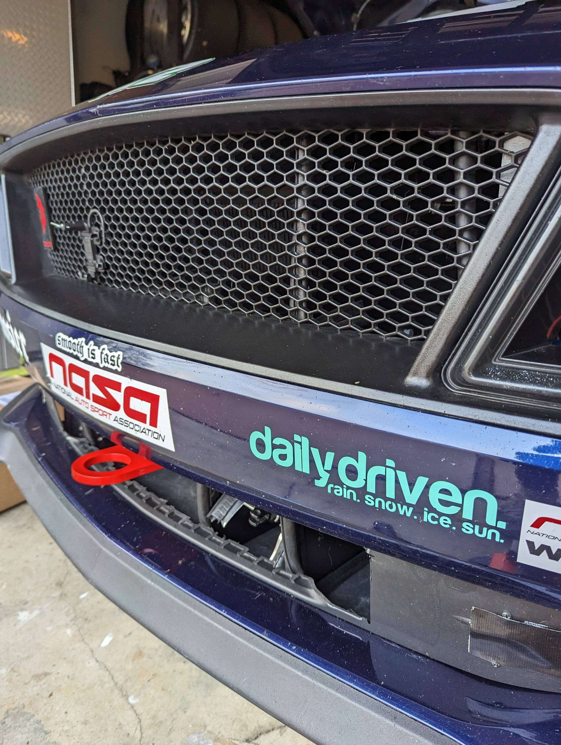

Oh..dont forget the tow hook!
This is the ZL1 ADDONS GT4.
Zl1addons is the best for these things.
Bloodham25
Bloodham25
May 13, 2022
91
30
Toronto
R.J
Mustang GT 2022 PP
I have the ford "safe and smart package" which I wish i didn't have as it's a pain in the ass looking at grilles. I think I've settled on the cervinis.
