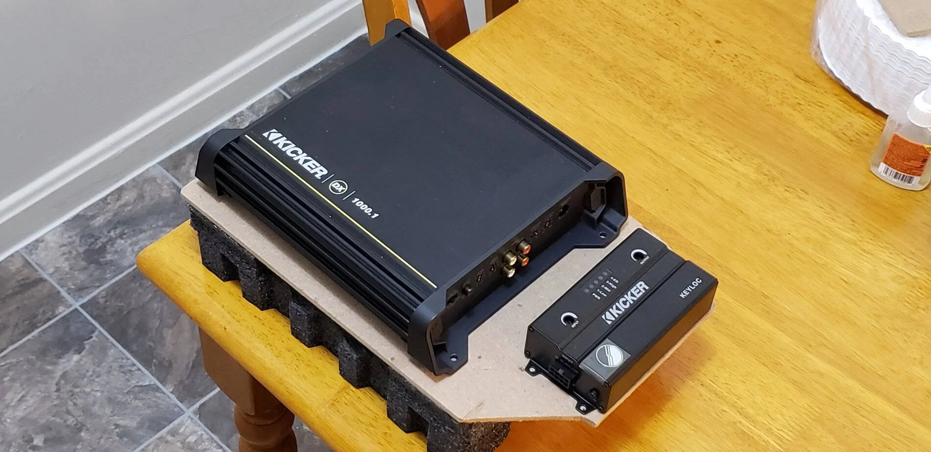

When I get time I'll just pull the kick panels and check for available space, and check fuse location 5 and 27 to see if its hot. If not either can work out then I'll just build a amp rack out of mdf in the trunk where the spare tire compartment is and run 9 conductor (speed wire) from dash to trunk, along with some ofc 4 gauge with distribution block. I'll update in a few weeks as this isn't high on my priority list.
Xzavior1818
Xzavior1818
Jan 13, 2020
Posts
89
69
ohio
Anthony
2015 SCION xB, 2019 Mustang Gt
  • Thread starter
  • Thread Starter
  • #21

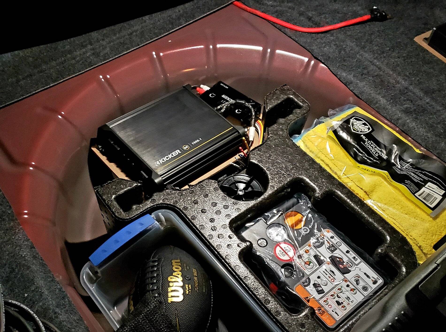

Update : Got around to making a drop in amp rack, found a location for the 4 channel amplifier. Got some 9 conductor "speed wire" to run to the radio. 4 gage ofc wire for the run to the back to supply both amps. Hopefully will have it all done by this weekend. Goal is to show no amps or wires just the sub box. Also did this without drilling or glueing into the car. If you have any questions let me know!

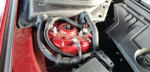

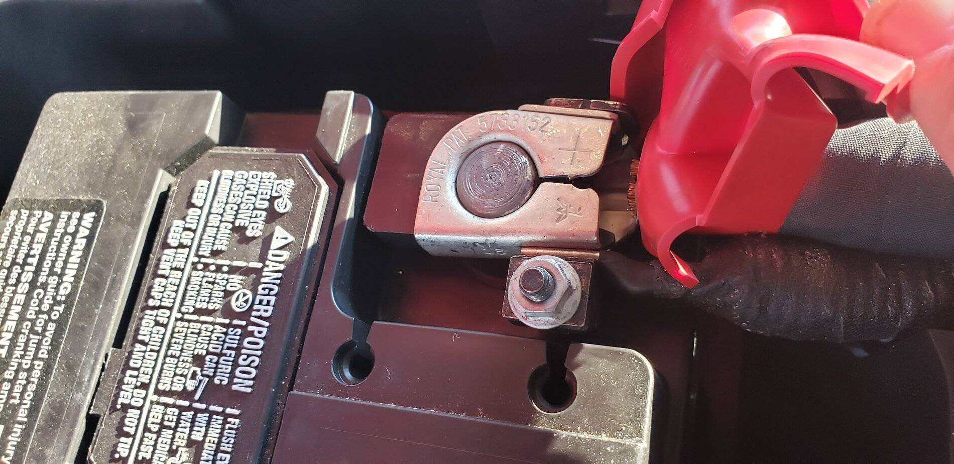

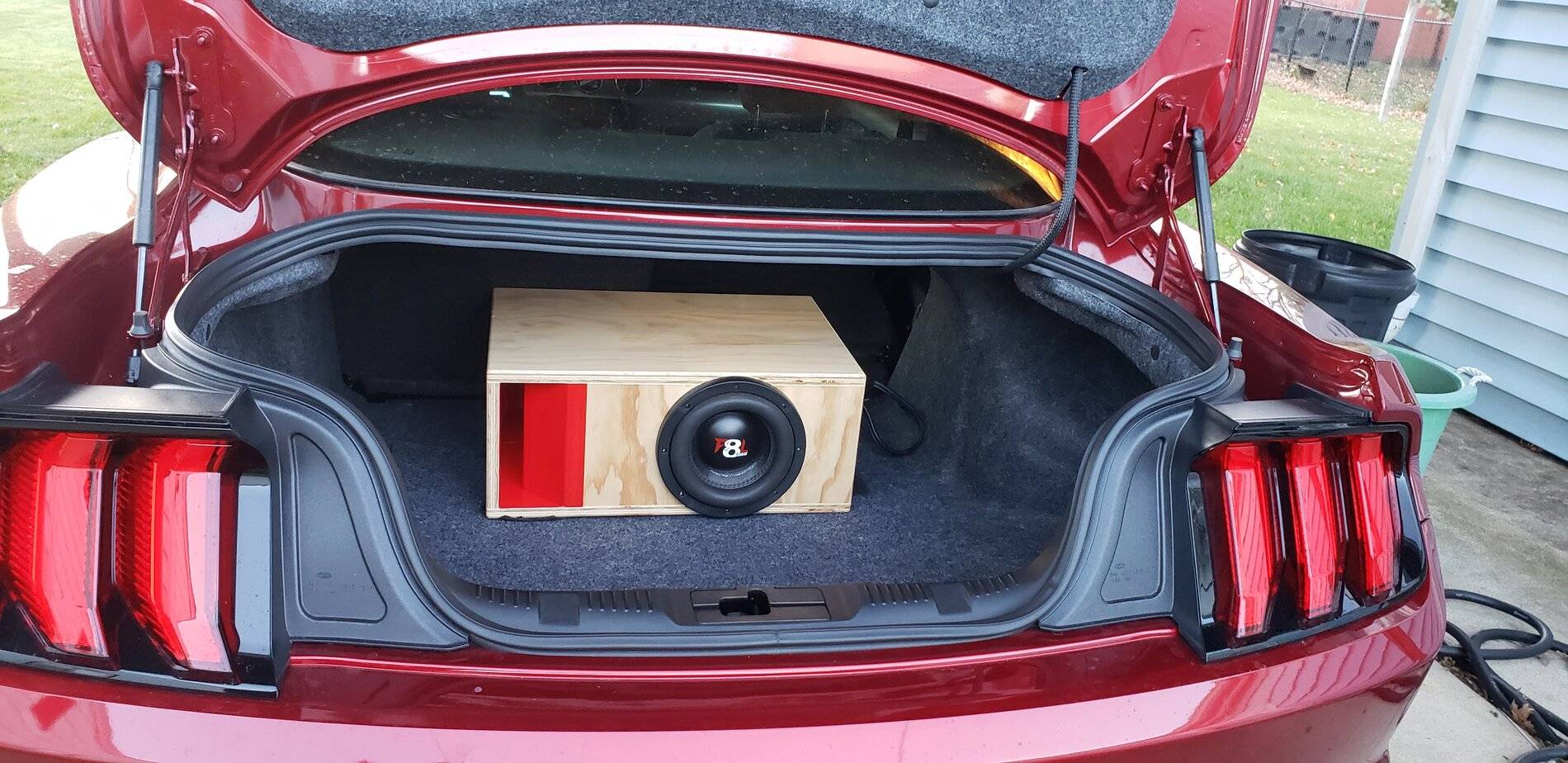

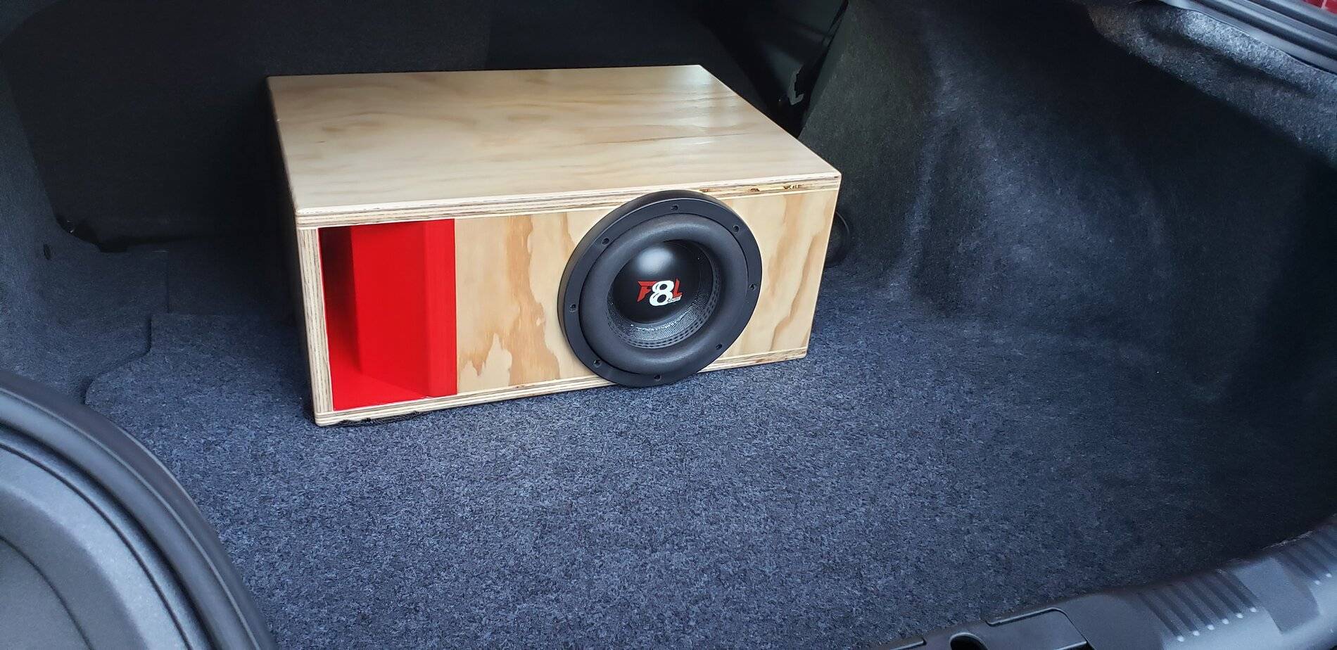

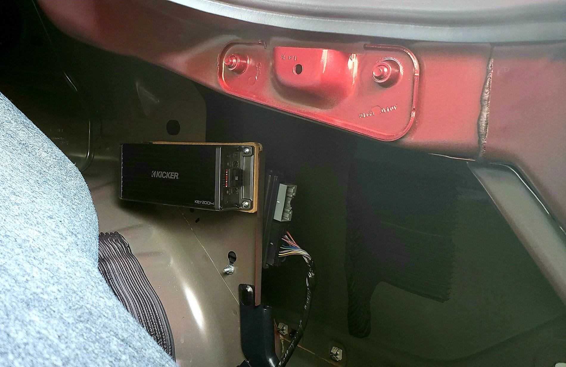

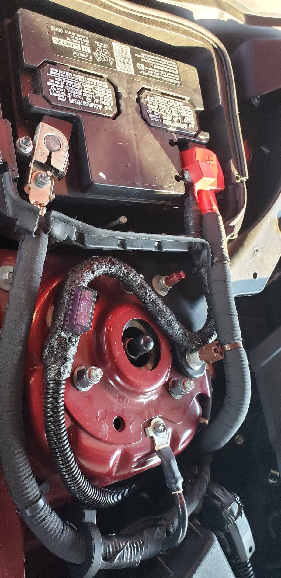

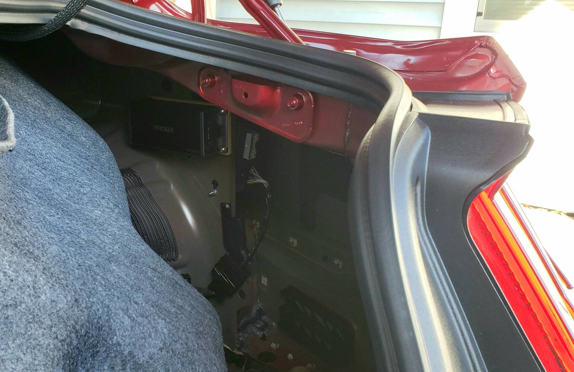

Finally done, Sounds great with the Kicker key 200.4 on the stock speakers. Sounds almost as good as my infinity kappas in my other vehicle. The Kicker key loc cleans up the factory radio signal as well and makes it sound good on my 8 inch sub (gain matched around 800 rms tuned to 32hz) Now it doesn't sound like crap! Here's some more pictures of the build. I had issues with the amps cutting off completely so i wedged the terminal on the side of the adjustment block. If your pulling at least 80 amps and running into issues, hooking it up to the bolt is not feasible because of the anti corrosive plating not giving you full contact. This will remedy it. I also used a drywall tap to mount my fuse holder using a hole in the strut tower. All in all, I did this install without cutting or drilling the car and wire harnesses. If you have any questions just ask.
Thanks for the tip on the terminal, another option is to grind off the coating and then once bolted cover with a light coat of Dielectric grease to protect it from corrosion.
When you say drywall tap, I assume you meant anchor? This gives me idea of maybe using a Rivnut here. I will have to look into that, may be easier then mounting to the firewall brace.
Yes I meant anchor! I used it because its a non conductive material. Very easy to remove as well. Also used them to mount my 4 channel back by the BCM in the trunk.
