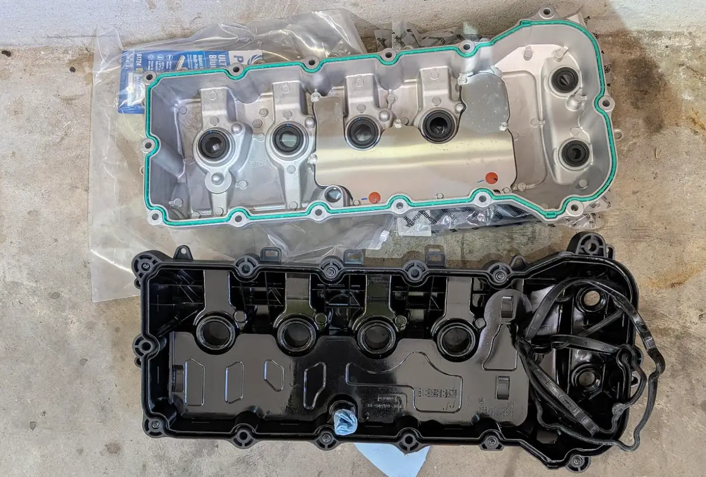

Ok so if you still have the 15-17 the valve cover design has a flaw which only shows up when you’re really sending it.
After a sustained right it seems to build up oil in the drivers side PCV line and then you can blow a Spy Hunter style smoke screen if it goes through the engine. You’re getting it out the filter which is probably better but still not fun.
I dont know any trackside fixes (other than back off to 8/10ths in the offending right hand sweepers, which is probably enough to stop it) but later you can put on the GT500 aluminum valve covers and/or run a drivers side catch can. Apparently every other valve cover for the coyote doesnt do this nearly as easily, but without DI you’re looking at a GT350 or GT500 valve cover swap. I’d also do the catch can as insurance.

For my car, I never had the issue until aero and better tires. Then at CotA i had to pull hard sustained right sweepers, brake hard into a fast left and accelerate out, and it would bow white smoke, misfire, and bog. It was sucking a lot of oil from the drivers PCV, and when checked, it was wet.
If I just lifted a bit between the right sweeper and the left if wouldnt blow smoke. Happened in two spots on track, both followed that same sequence.
I put on a pair of GT500 valve covers and a drivers side oil catch can but never repeated the experiment at that same track.
