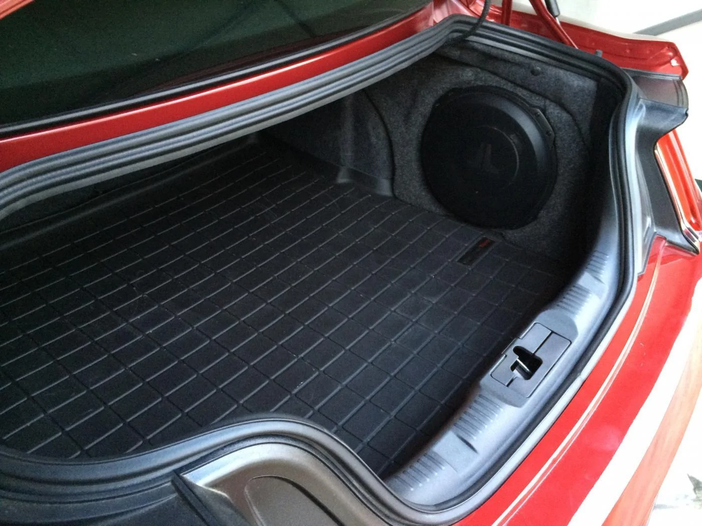

I just had this installed on 4/14/16 with a 600 watt JL sub amp. I am very happy with how much sound this thing puts out. It even makes the 9 other speakers sound better to me! But like everyone says, you pay dearly to save on space and appearance. My amp is mounted under the driver seat.
I guess you forgot about this thread you posted in for a solution to get more bass into the cabin: https://www.mustang6g.com/forums/th...-the-rear-seat-backs-down.128004/post-2663434Thread Necro!!! While searching for related info, I came across this thread. Thought I'd share a few thoughts.
I've had the JL Stealthbox for 3.5 years now, fed by a JL 600/1v2 (600w @ 2 ohms) and have been happy with it...not overjoyed, but happy. I get some real bass, which the stock 9-speaker Shaker system sorely needs, and it takes up zero usable trunk space.
I've found that with this box you have to ensure two things:
1. Feed it enough power
2. Have reasonable expectations
This sub doesn't thump like two 12's in a ported box, but neither does it take up the entire trunk like one. I've also very clearly noticed that with one or both of the back seats down, the bass energy coming into the cabin doubles (at least to my ear...not measured or anything.) But I don't like driving around with the back seats down.

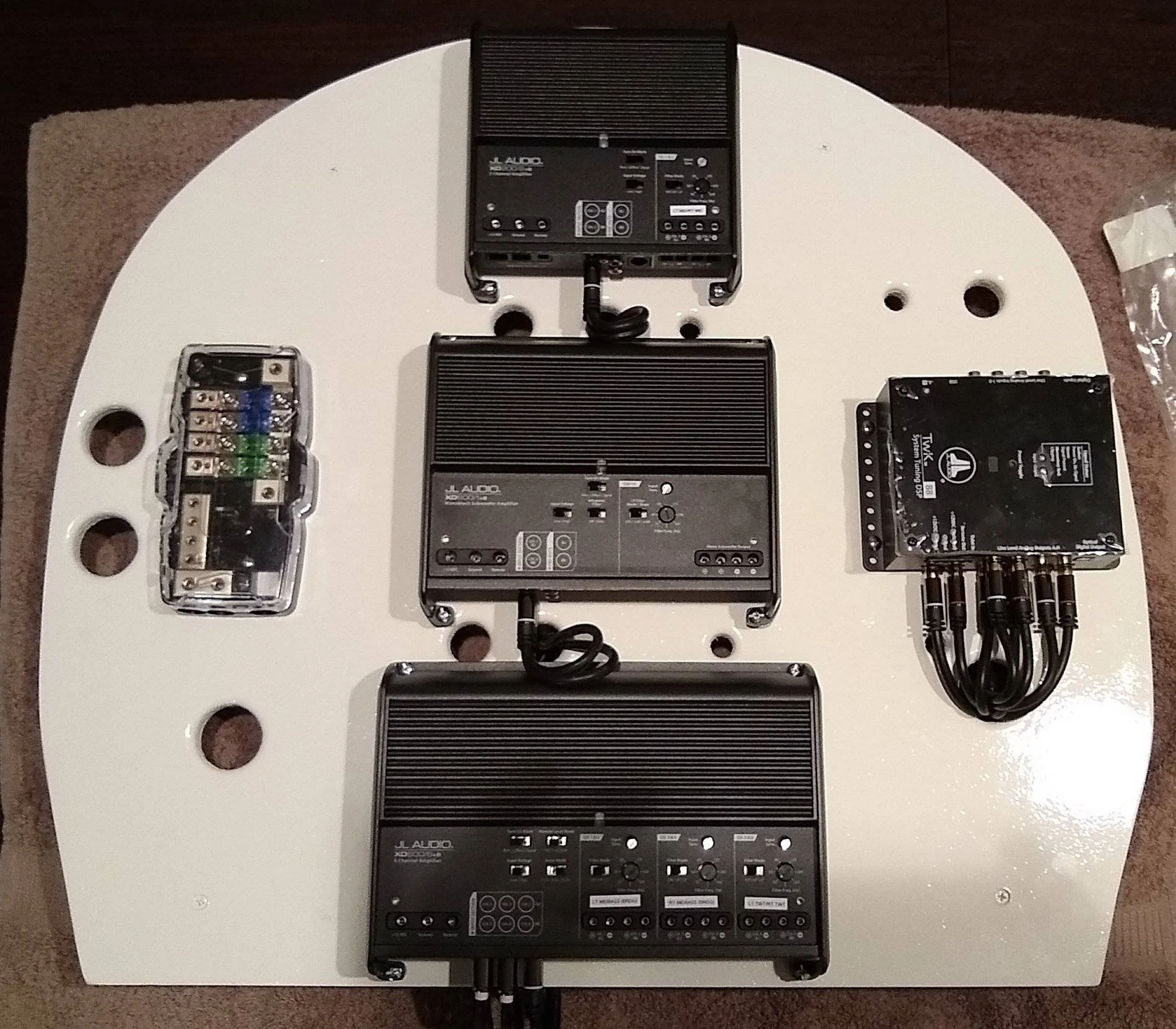

I've embarked on a complete amp/door speaker rebuild (going full active/DSP but retaining the stock HU) and will finally get to test out and answer two things I've wondered about the Stealthbox.
1. How much of a difference will I hear with the sub amp receiving a proper input signal from a preamp/DSP vs. the LOC that feeds it now?
2. How much of a difference will I hear with the rear speakers removed and the bass energy being easily able to get into the cabin?
I've built several big systems in past vehicles, so I'm betting the answer to both questions is "Significant." At least I'm hoping it is.
I'll be starting a build thread soon, but wanted to post these thoughts in this thread, so it might be helpful to anyone searching "Stealthbox."
Also attaching a teaser pic of the amp rack in progress.
