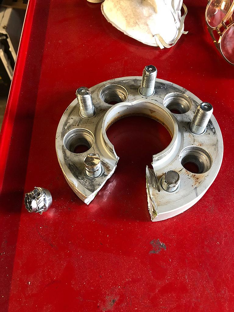

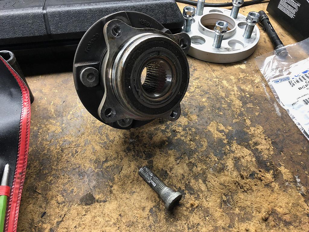

Seems skin deep.I don't know what happened to the spacer stud. I was just washing the car looked down and it was gone. Could be several things, I'd just had a tire repair done on that tire... I live in not so good part of town and vehicle thefts are quite common. It's possible somebody a tech over tighted it and tried to cover his tracks or a theif tried to steel my wheels and broke it off.
The real problem was not detecting the presence of loctite on the wheel stud and rounding out two of the nuts on the spacer mount. Once I got head on them they came off fine. I usually drop a dab of loctite on the end of the stud or on the nut to indicate I've used it but not everyone does that.
As for the Eibach spacers, they seem to be of fine quality.
