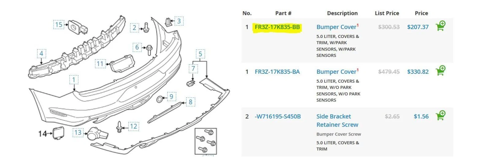

Is this the correct bumper @LevittownFord
ISSA V6
Mar 17, 2017
Broward/Dade County
2016 Mustang V6 Custom body hottie
Paying a visit to the parts department tomorrow at a local dealer. I've decided to upgrade my base v6 bumper (w/ sensors) to premium.
Is this the correct part code?
Also I am aware that I also need to valance.

That is the correct part number and you will also need FR3Z-17F828-AA (Valance)

Any idea on why a bumper cover without sensors would be 50% more money than one with parking sensors?
thet33
Nov 19, 2015
665
117
Dallas, TX
2016 Magnetic GT/6MT/3.55
supply/demand
I'm assuming these are just primed? So you'll still need them painted?
