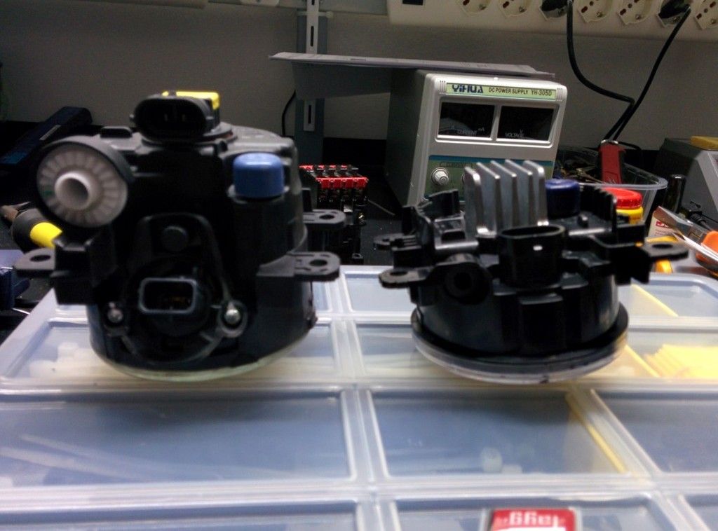

Then I made a small comparison between the two:
The good on the right, the ugly on the left
You can see the connector for drl on the bottom and the connector for fog light on the back
And I did some lab tests too :lol:
EU (halogen)
US (led)
The pattern is the same but looking at the light when on the led version is nicer to see - not to mention the light color temperature. Also, you can see how different is the current consumption. This worried me a bit about the car not sensing then when on and maybe cutting power, but hopefully they works :)
