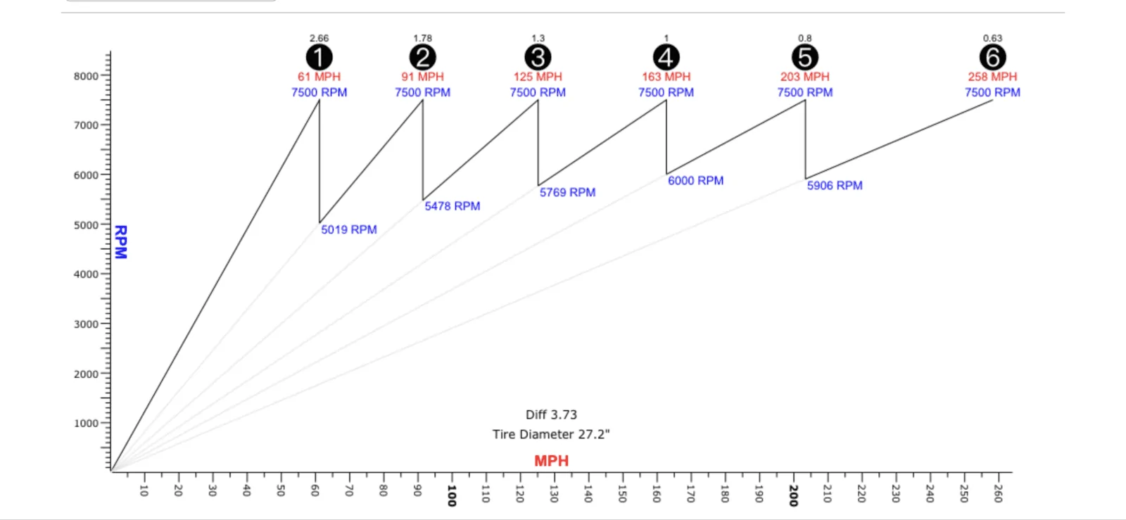

I have the 2.66 first gear and the 3.73 rear end and 28 inch tires. Yes it takes a bit of getting used to especially with the RXT clutch but once you do it is so much more usable on a car with a SC. I kept the .5 6th gear only usable on the highway but I like it.So you've got the 2.66 first with a 3.73 rear, right? Do you even have to shift to second doing 0-60?
