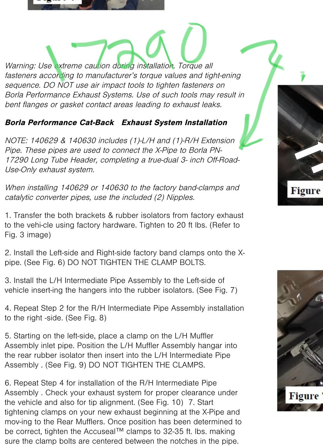

And I have a bone to pick with Borla
Ordered the full 3” catback,(kinda talked into it by dealer I got them from) for later on doing the headers.
Which borla names out in the directions.
but none anywhere to order and borla never replied back.
As I have the front connection pipes sitting here from the kit still
