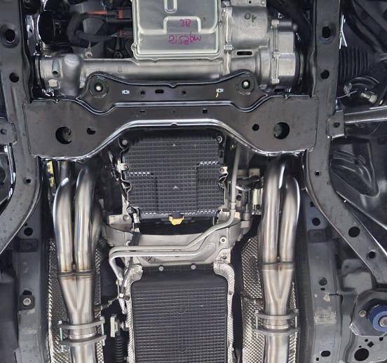

I second the LTH brand headers. They look good and snugged up to the engine block perfectly.
Only potential issue I could see is the steering shaft sits pretty close to one of the tubes on mine. A lowered engine could potentially create issues and require stock height again. I also chose to put a heat blanket on my starter since, again, one of the tube is sitting about an inch away from it.
