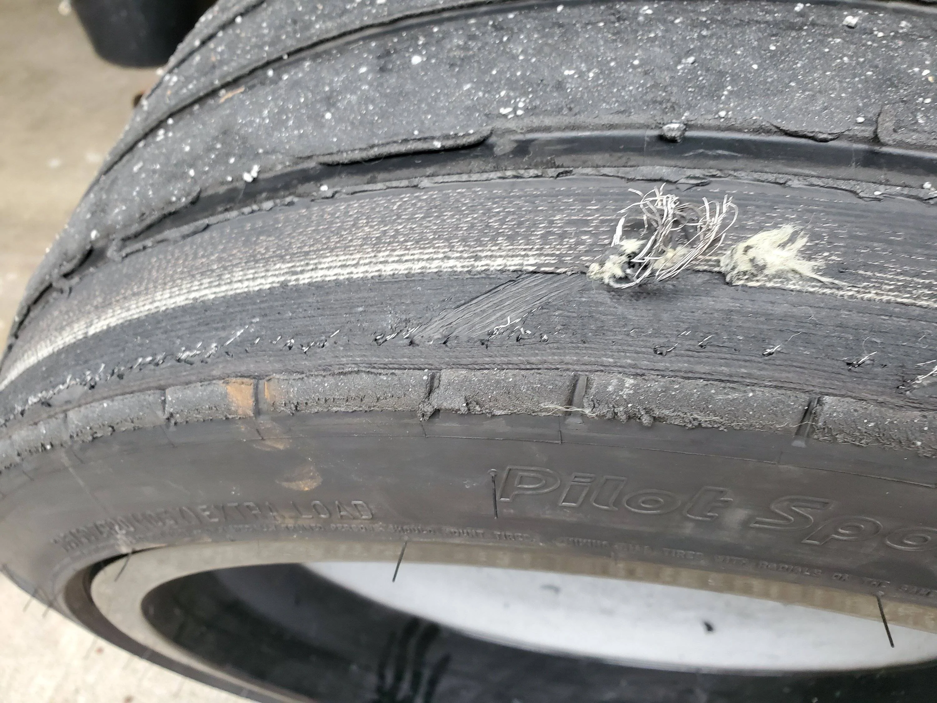

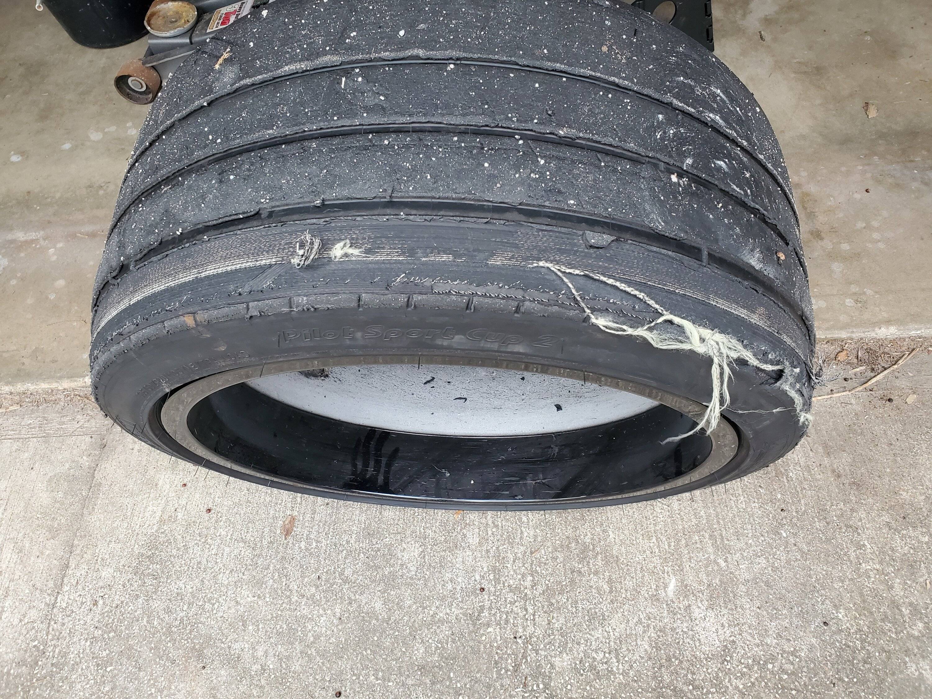

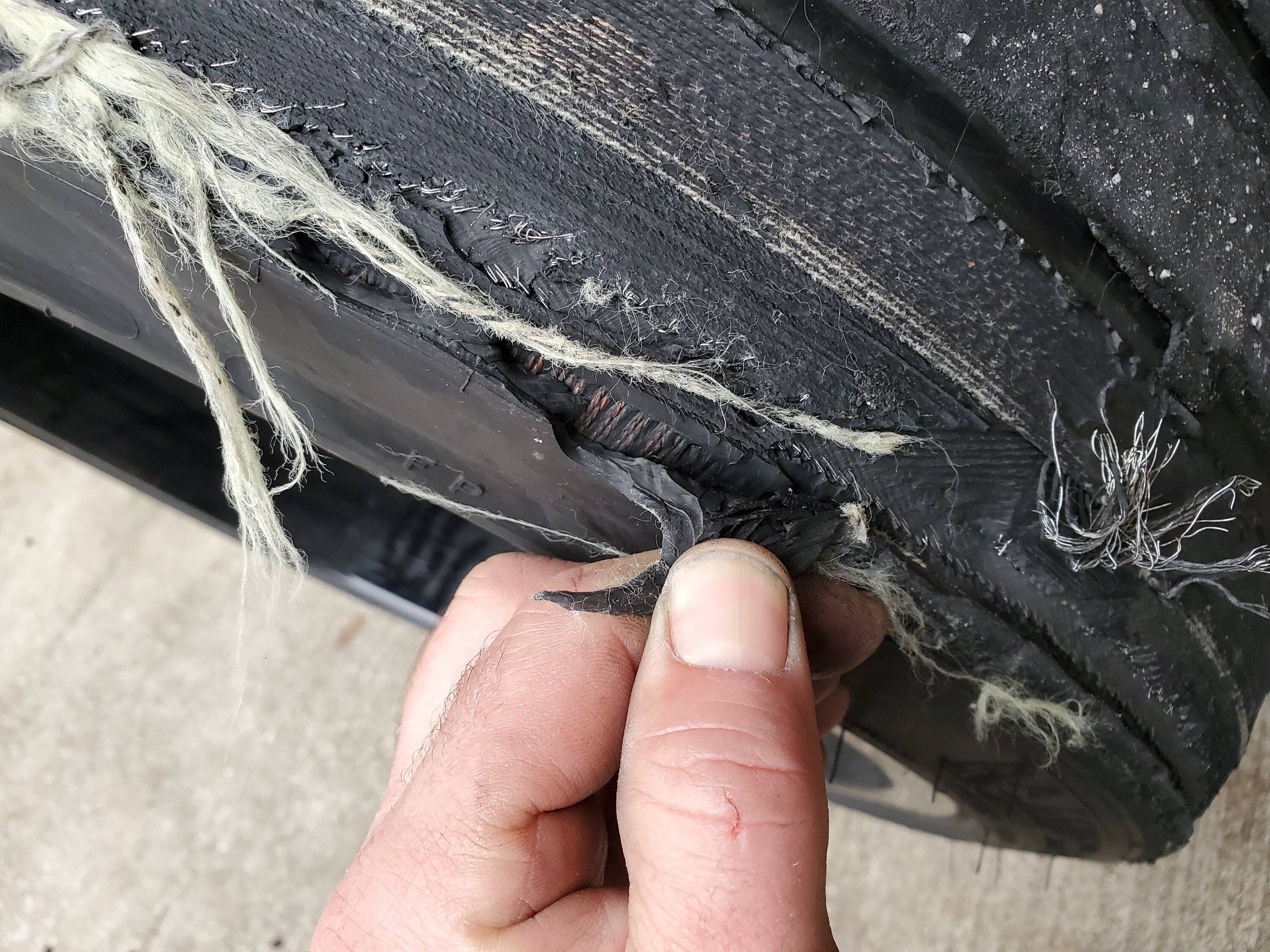

The problem with the car, again, is weight. The car will turn, but not like a 3,000 pound car will. The GT500 is no competition to a GT4.
The other consideration is tires. The cup 2 tires are fine, but they are no slicks. They grab until they slide. What compounds the problem is tire pressures. You start at a pressure low enough to account for expansion, but your target hot pressure only lasts for a few laps until you exceed them and wind up in the 40 psi range, which slides all over the place on the infield.
I monitor my pressures as I am driving on my tpms display. What I am experiencing directly corresponds to what I see on my tpms readout.
For the first time in driving Daytona, I had a tire delaminate. When it happened, I knew exactly what it was, and in slow motion realized that it wasn't a complete failure followed by depressurization. This occurred right out of NASCAR turn 2 into the backstretch. I was at about 160 and accelerating. This failure occurred on the right front tire. I was surprised to see this because usually the culprit is the right rear. The right rear carries most of the burden around the oval course and that one is usually the one to go bye bye. Had the tire completely failed and "blew out", it would have been a hard pull to the right and into the wall it would have most likely gone due to the proximity.
I just had all 4 wheels off the car to do my periodic inspection. They were perfect. The temps after each session were within 10 degrees from inner to outer of the tire. Wear was perfect. I aligned the car myself and the temps and wear indicated that it was perfect. So what caused this to happen? Most likely the jacked up rumble strips in the bus stop. I spoke to the pirelli tire guys who were doing all the race car tire work at the track. We both came to the same conclusion, that it was probably damage incurred by those rumble strips and once a small defect is introduced, the tire will come apart under those loads and speeds.
I feel lucky that it wasn't worse. See photo.....
As for the half shafts you mentioned, Ford simply doesn't use the correct grease. The solution to the problem is higher temp grease that can withstand the heat generated. To correct the problem, you need to take the half shafts off, remove the boots from the inner cv's and break the joint apart and rebuild with suitable grease. I'm not going to name the grease used because the guy who did it may not want me to share it.
It's time to do another rebuild on my half shafts. Enough time has gone by that it is prudent despite the temperatures remaining constant since they were installed. I was advised by an absolute expert to rebuild with krytox this time due to superior adhesion and drop point. I was told that is what most major race teams use. The downside? Cost. And that is probably why Ford doesn't use a grease more suitable. I believe this is for a few reasons..... first, this problem is mostly attributed to the rigors of Daytona. This doesn't happen much anywhere else. It is ny understanding that this is for several reasons. The big 2 are joint geometry going around the ovals as well as longer duration of foot on the floor driving. The joints get hot, grease melts, joint disintegrates.
So here is the photo of my partial delamination out of turn 2 at 160 mph.

Is there a slick tire option you can run? I believe I've seen guys running Hoosiers? That delamination is scary, real scary.

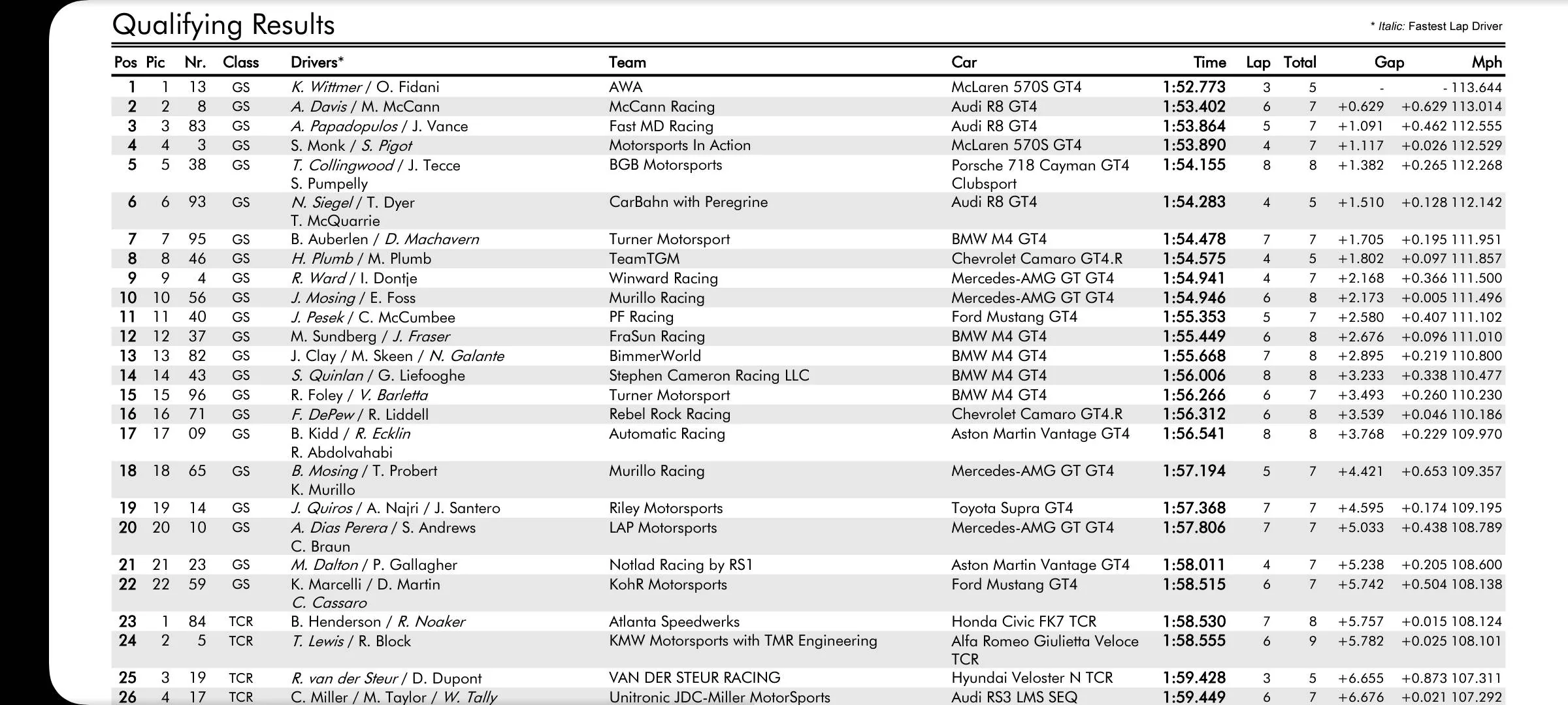

At the time I was around the gt4 it was still in it's earlier days and I believe at the time they were running a g-force axle. I have heard the same about the grease. Ford actually wanted the dealership to replace the boot only, then sent a boot that wasn't anywhere near large enough to even slip over the shaft. So I ended up with a new driver's side half shaft.
Here are the times I was referencing. I'm sure uncorked the gt4 is quite a bit faster... in race trim your 2:00 min laps aren't that far off really.

It's no contest. Last year when Billy Johnson came up behind me out of Rolex turn 3, it was apparent. I got the hell out of his way. He was practicing for the Rolex 24 and I wasn't going to be the guy to play games. They do this for a living and I don't.

Very very very lucky, with that tire. You bring up many points and/or items that make me ask.
1. Anyone tracking 500 for fun have should talk to Pro Teams before driving. (or given a communication portal)
2. Track Attack is offered for free for a reason. Yes it's fun day. Liability! If you take the class, they taught you. If you don't, you declined it.
3. Tire failure due to rumble strips? Looks like alignment specifically for Daytona required.
4. The sneaky grease that the Teams use is super important, what if a half-shaft failed doing 184mph, bad day.
5. Back to the Tire, I'm positive the MFR have "unwritten" spec's for Daytona. Or recommendations to NOT use Cup2 and only their Race tire. (IMSA spec tire)

Do yourself a favor and send these photos to the IMSA Michelin Engineers and post their response. That will help everybody. Please keep your personal attacks to yourself as you just might get embarrassed.
