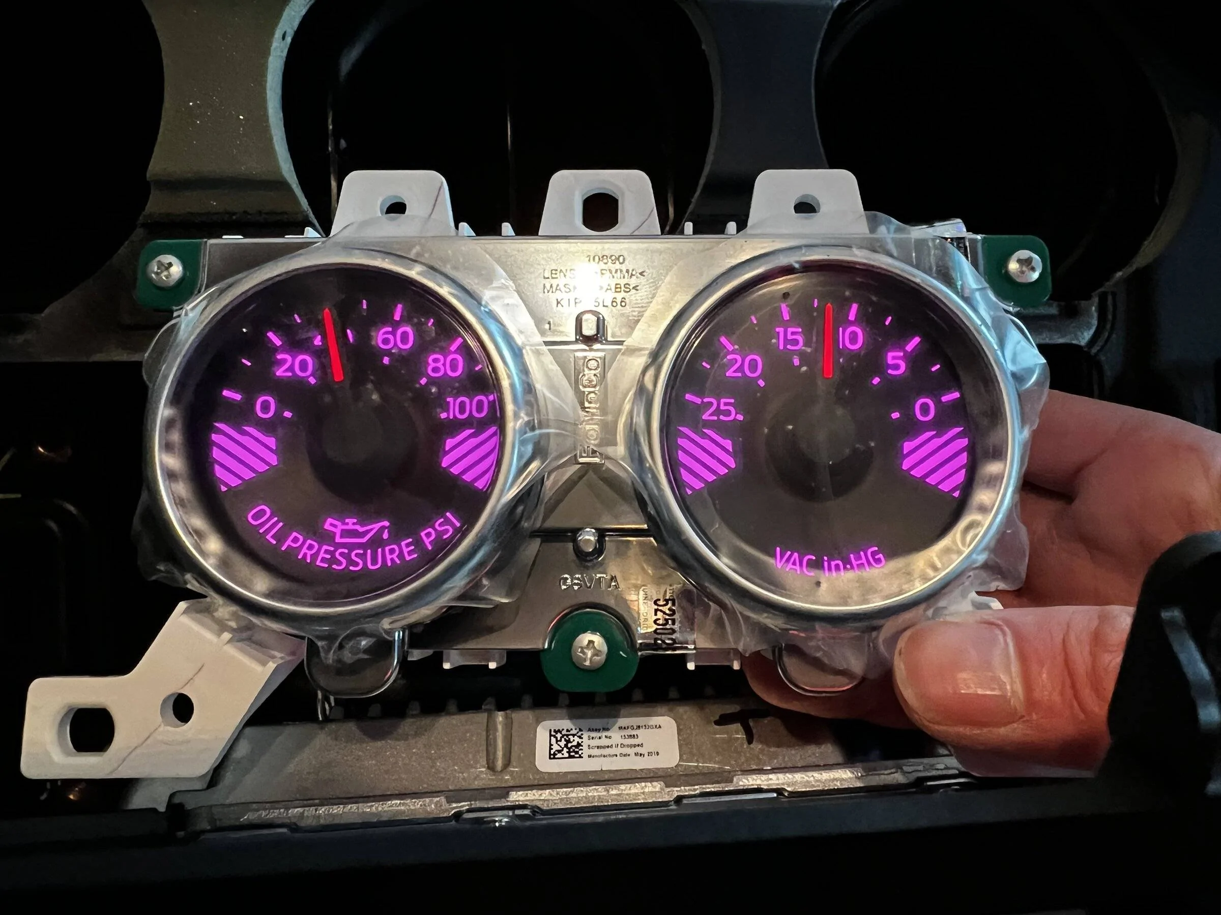

If your car has MyColor double check the gauges do. Not sure if they made them both ways to save a few nickels.
I bought GT350 gauges for my PP to replace vacuum with oil temp. I knew they were white only. But decided I really wanted those gauges to match the other lighting in the car.
So what did you end up with? Do you have the GT350 gauges in white? Tks

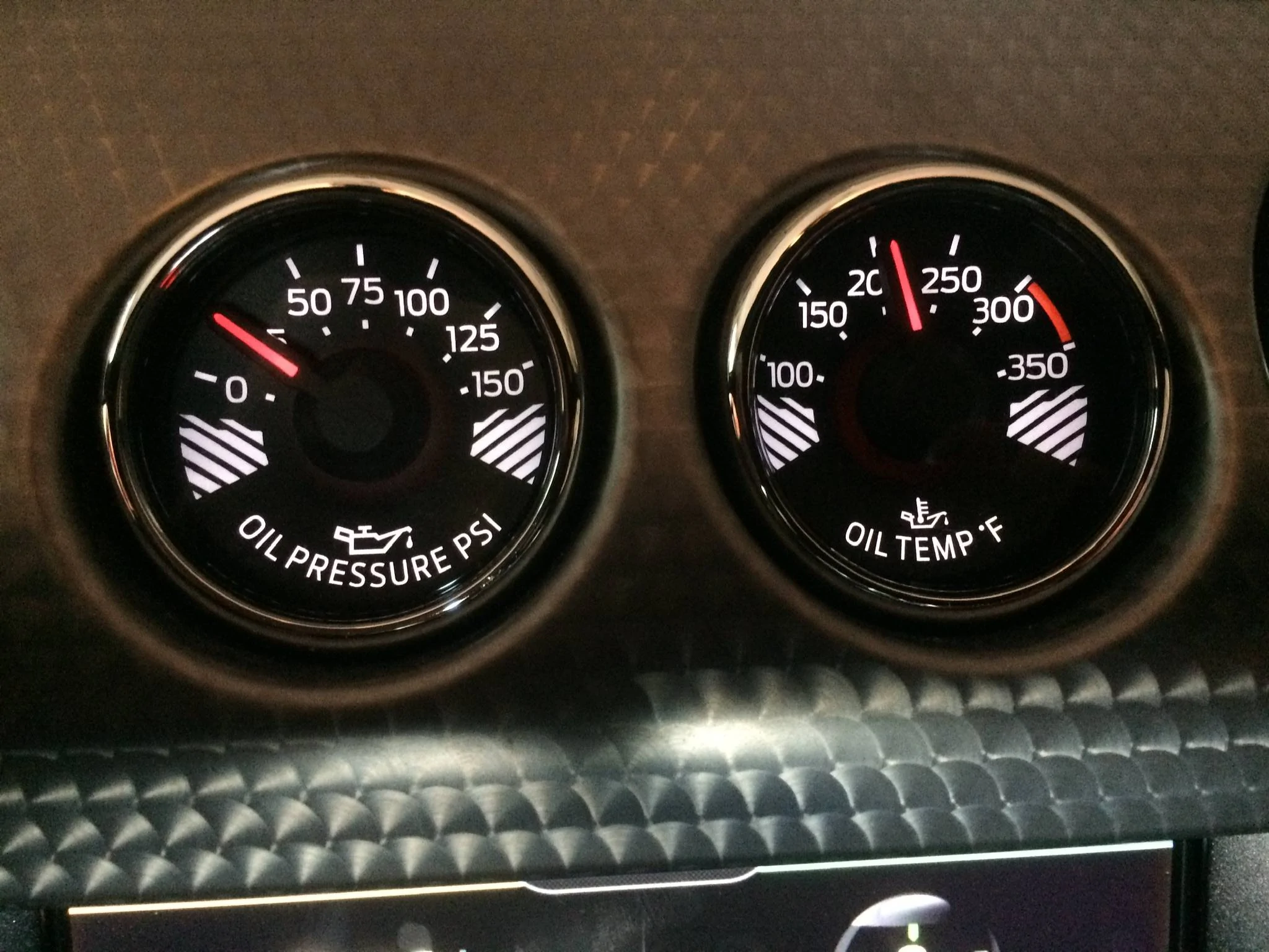

I changed out the vacuum gauge for an oil temp gauge in my 15 GT performance pack, just plug and play no wiring or anything required.

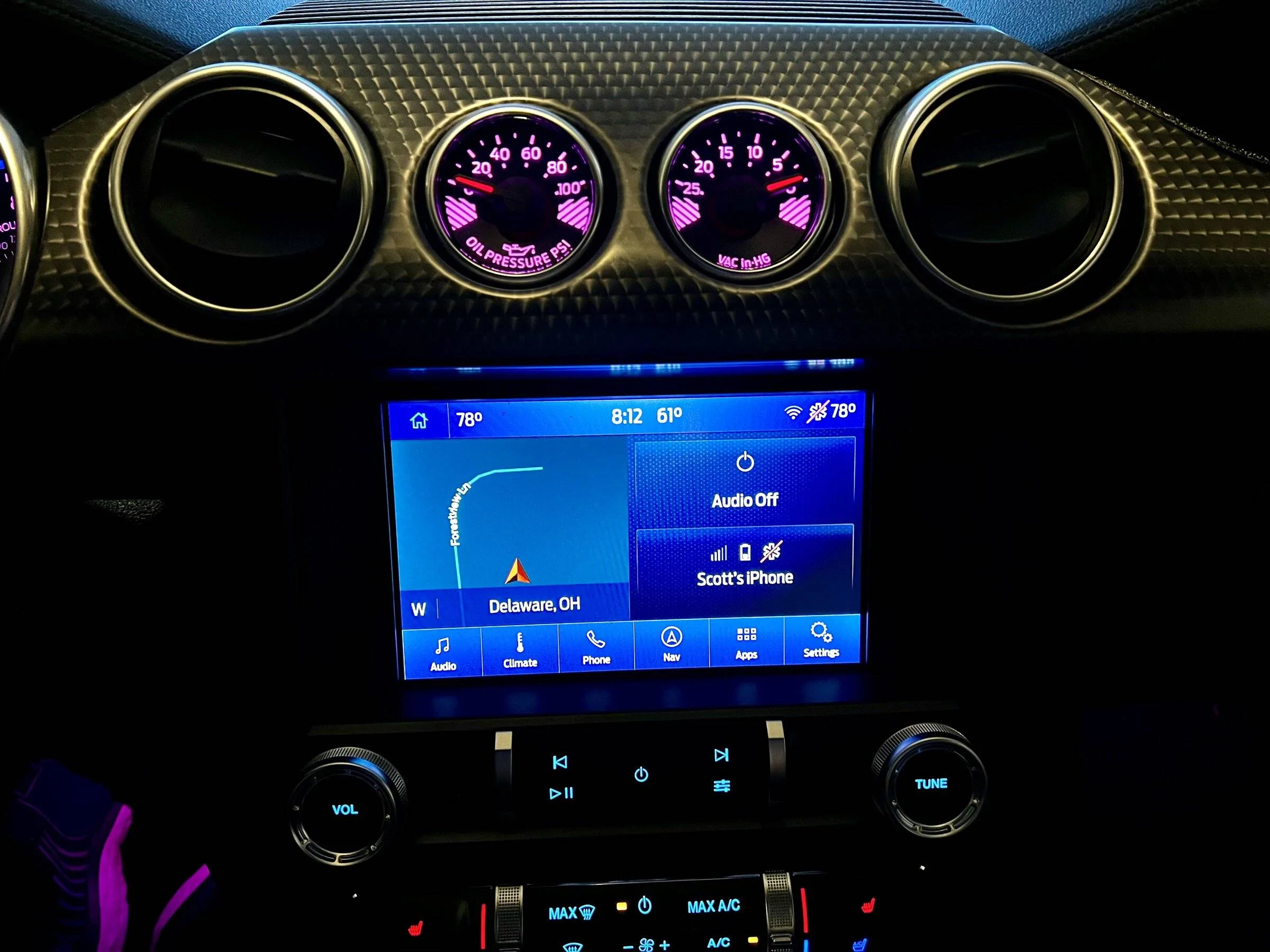

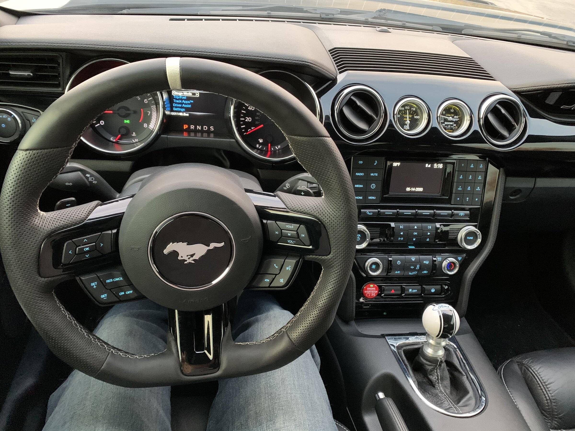

2019 GT Premium non-performance pack. Cable was behind the touchscreen and gauges worked perfectly with mycolor on initial start up. Plug and play. Now I need to decide which type of dash trim to go with.
scoots
Nov 18, 2015
154
107
Columbus, OH
2019 Mustang GT
Gauges and dash trim installed today. It was tough when the moment came to cut into the dash.

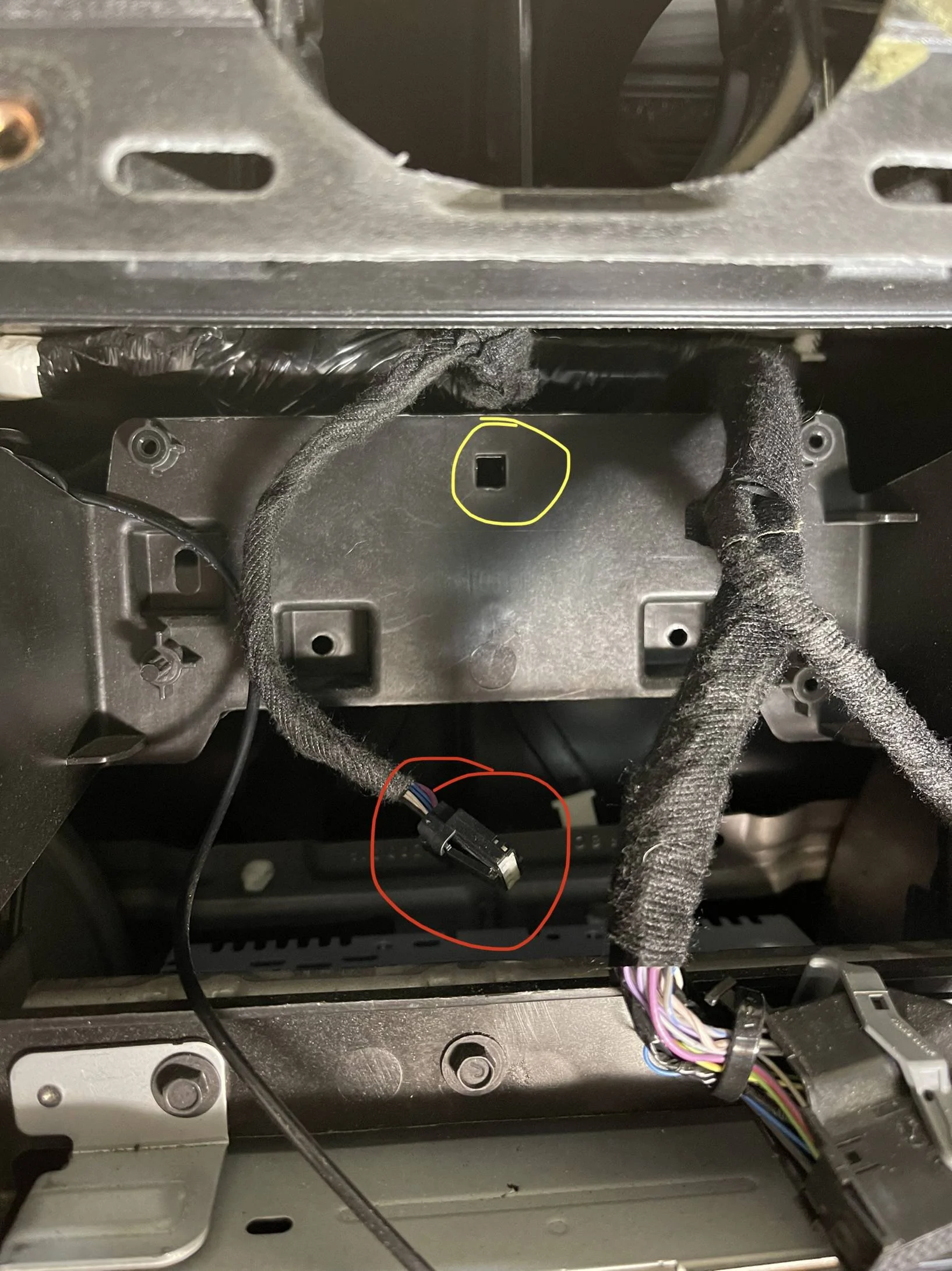

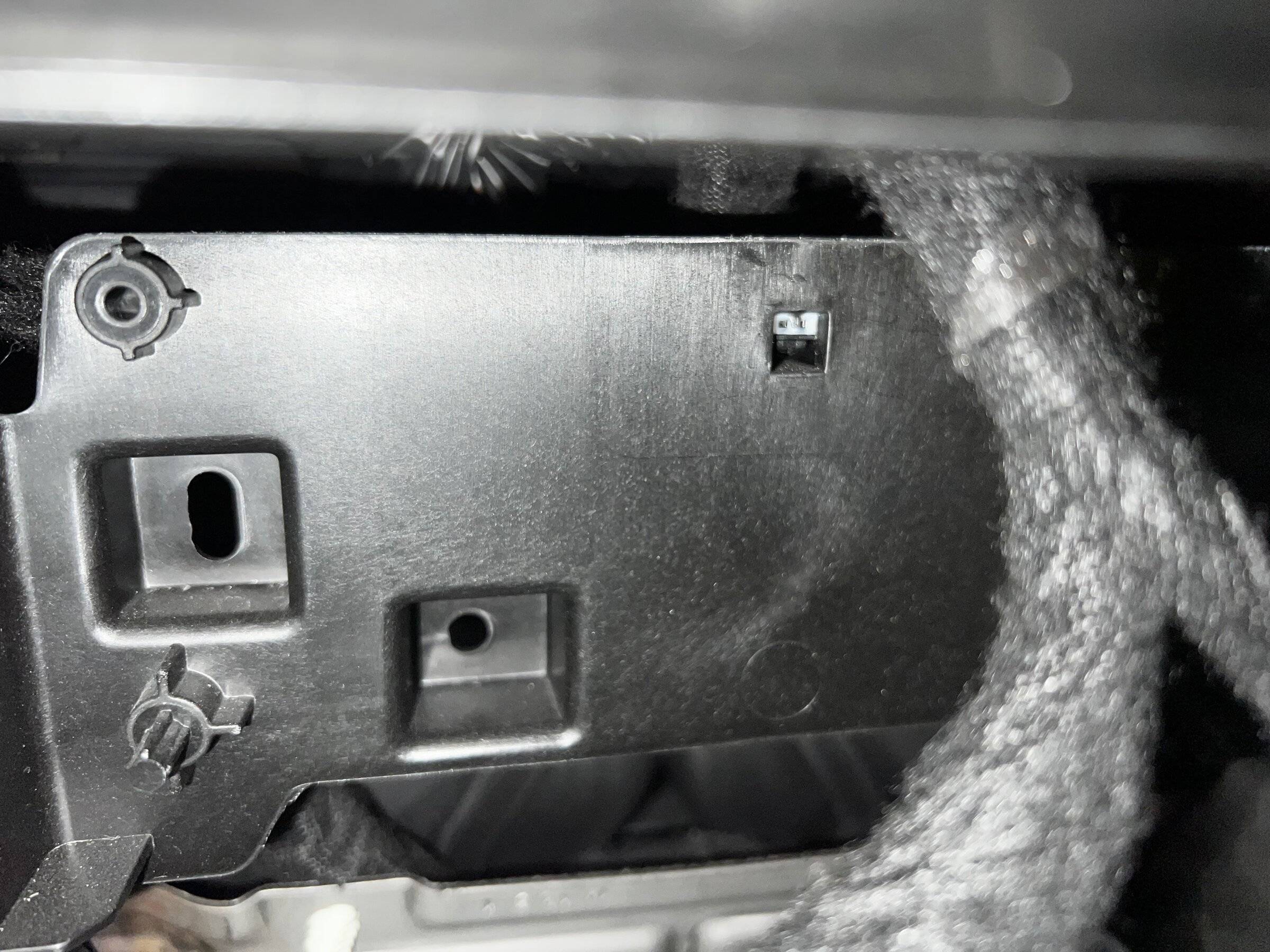

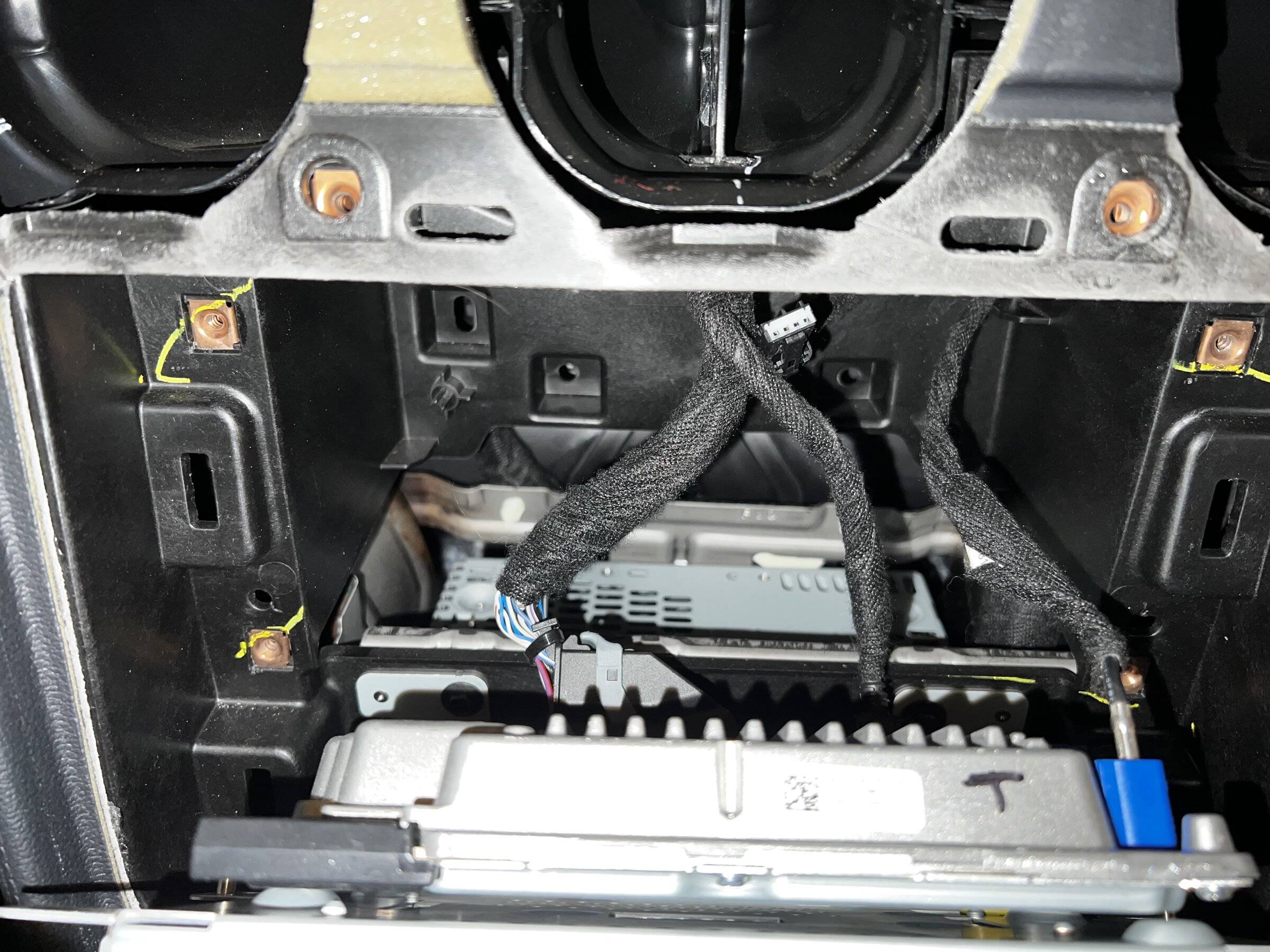

Wild. I went to do this swap and found an odd connector that was snapped into the back part of the dash behind the Sync screen. It plugs right into my new performance gauges! Nice surprise that I don’t have to do the wiring and connector to the APIM. Hopefully I can still return the connector kit to the dealership. :)
connector is circled in red, already removed in the photo. The yellow circle shows where it was hidden. Had to put a small screwdriver in the hole there to unclip it.

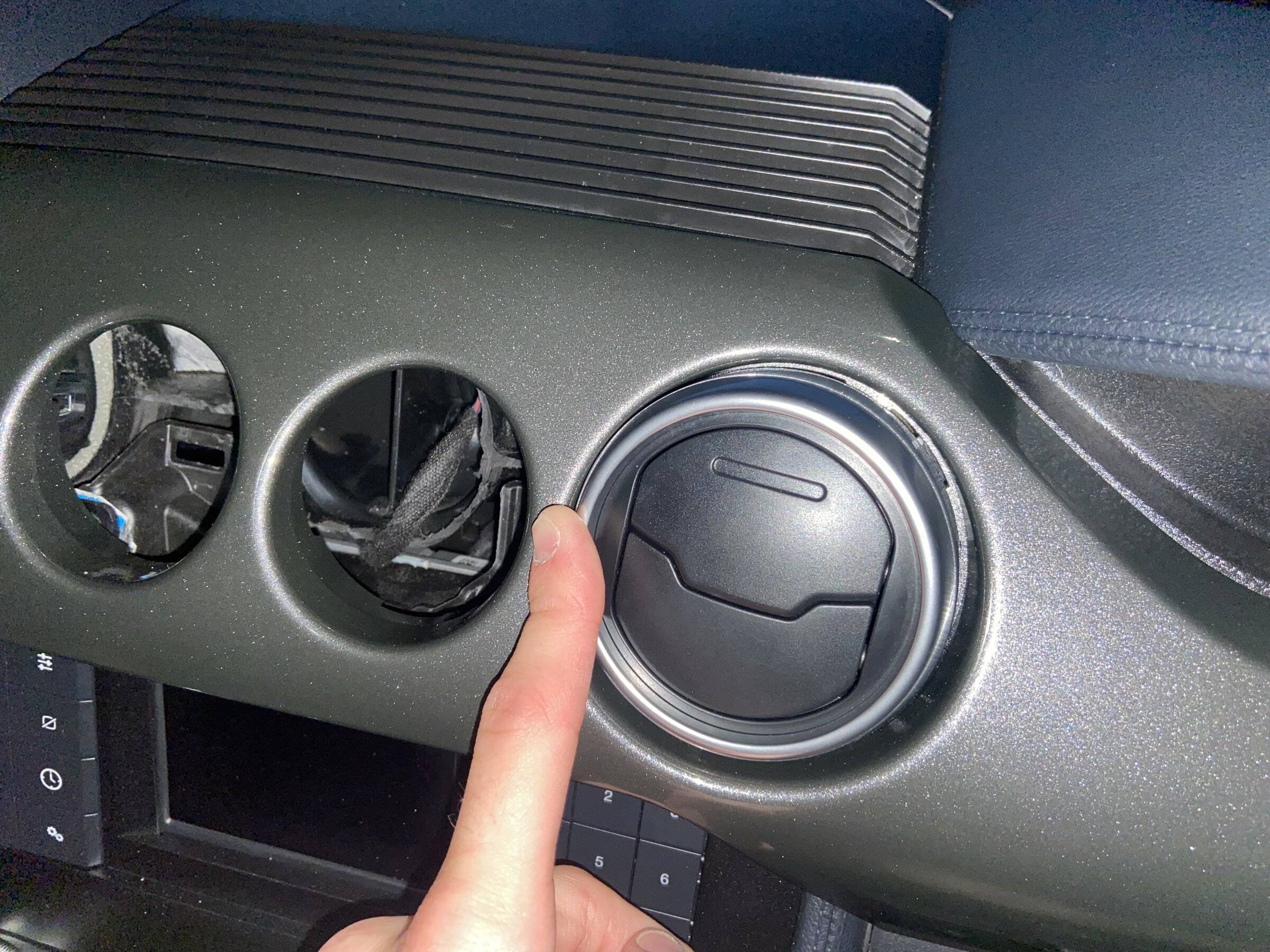

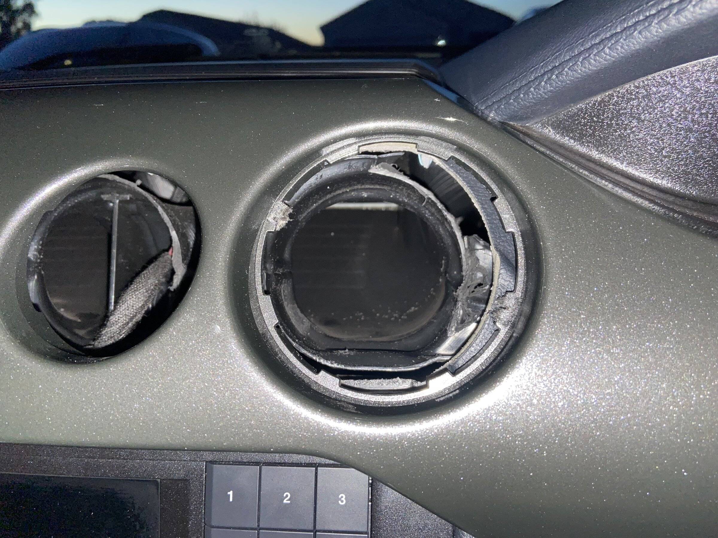

Desperate for assistance. Panel clips in everywhere as it should. Flush with the rest of the dash, no obvious gaps or anything. I cannot for the life of me get the passenger side air vent pushed/clipped into the trim panel. It’s as if the back of the vent is butting up against the A/C duct work? This doesn’t seem “plug and play” anymore. I even hacked up that part of the duct to see if it would help. Still struggling.

If you’re doing a swap where there was a vent in the middle and you switched to the gauges you will have to modify the backside of the vent. I had to cut the backside and angle it until it fit. It’s trial and error. I bought several vents on eBay so I could cut and test fit. Pain in the ass.

Mine was off like yours but was able to force the vents in without having to cut anything.
