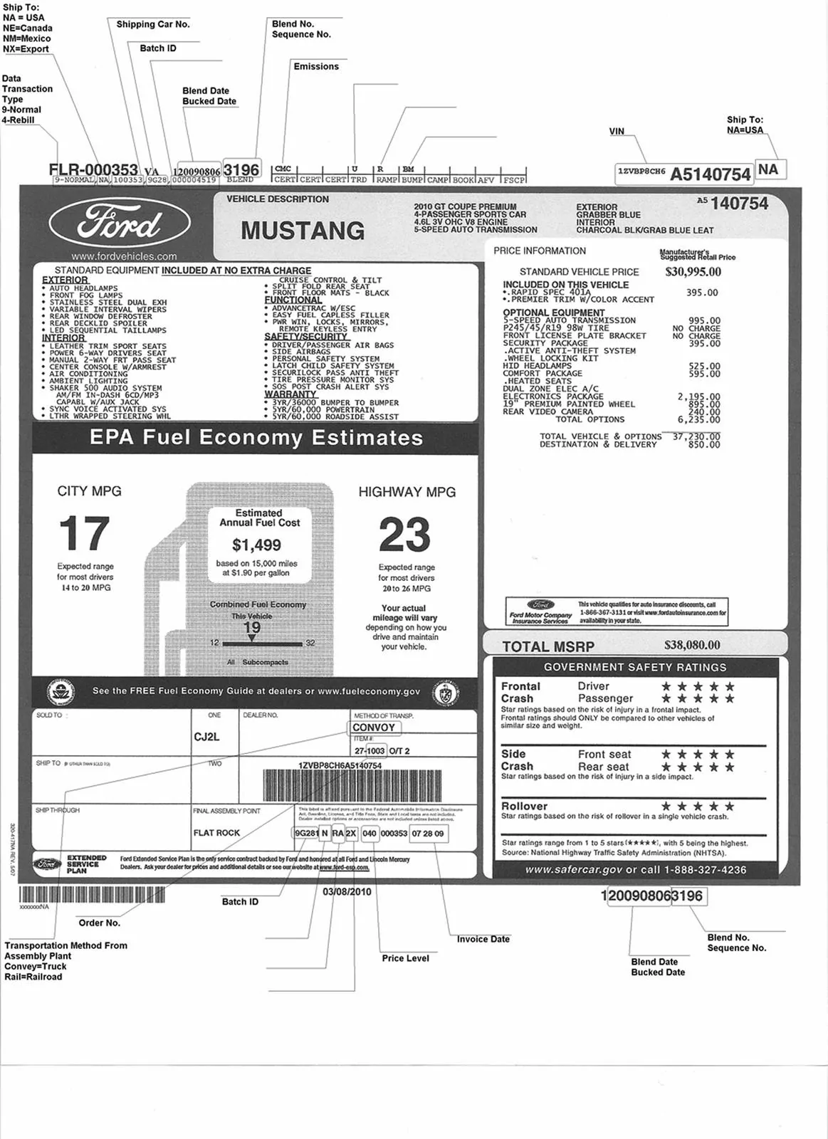

So far this is what we have :
Batch ID - is also, or is actually the invoice date. 9G28 decodes to:
'9' -> last digit of the year -> 2009 : note 'A' -> 2010, 'B' -> 2011, etc.
'G' -> 7th letter of the alphabet -> 7th month -> July
'28' -> day of the month
thus July 28, 2009
The Batch ID down below is similar, but with a '1' affixed on the end.
'Shipping Car No.' is actually the invoice sequence number from that batch of invoices made that day. It appears in three places: after "FLR" (which means Flat Rock), the '100353' in small print at the to, and '000353' before the invoice date down below.
"VA" after "FLR-000353" is Virginia.
Down below, the Order number '1003' is correct, and is preceded by '27', which is the zone district number.
'O/T' means "Order type" - '1' = retail, '2' = stock. There are also a bunch of letter codes for internally invoiced cars. I don't know the meaning of those ones, yet.
'N' after '9G281' is 'Normal', and 'R' would be 'Rebill', the data transaction type
