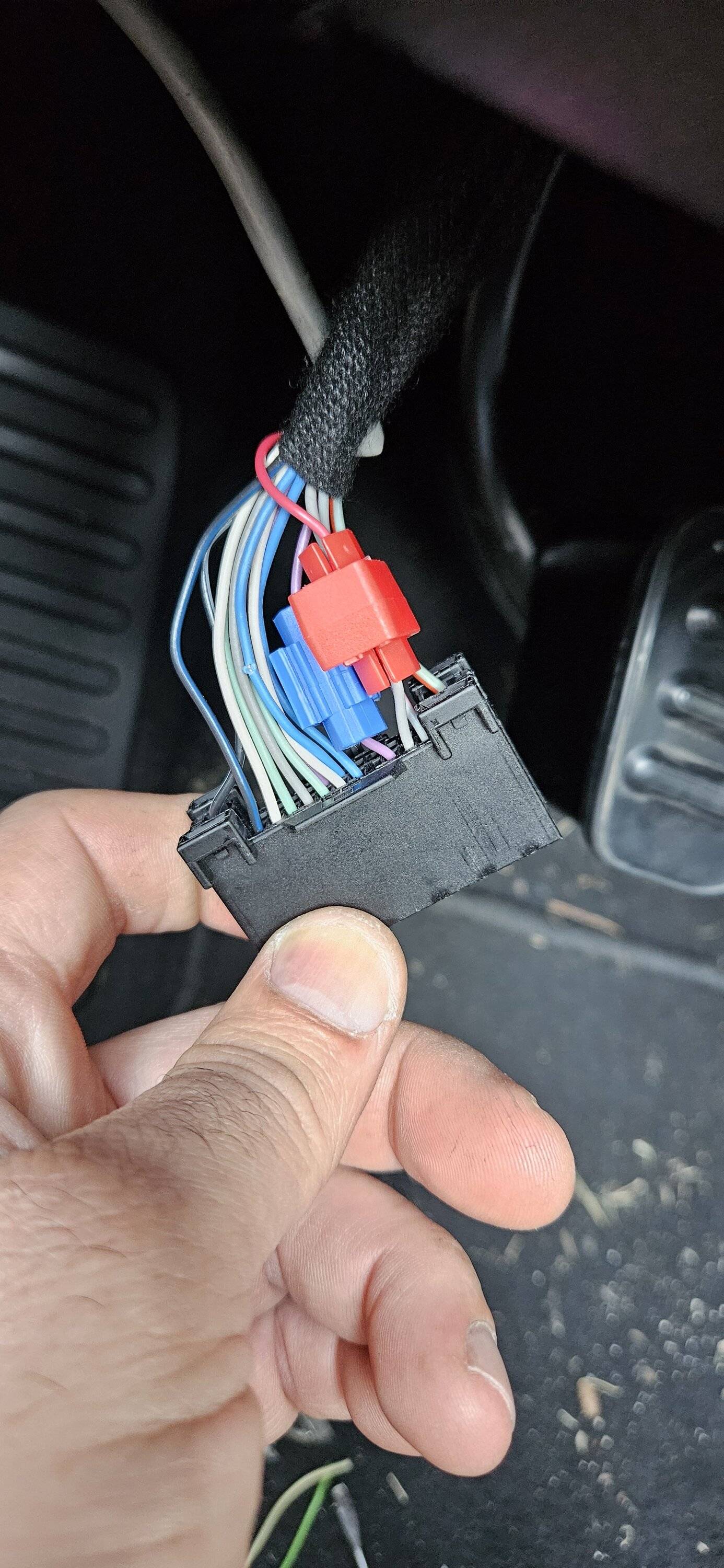

Wanted to add this. To anyone installing 2018 + seats in a 2021, 300a car, and looking for OB2 plug with corresponding can bus + & - . As for what
EricV2003 mentioned, I can confirm all the wiring is accurate on 2018+ cars and seats. Only need to jump the power and ground and wire up the harness for passenger seat wires. This is a picture of my OBD harness plug with test jumpers before I solder the conections.
