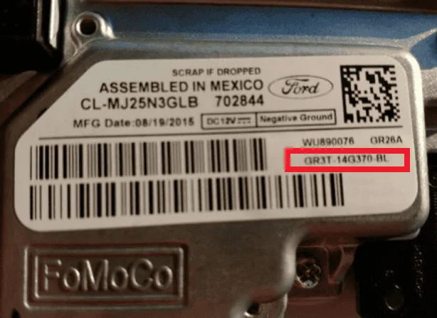

I will check it this evening.What the engineering number on the APIM?

Which one is the engineering number?Can you still post the engineering number? I'm keeping a file of all these numbers for my massive Sync 3 post.
Thanks! Mine is the same number as yours. GR3T-14G370-BMAh, sorry to hear that. Looks like we're in the same boat. I'm still trying to resolve my own "mixup" with the salvage yard. Note that if you plan to use CarPlay/Android Auto, you won't really need nav.
I think Hextall is referring to this part number on the APIM.. mine reads: GR3T-14G370-BL. (see attachment)

Which number is the engineering number? This is my Sync 3 APIM, non-nav.Numbers on parts are usually engineering numbers. A part may have a different engineering number even though it's has the same part number. These are more accurate so I'm keeping a database
