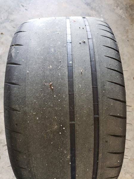

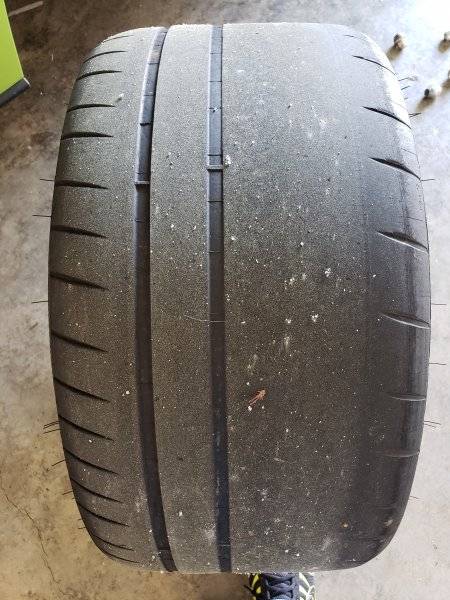

Not sure if there's different compounds between the Shelby's and the PP2's. I got 3200 miles on my PP2 rears with very easy street driving, I was trying to make the set last 1 year before swapping them out. I've heard stories of ppl getting 12-15K miles so that's what I was expecting. I picked up a huge bolt in my left rear, at that time the outside groove was completely gone. My fronts were fine...I sold the pair to a guy who tracks his Corvette.

3200 miles on the rear with no hard driving, no burnouts. But I have to make several right and left turns at intersections to leave my neighborhood and I can always feel the inside tire spinning.

PP2 uses the GT350R’s front tires 305/30/19 on all four corners. So relevant because that is GT350R compound usage.

The outside shoulder of the tire is meant/designed to wear away, so your tires still had life most likely (but your indicator markers seem to be reached—although I hesitate in making that assumption because I’m looking at a picture).
This great article by Billy Johnson mentions this wearing of the shoulder in the link below. GT500s supposedly have tread indicator holes which would be extremely valuable as a way to tell if a tire is still good.
https://motoiq.com/not-all-michelin-cup-2-tires-are-created-the-same/
And Johnson is the Ford test driver on the 350, 500, Ford GT, PP2, Mach 1, and others so it’s literally hearing from the horses mouth.

Ah. That part I did not know. I was surprised when I saw the outer part gone but I was just going to keep driving it like normal and keep an eye on it. But that giant bolt I picked up put a kink in my plans. None of the tires places here would patch it bc of the remaining tread depth but the hole itself was kinda large too.

yah these tires almost require being an expert on it because some shops will immediately assume that they are very worn when they are not. So reading that link and using it as evidence is almost required when you run into tire installers or tire shops who are ignorant of it.

Yah we've all been there. At Les Schwab, the manager who is the only person I let touch my wheels came to me when getting a nail pulled from the PP2. He was at first saying, "we can't work on it because they are so worn." I had to quote that article to show that the tires are made of three different compounds (outside shoulder, center, and inside shoulder), and the outside features are meant to disappear and wear away. It's only based on the indicators which are inboard that can tell us if the tire is worn. Once I showed him that, and then when I showed how the indicators were not reached, he then decided to pull the nail on the tire. I really wish we had those thread holes as that would be the best way to stop this from happening. But I assume it is too much for Ford to get Michelin to go back and add that to the tire mold, so the best bet to avoid having to prematurely replace tires, is to be armed with information to prove that they are still in good condition when questioned.
