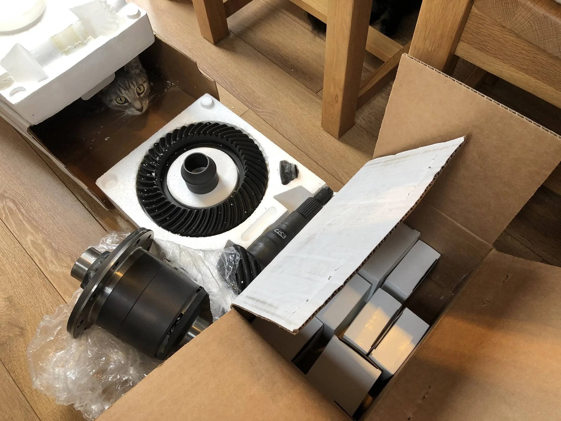

My new toys have arrived :sunglasses: :
Looks like they’ve got approval from Jess and Jasmine ... :crackup:
WD :like:
I love that picture! Cats love hot rod parts I guess!

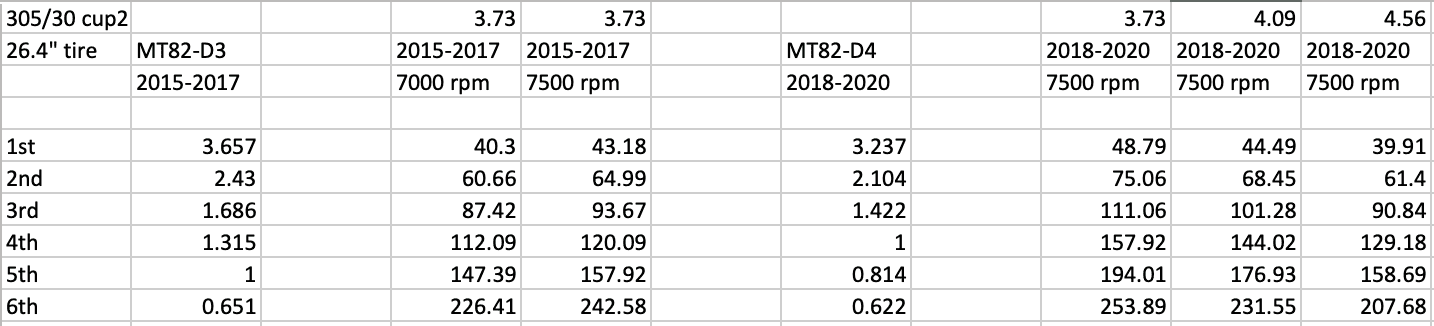

Great thread!
It's crazy that even equipped with 4.09 the 18-20 cars gears are still slightly taller than a 15-17 with 3.73.
Looks to me that 4.09 is a must-do mod on 18-20 for a fun street car.
FWIW here's a chart comparing 15-17 cars with 18-20 cars with 3.73, 4.09 and 4.56.
Showing top speed in each gear at max rev. Included 15-17 at 7500rpm also for comparison's sake even though they don't rev that high. Tire sized used is a PP2's 305/30/19.
