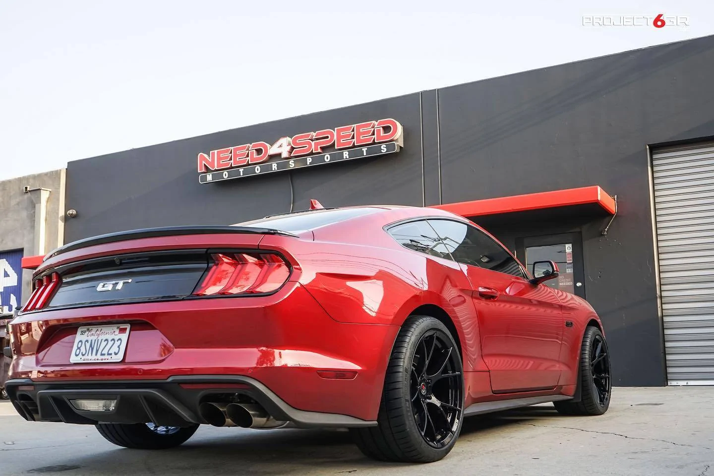

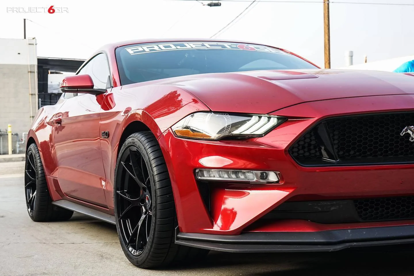

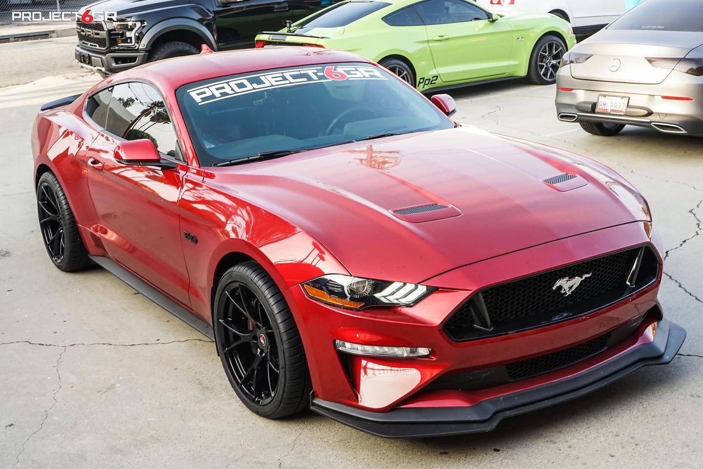

You can run our R spec setup 19x11 19x11.5 and will fit those tires perfectly, but front will poke at least 1/4 of an inch on each side as it is very aggressive.

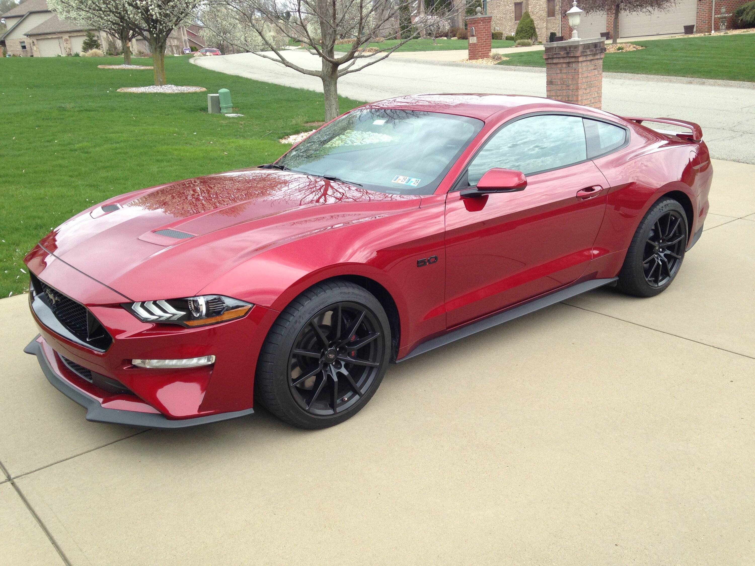

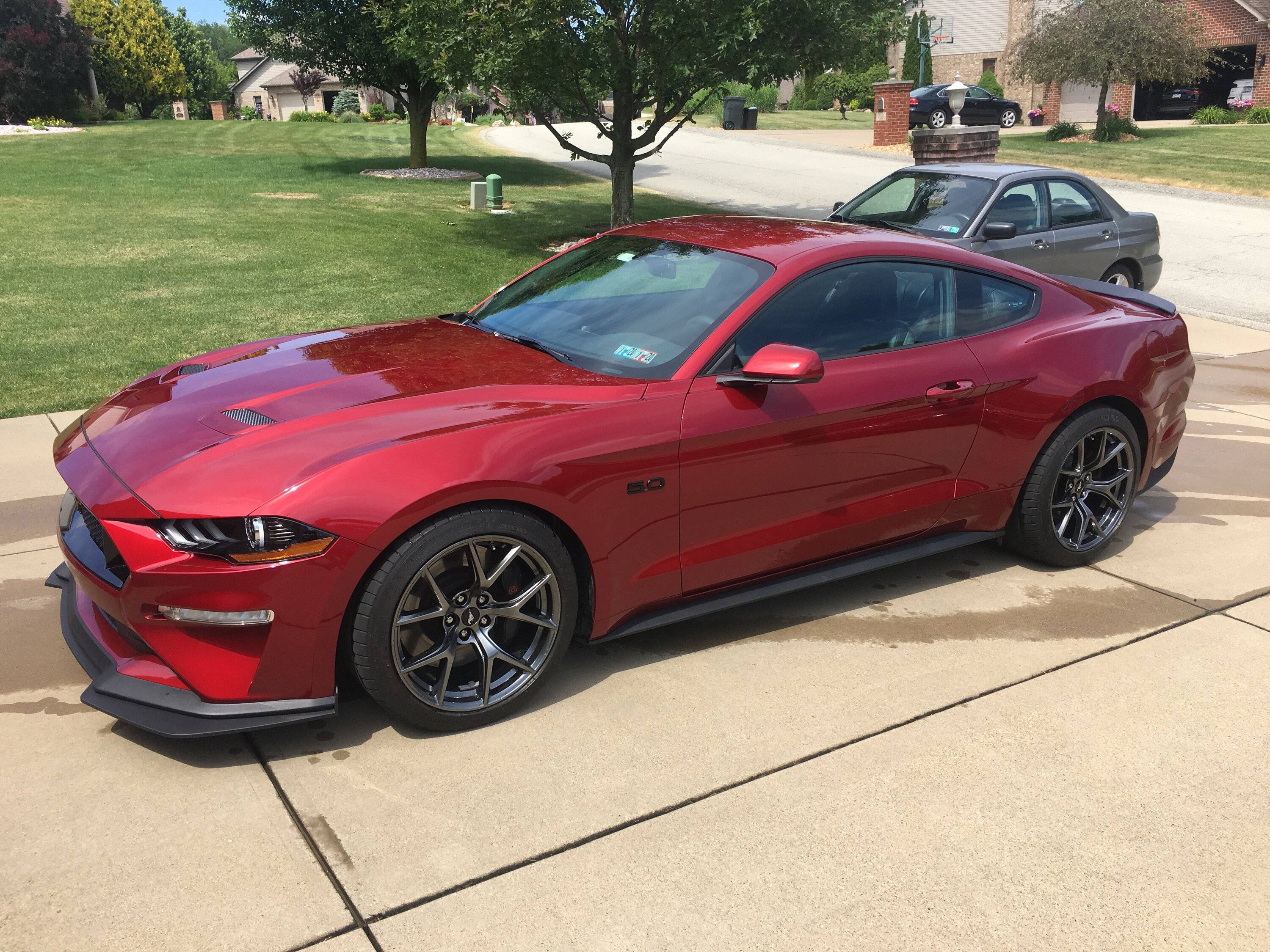

You can run stock GT350, Mach 1 handling package, or PP2 wheels front and rear. 305/30-19's will fit 10.5" fronts, and 325's will fit 11" rears:
PP2 wheels are 19 x 10.5 +24 front, 19 x 11 +48 rear, 305/30-19 square.
Mach HP wheels are 19 x 10.5 +24 front, 19 x 11 +52 rear, 305/30-19 and 315/30-19.
GT350 wheels are 19 x 10.5 +30 front, 19 x 11 +62 rear, 295/35-19 and 305/35-19.
I ran both PP2 and GT350 stock wheels and tires on my 2018 GT PP1 using the stock lugs with no fitment issues.
You can buy new black PP2 Ford Performance wheels from various dealers. Levittown Ford is who I bought from, their price at the time was the best I could find.
https://www.levittownfordparts.com/...MI0YXx7dyUgQMV2fLICh2QtgcTEAQYAiABEgKN-fD_BwE
These stock wheels are relatively heavy but if you want to run 305's front, lighter options are very expensive.
In the pics below the car is stock with the GT350 wheels, and lowered about 1/2" with the PP2 wheels.
