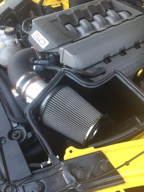

I bought a used 2015 Mustang GT Premium 6MT back in July, and so far I love the car! When I bought it from a dealer, the CAI was already installed as well as a custom Ford Racing by Borla exhaust. I'm just wondering if you can help me identify the CAI, as well as whether or not it requires a tune... Just trying to narrow down exactly what mods the car has on it.
http://imgur.com/xnlpnDq

Looks like the Steeda.

you need to take it apart and see if the restrictor is in there, if it is, you are good without a tune, if not, you need a tune asap or put the stock boxback in

Yes, that appears to be our Steeda unit - either the car has a tune on it with the Steeda CAI or the restrictor is on & there is no tune required.
Best way to check is like the aforementioned, see if the restrictor is installed.

Thank you very much for the info! Great vendors indeed!!
