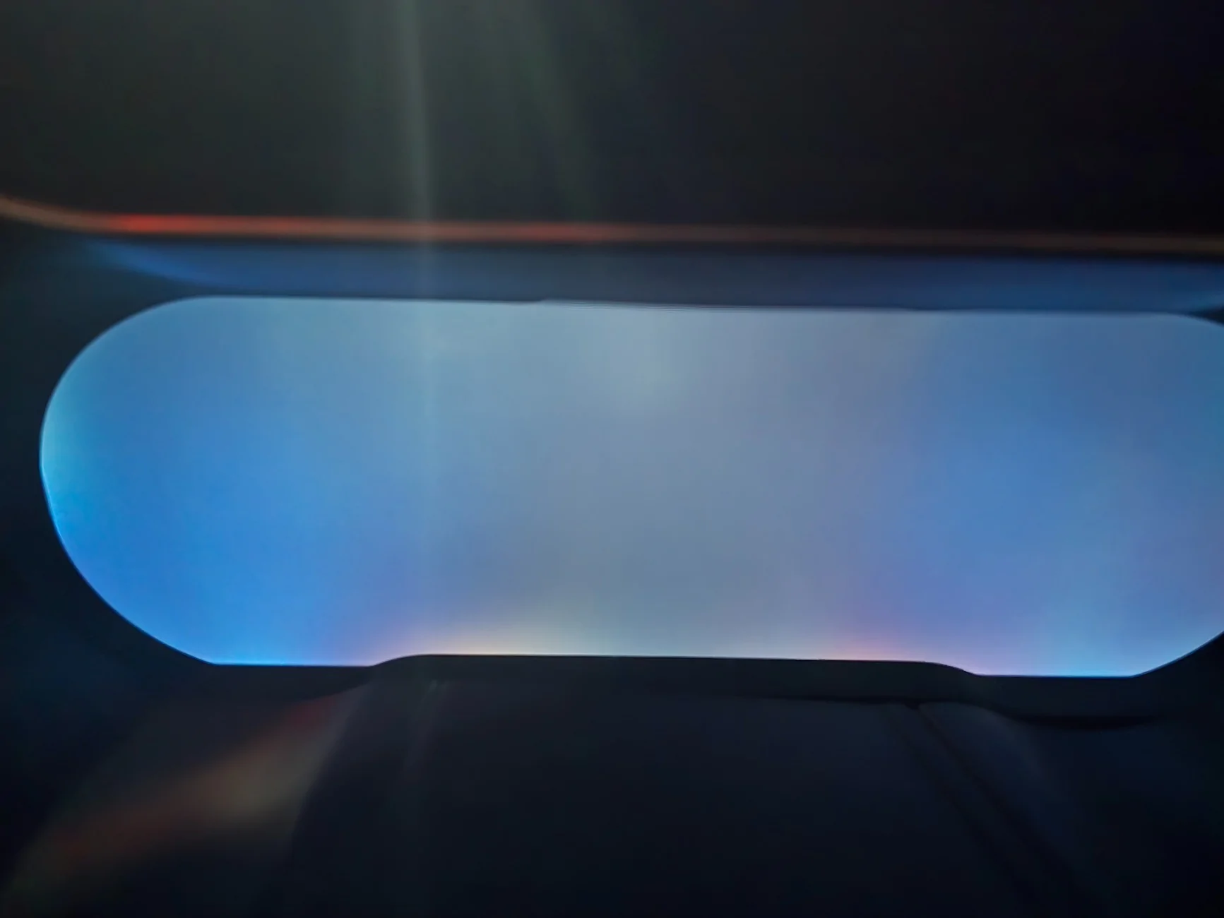

I need help with my 2018 Mustang. Here is the situation:
Vehicle: 2018 Ford Mustang.
Modifications: I installed Sync 3.4 using CyanLabs.
Problem: A few weeks after the update, my Digital IPC went black.
Current state:
The screen has backlight (it glows).
The sound is OK (chimes and turn signals work).
Very rarely, I can see the kilometers (km) on the screen, but I never see the needles or the rest of the gauges.
Firmware versions currently installed:
F111 (SBL): JR3T-14F094-JA
F188 (Strategy): JR3T-14C026-LC
F120 (Strategy): JR3T-14C026-MA
F124 (Graphics): JR3T-14C088-LB
F125 (Graphics): JR3T-14C088-MB
I have already tried to reinstall these firmwares with FORScan, but the screen is still black.
How can I repair the IPC in your opinion?
Thank you
