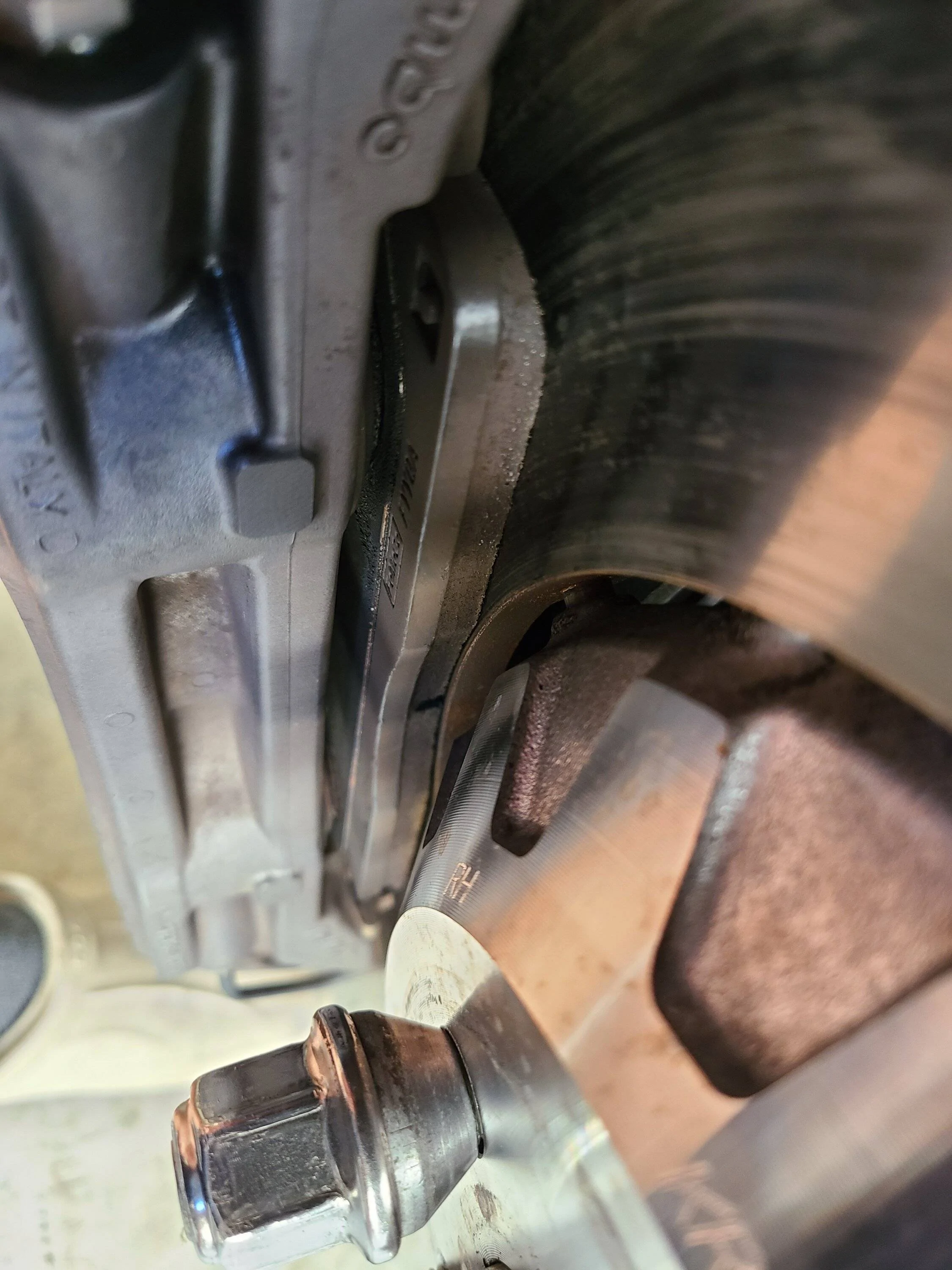

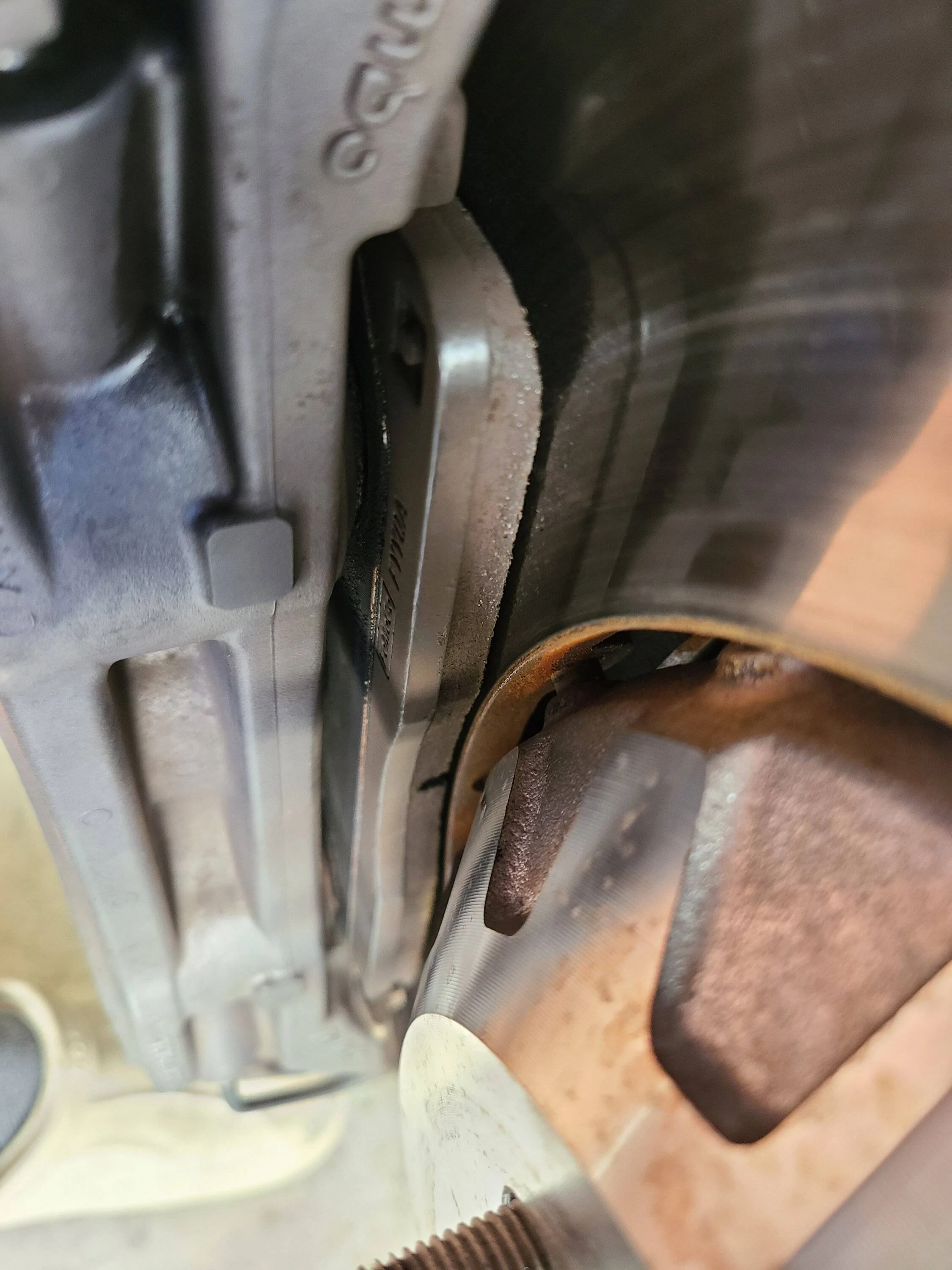

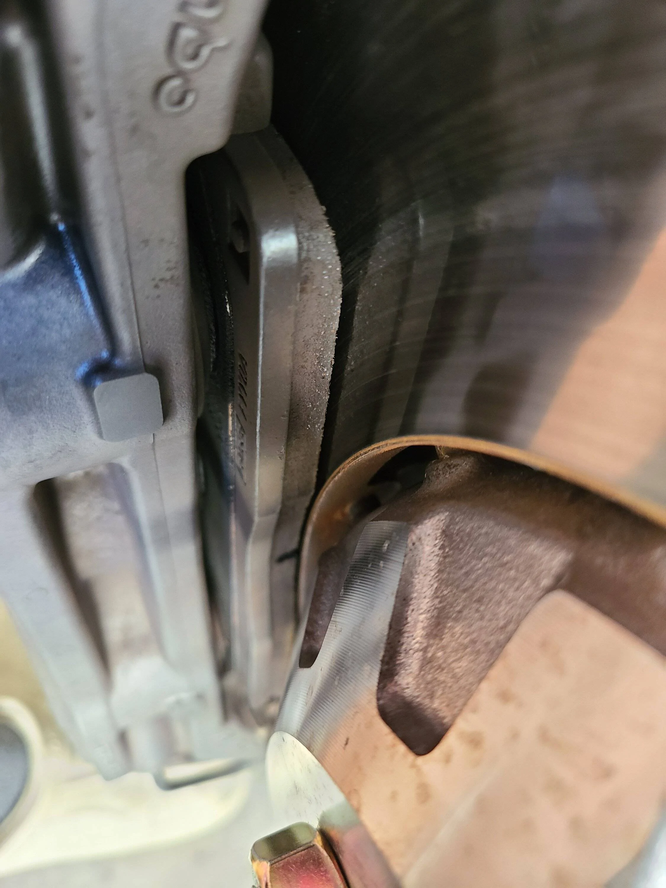

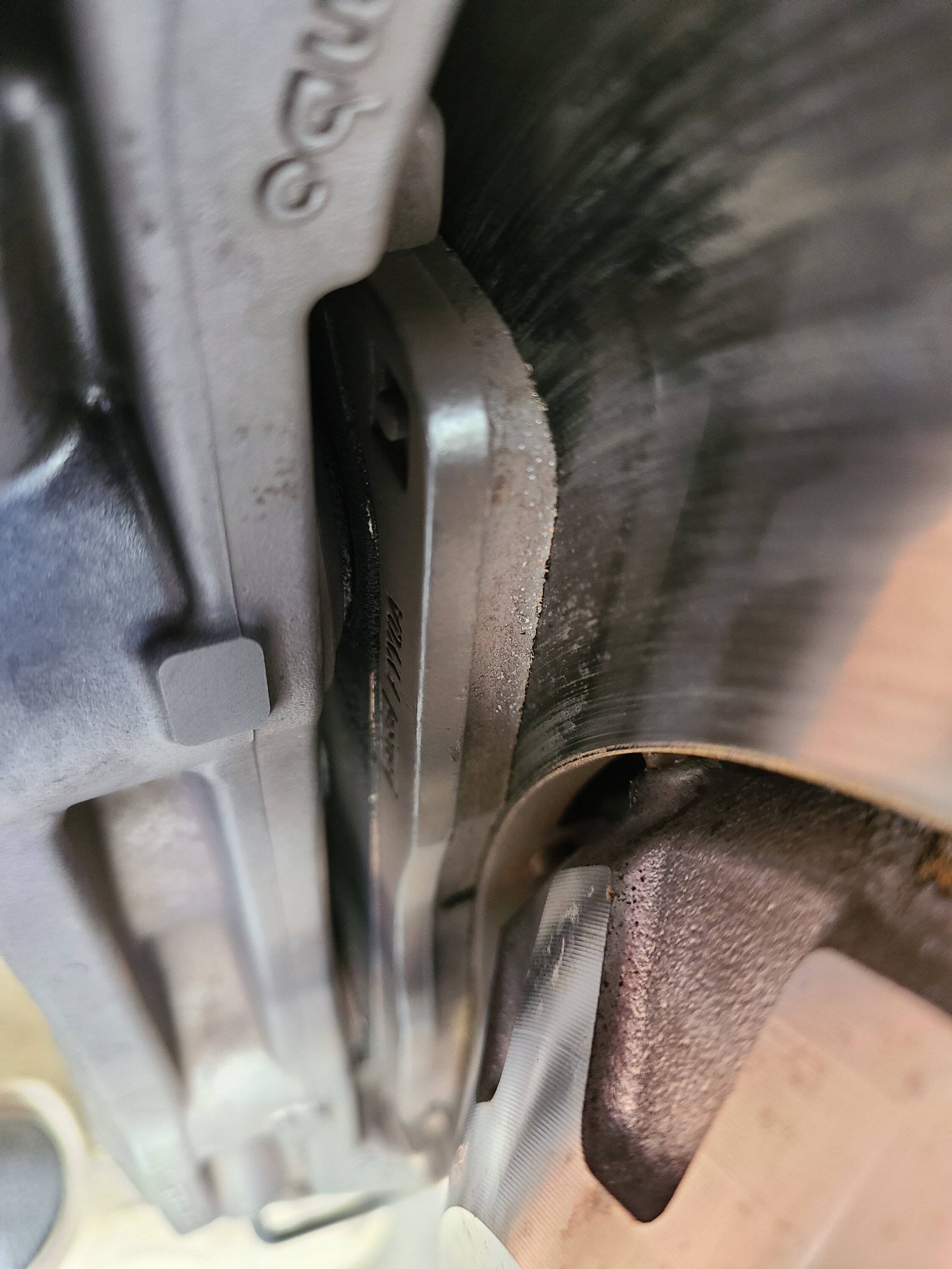

Well now I can say that I have. My RH non-drilled rotor is a few mm out of round. I installed these rotors prior to my last track day and immediately noticed that the RH side front wheel was not spinning as freely as the LH side and seemed to be catching at a specific point. I had no time to swap them back for my old rotors so I finished the track day without incident (other than a slow speed squeak from the RH side when braking gently). I looked more closely today and could see that the RH rotor is out of round and at a specific point catches the brake pad. See pictures below for reference. I installed my old drilled rotors and this no longer happens. Has anyone had any experience with getting Motorcraft parts replaced under their 2 year warranty? I bought it from an online parts place that does not take returns but I can see on the shipping label they bought them from a Ford dealership.
