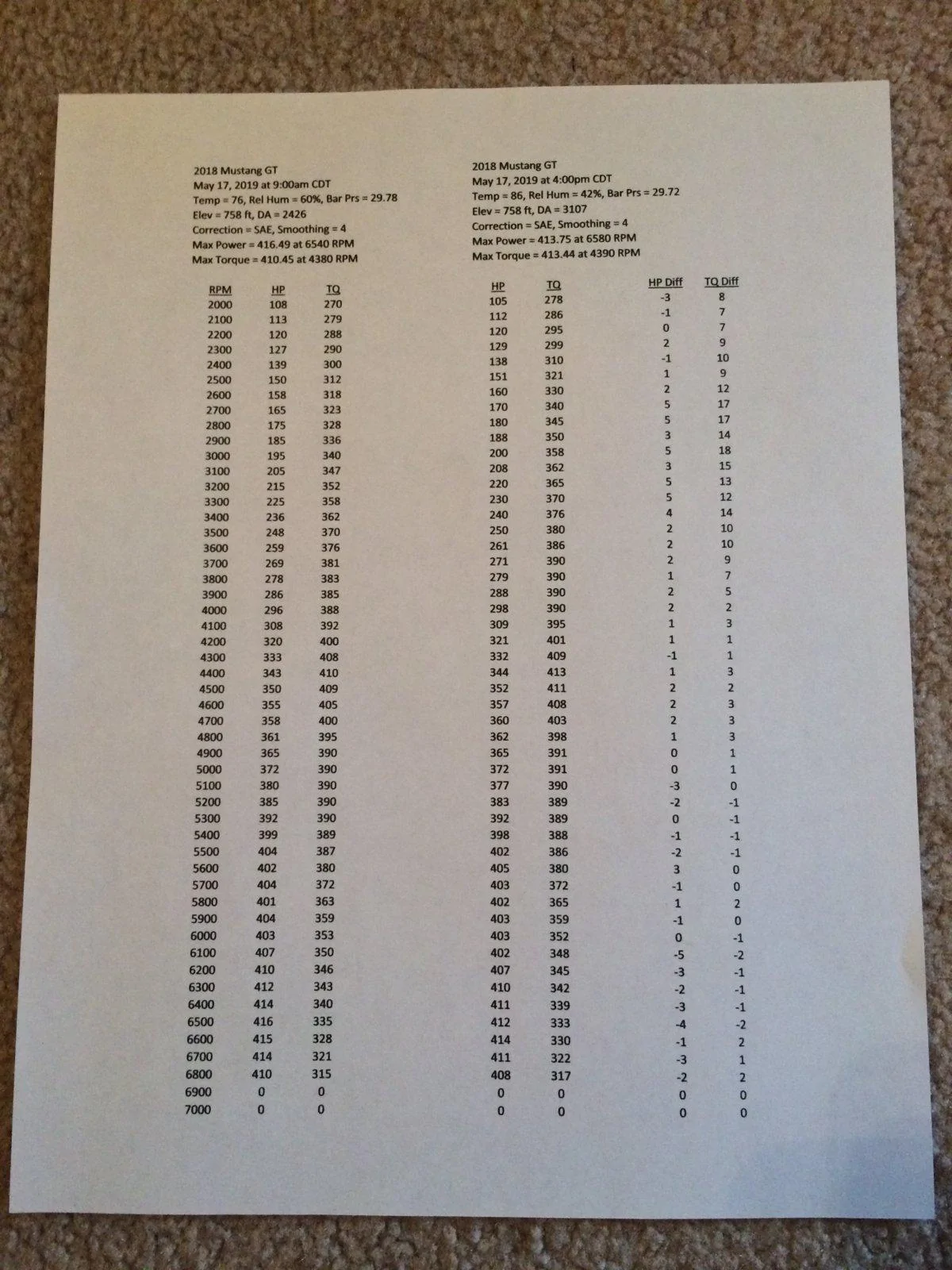

Well, finally got my Steeda H-pipe installed. I did two dyno pulls before and after just to see if there is any noticeable difference in HP/TQ. As I suspected, there wasn't really any noticeable gains/losses overall, but what was interesting, is the shift in the torque curve down low up to about 3800 rpm. I saw gains in this range from about 10-18 lb-ft. This was a same day, same dyno test, and I think shows a big enough difference to be more than just tolerable error. It was kind of what I was expecting, but maybe not quite that much. It may have cost me a few HP up top, but not really much if any.
BTW, the H-pipe really wakes up the active exhaust. To me, it's noticeably louder, and makes more difference between the normal/sport/track settings. Track is pretty damn loud now. Sport is perfect and still my favorite setting.
Edit: Since my car is stock, fuel shut off at about 6800 rpm when it hit the 155 mph limiter in 4th.

I remember within 5 is about the same as margin of error. So even if you assume every change +/-5 is just margin of error that is still a 4WTQ to 13WTQ bump from 2K to 3800RPM. That's impressive. Also the fact that it's about 10* hotter on the 2nd runs.

Impressive torque gain. Looks to be more than just the margin of error. I don't know why there would be any real HP loss at high rpm. The H pipe has to flow at least as well as the resonator at high speed. It doesn't seen logical that the resonator would add scavenging effect more than the H pipe.

DA was quite a bit higher with the afternoon pulls. Depending on correction, that's probably the main reason for any drop. It's negligible at best. Pretty consistent between the pulls though. Morning (pre H-pipe) 416/410 and 415/410. Afternoon (post H-pipe) 414/412 and 409/413. I had just driven about 75 miles at 80-85 with A/C on prior to the afternoon pulls, so it may have been a little more heat soaked too.
